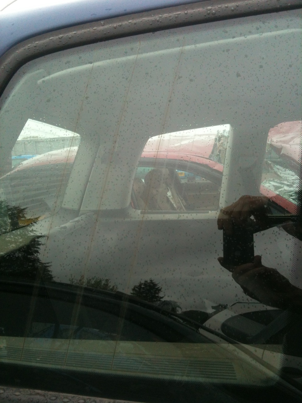

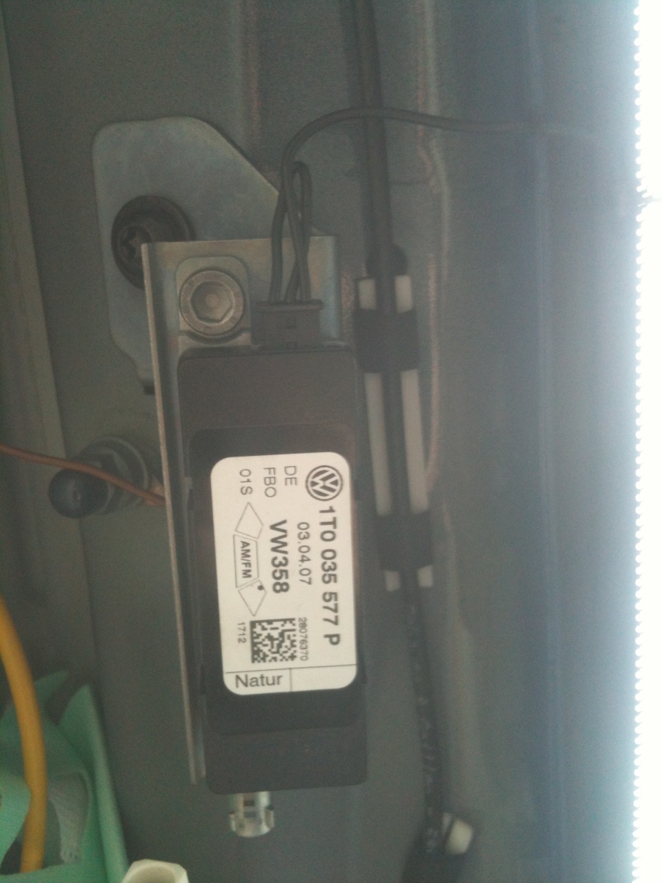

Was down the scrap yard today stealing bits from a Touran (of all cars) and noticed that it had no roof mounted aerial!
Closer inspection showed a side window aerial with part number 1T0 035 577 P.
A physically larger part than the Skoda one Josi listed, but what was interesting was that the lines on the window were basically 'drawn on', just like the rear window demister. The aerial amp connected to the lines by a short wire and then straight to the radio via a FAKRA (white) aerial lead.
Now I'm thinking of stealing the aerial amp (and cables) and drawing an aerial on the rear side window of my Octavia Estate using something like this Grenville stuff from Halfords and wiring the amp direct to this.

So I've been investigating the possibility of retrofitting an aerial to the rear side window using a VW Touran aerial amp which I am hoping to pick up from the scrap yard today. As far as I can see, this Touran only has one aerial - the window one.
Will update once I have it and have tried it out...

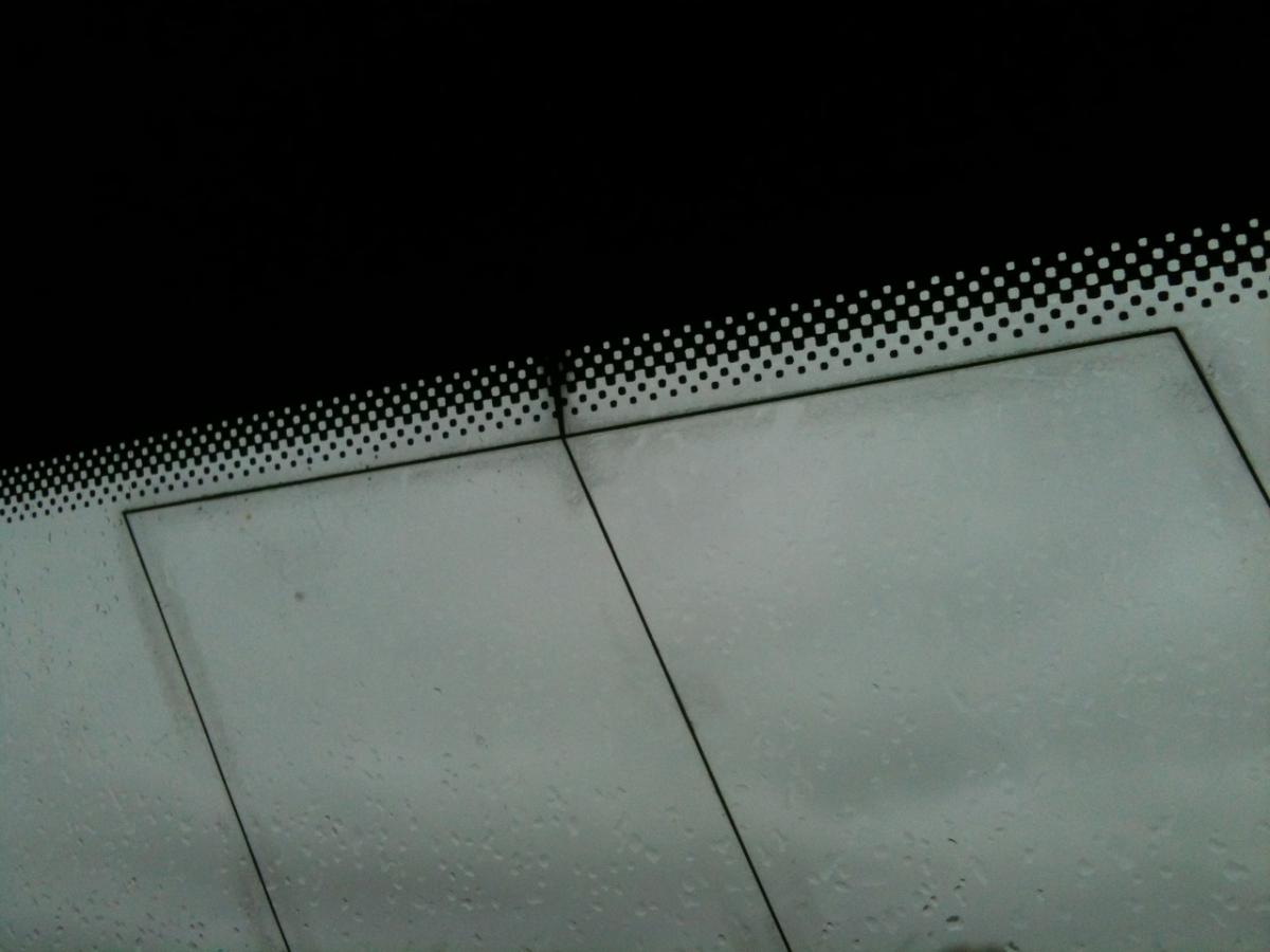

The Touran did indeed have two aerials as Josi said. I now have both - for a good price (if they work). The FM one had a white FAKRA connector, while the AM/FM one had a 'Natur' (brown / beige) connector. Now I'm even more confused as there does not appear to be a 'standard' colour for FAKRA useage in motor vehicles...
The actual aerials were identical and consisted of three near vertical lines
joined together with a horizontal line at the top
to which the aerial amp was soldered.
Does look rather easy to replicate in principle - will have to see once I have the OPS instal completed.

Found this article and wondered if it would work considering the aerial cables in VAG cars carry power to the aerial?
Would it be possible to wire the aerial amp (1T0 035 577 P or the corresponding FM only version) to the demister and a standard VAG aerial cable to the amp?
