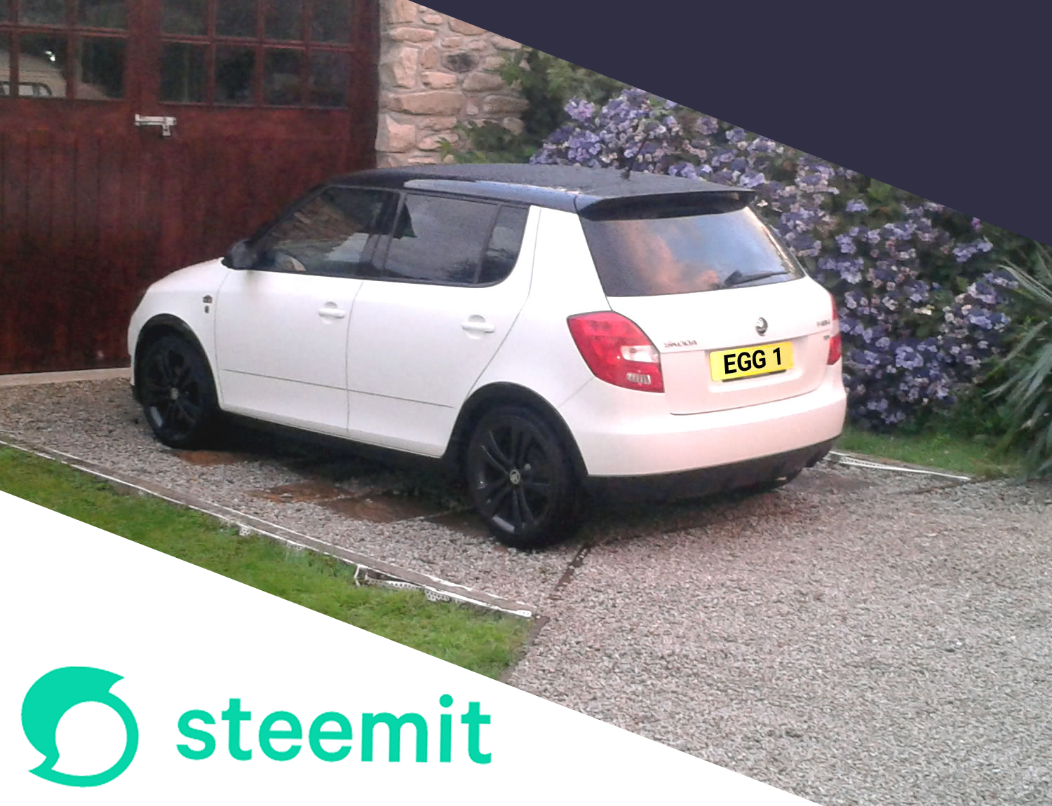

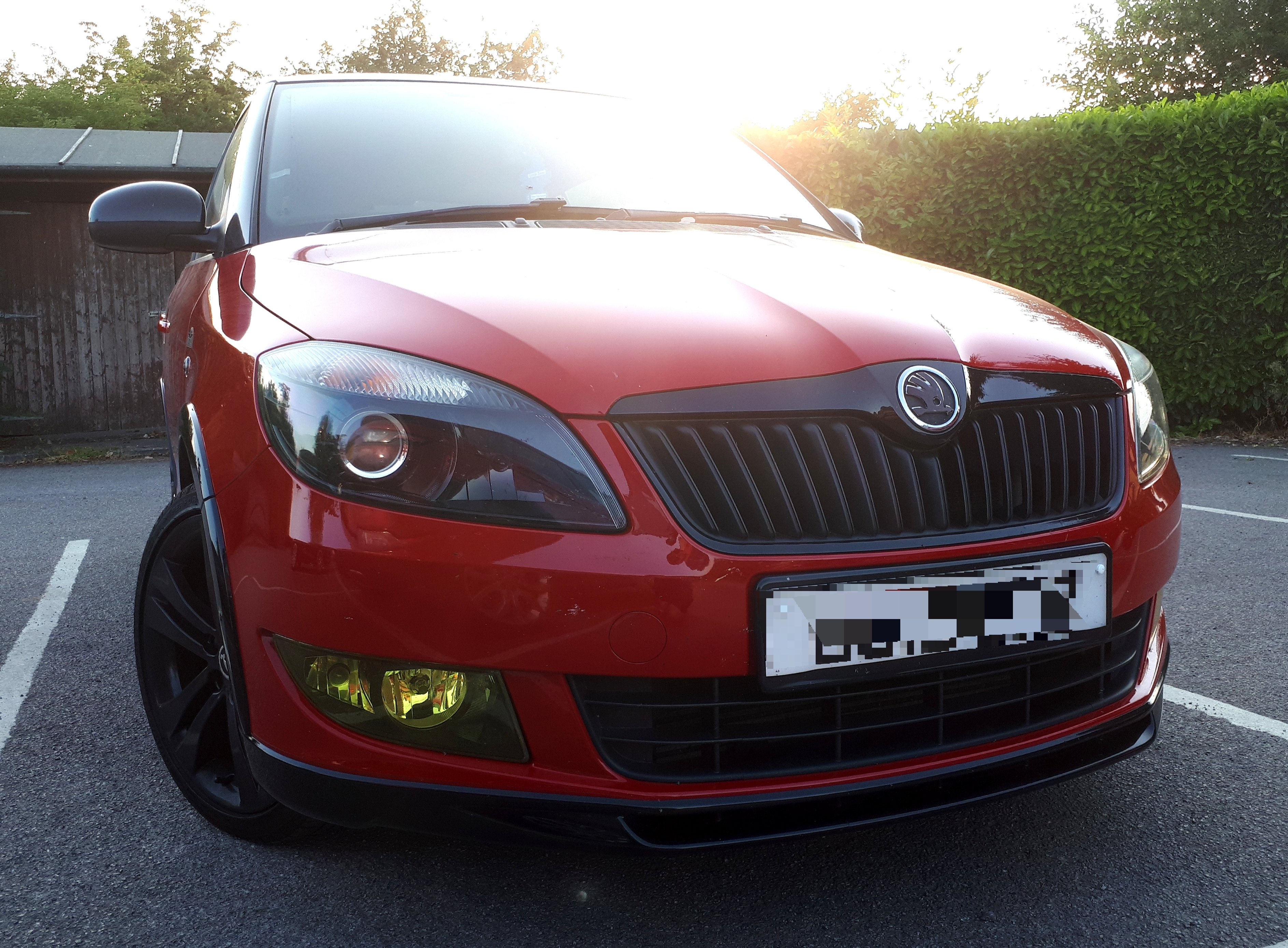

White 2013 TDi 105
54,000 miles
Bluespark Automotive Pro + Boost tuning box [claimed 135ps - 297Nm on max settings]
K&N high flow cotton panel air filter
DIY de-restricted intake charge snorkel
DIY reflective heat covering to intake charge pipe
DIY stealth water/methanol injection system [failed/removed project]
rear wiper delete [thanks to killallwipers kit]
'needle-sweep' activated and other settings altered thanks to a Carista OBD2 module + android app.
Stock interior, brakes, suspension & wheels, etc.
Edited by EggMeister
added an image
what happened with the meth injection
Hi AMD87, the project was fighting me all the way through. I tried to be clever and cheap and neither worked :( With more time and money I could have ironed it all out but after 6 months I had lost interest. I've still got all the gear so maybe one day............. :)
If you're interested, I did post a lot about this project on steemit, my final post 'early death' has a list of all the previous posts. https://steemit.com/cars/@eggmeister/early-death-stealth-water-methanol-injection-sh2omi-update-18-06-2018
In hindsight I should have taken the boost feed (for boost switch and dash gauge) from a plastic pipe section rather than the rubber hose but I found the rubber hose easiest to work with and modding. Also, I should have ditched the solenoid as the pump has it's own built-in non-return valve on top of the check-valve I had fitted in the feed pipe between windscreen washer pipe and the pump unit. This would have stopped the PVC pipe expanding when not in use.
I'm currently suffering withdrawal symptoms with my loss of extra power potential and now turning my attention to NOS though the wife isn't happy about it. Had a quote from Adrian Flux of 950 quid for road use NOS which is better than LVs +£1400 last year when I first enquired.
I've just had a look at your project and spotted you've done a VRS intake pipe, I didn't realise that was an option available to us TDi owners :) It looks a superior mod to my DIY de-restricted snorkel :) https://steemit.com/cars/@eggmeister/skoda-fabia-more-power-de-restricted-snorkel-modification
Any hoo, cheers for enquiring re: water/meth :)

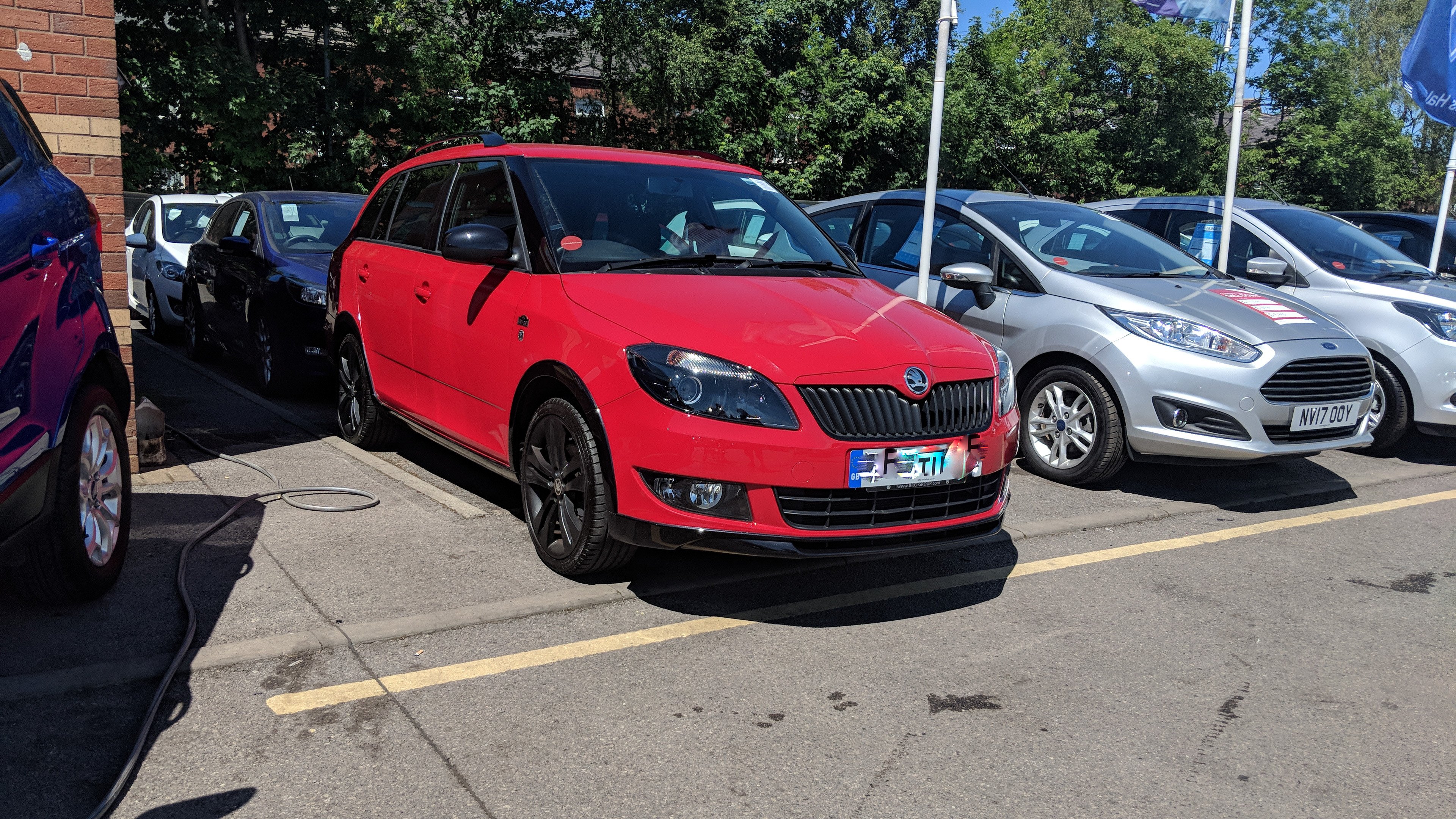

Hey from Manchester. Bought this recently, 64 plate 1.2TSI estate. Such a lovely car. Added some personal touches already, added an auto headlight switch and some LED bulbs :)

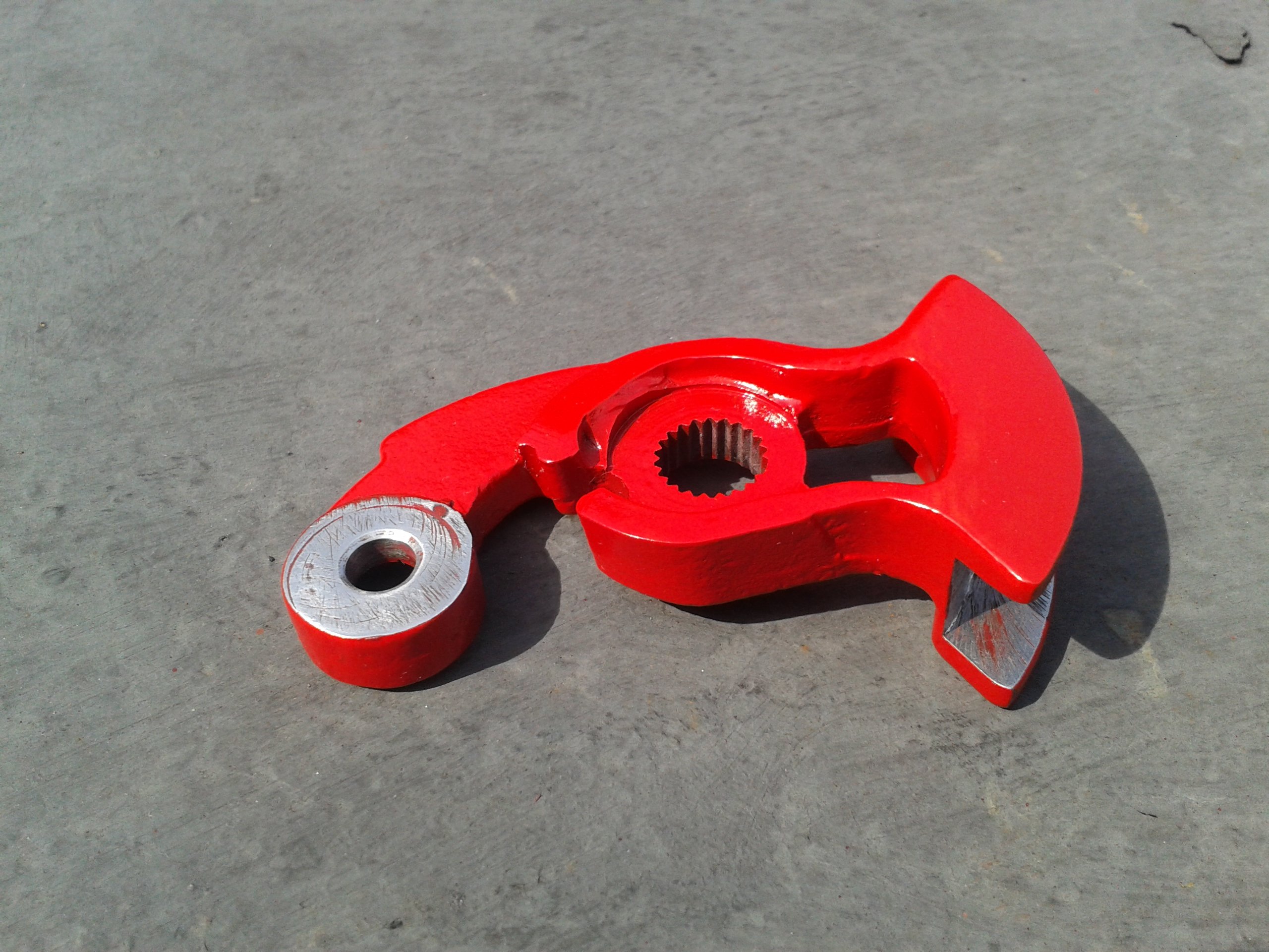

Which short shifter did you go for? Ordered mine from creation Motorsport

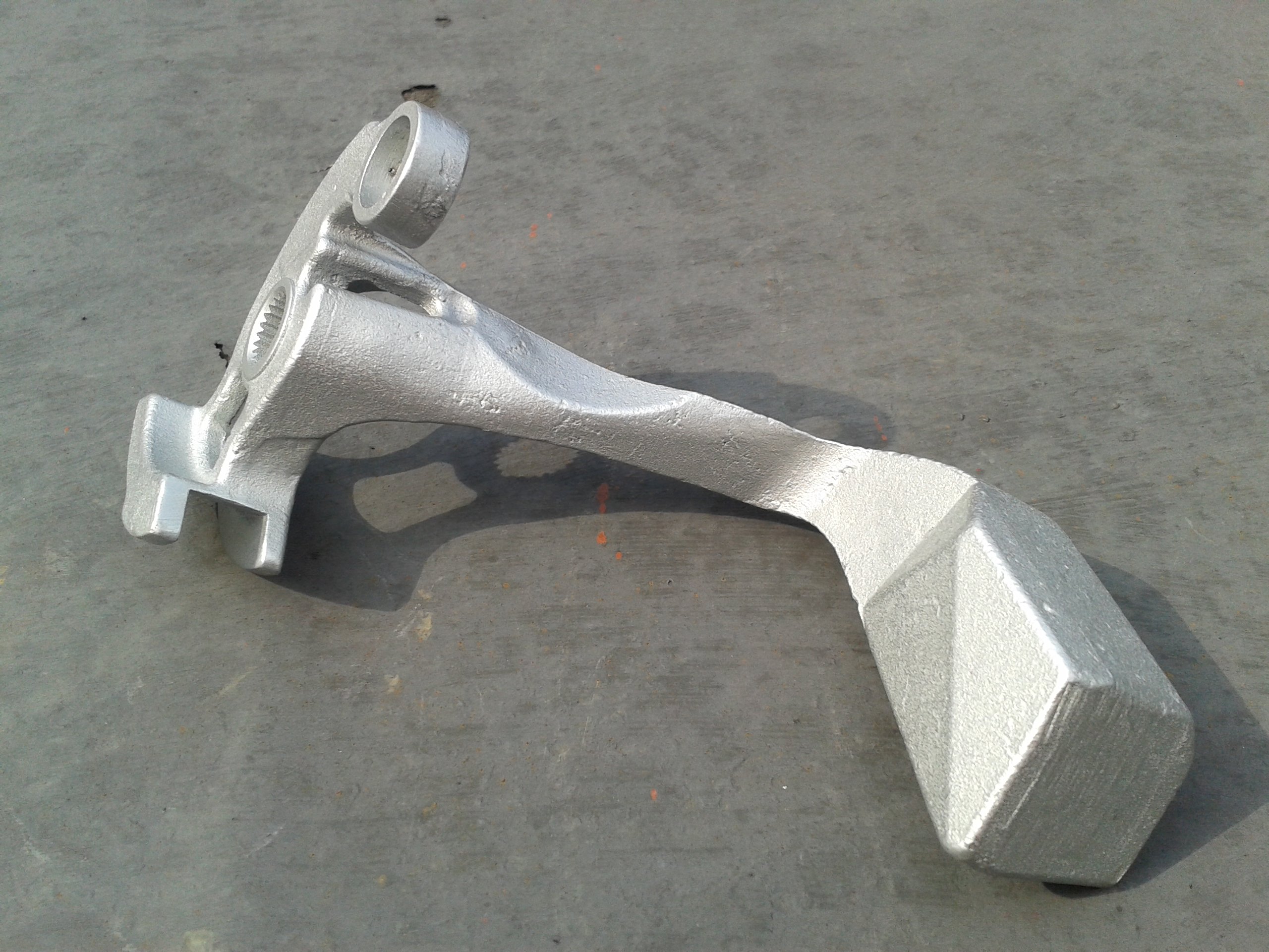

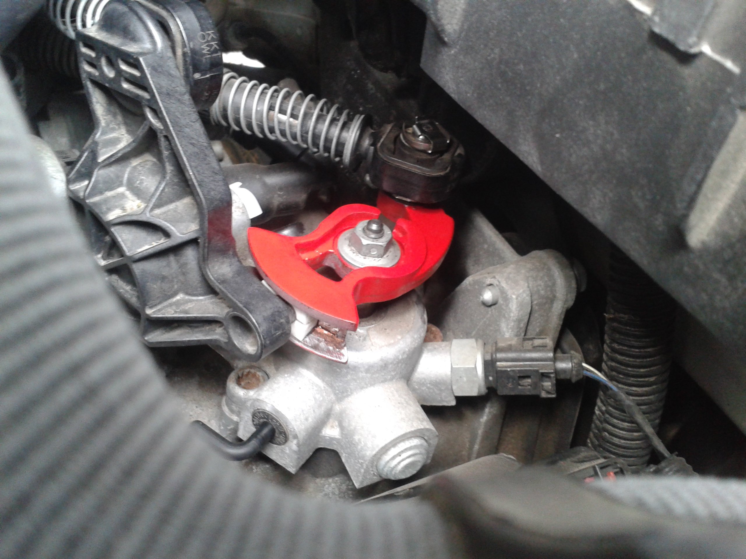

Hi, I wish I'd ordered the same Kgod1991.
I ordered this off ebay and it arrived yesterday https://www.ebay.co.uk/itm/SKODA-FABIA-OCTAVIA-VRS-1-6TDi-1-8T-1-9TDi-5-SPEED-short-shift-quick-shifter/171560239082?ssPageName=STRK%3AMEBIDX%3AIT&_trksid=p2057872.m2749.l2649
I should have double-checked my car even though this item came up compatible. The counter-weight stalk is far too high and will foul the battery box :(
I see the creation motorsport shifter doesn't have a counter-weight stalk..... Mmm.
Perhaps I could angle grind the stalk off and all will be well ;)
Can't see how grinding it off would harm, but I looked at that same one on eBay and thought the weight looks a little high compared to standard
Don't forget to reset linkages
Hi Kgod1991, All installed and all good :)
I didn't remove filter or battery box, managed fairly ok with them insitu.
Even without the counter-weight, the shifting seems normal. I'd go as far to say that unless you was 'in the know' nobody would detect anything out of the ordinary. It's nice just to have a slightly shorter throw :)
