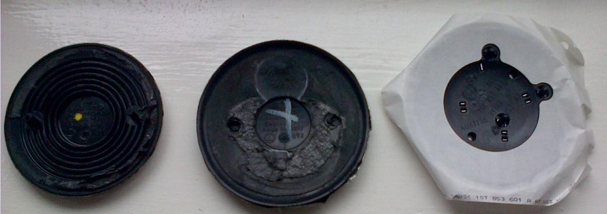

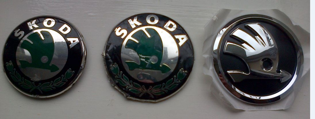

Hi all, just ordered and received the 1ST 853 601A AUL - Front (CitiGo Front) for the front of my Octavia 2006 Estate.
Thanks go to number1forskoda on the bay of E for quick service!
Anyhoo, what a mission to get the front one off. I have done it before on a 2005 Octavia and that was easy but agree with others, the best way is hot water and using dental floss to saw through the sticky pads after destroying the plastic at the rear of the badge.
Trouble is, I have noticed that the pins on the badge do not align up with the holes on the badge holding plate on the grill. I guess this is obvious since this badge was never intended for the Octavia II.
What are peoples methods for ensuring their badge is perfectly aligned and straight?  Cut the pins on the badge, or drill new holes on the chrome surround?
Perhaps I've been sent the wrong badge, detailed on the back is 1SR 853 601 A - correct one?

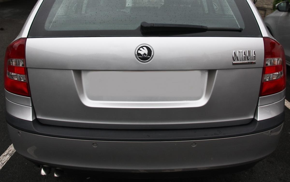

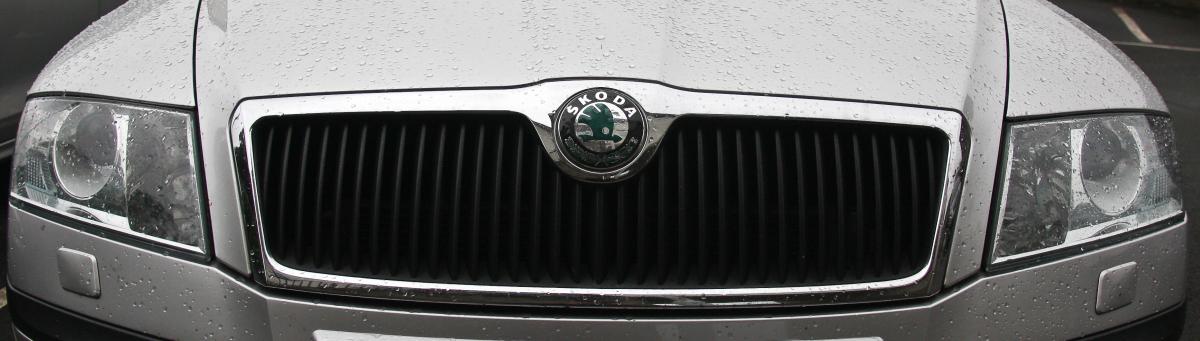

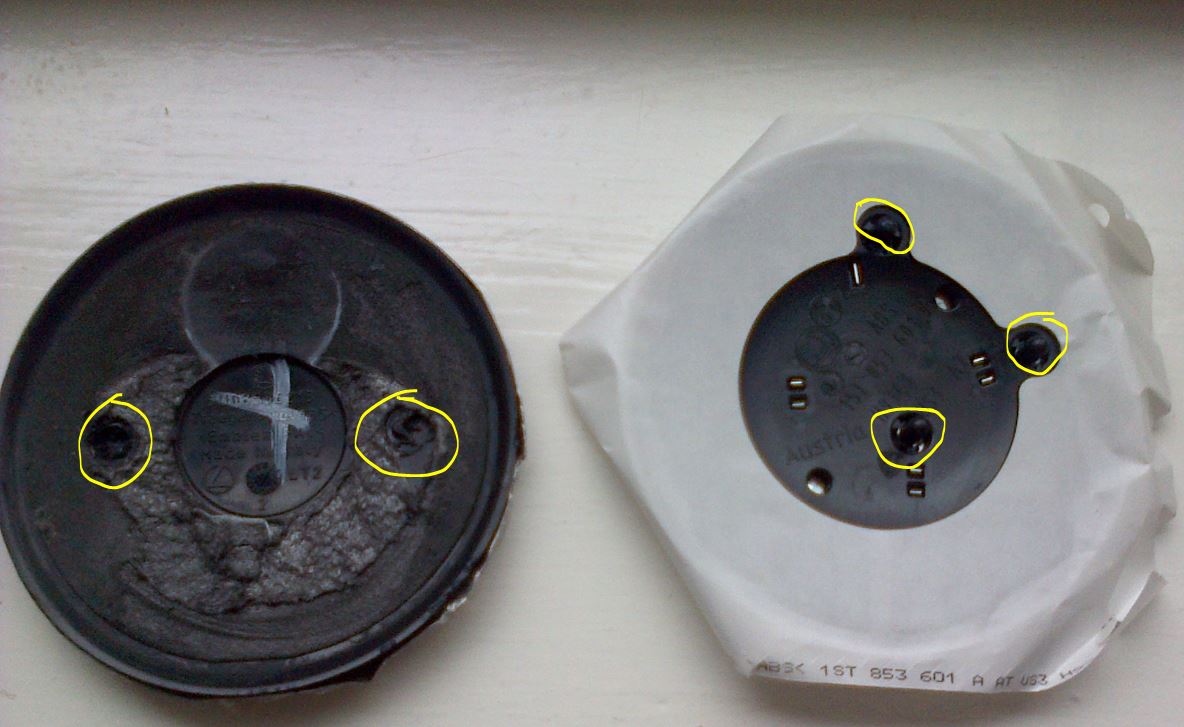

Picture 1 shows the pin locations on the original (left) and the new one (right).
Picture 2 shows all three, orignal boot badge, original front badge and new Skoda badge
Picture 3 shows  the rear of the same, Original boot badge, original front badge and new Skoda badge.
Cheers for any advice.

On new badge you just snap off the extra lug on back I think then it lines up fine with the other 2.
Thanks Zeffania, he confirmed all lugs have to come off.

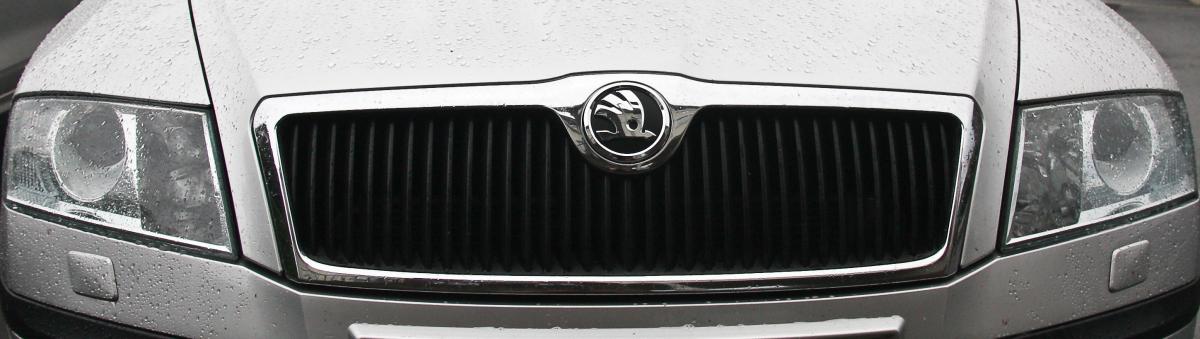

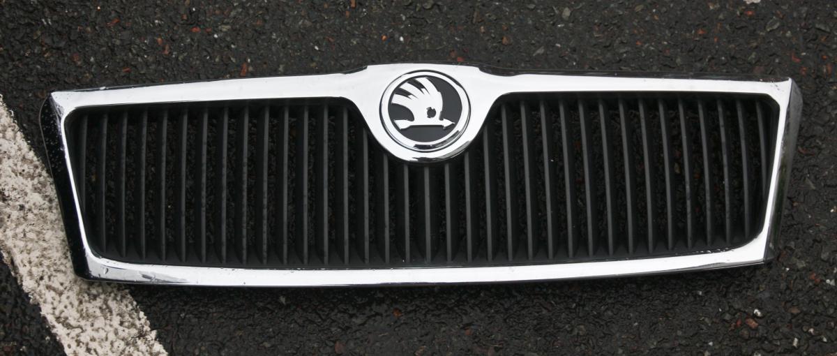

At last, finished!
Thanks for the post thread and help from those who helped!
Grille off before fitting was way better!
Rear badge on order!
Much better, suits silver. Must say your old badge looked in good condition

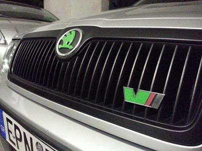

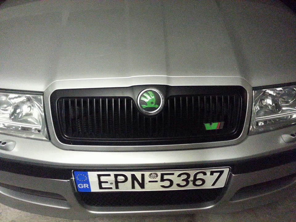

My new modified skoda badge from Greece ;)
Looks nice mate
