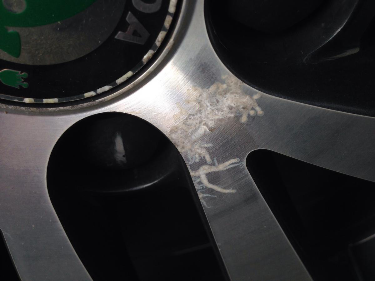

  • I am in the process of getting all 4 wheels replaced under warranty with Newmarket Skoda Bannockburn (Graham). The rear wheels are the worst but the spider effect is very evident on the fronts.   Re
Registered Oct 2012   8500 miles.
I in the first instance had emailed them a few pics (2 months ago) of the damage as I live a considersable distance from the dealers, he agreed that there was damage on looking at the photos. I was heading south last month so popped in to let Graham see all 4 wheels for himself, very pleasant and understanding chap, initially he said that he had never come across the problem before, but never admitted that he had heard of it when I spoke to him in person. Ho took photos of the wheels and was shocked at the damge and agreed that they should be replaced under warranty and that Skoda themselves might want to inspect them. I may add that there is very slight kerbing on the NSF wheel but never mentioned it even though he had a wee rub at it, I aked if I could have standard wheels as I don't want it happening again but apparently its like for like he said. Got a phone call 4 days later from Graham to tell me that Skoda agreed that all 4 wheels can be replaced under warranty, so popping in Mon 11th Aug on way back from Edinburgh to get them fitted, will post once the job is done, watch this space.

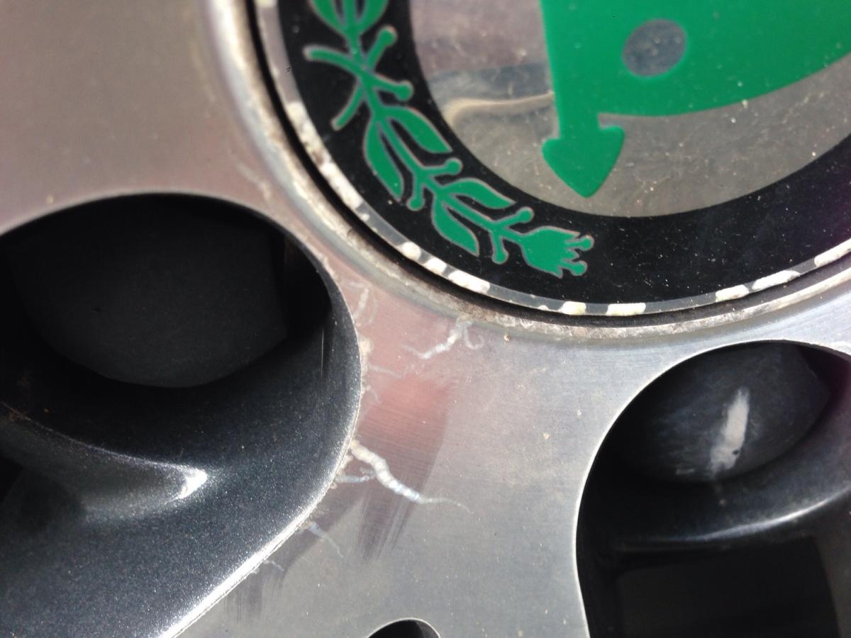

I've got the same with two of my alloys. I'm going to ring skoda tomorrow and get it booked in.
I had wheels replaced under warranty. The manager at the dealership agreed they were faulty and ordered them straight away, didn't even have to approach Skoda first.
 You will probably get it on all four eventually, wait if you can so you can get them all done together that's what I done. Back 2 usually first to get it then gradually appears on the front 2, but not as noticable as the rears.
You're right with it starting on back two. I can't see it on the fronts at the moment but like you say, it's probably only a matter of time until it's on them too. My warranty is up in October. You think I have a chance of getting them all done?

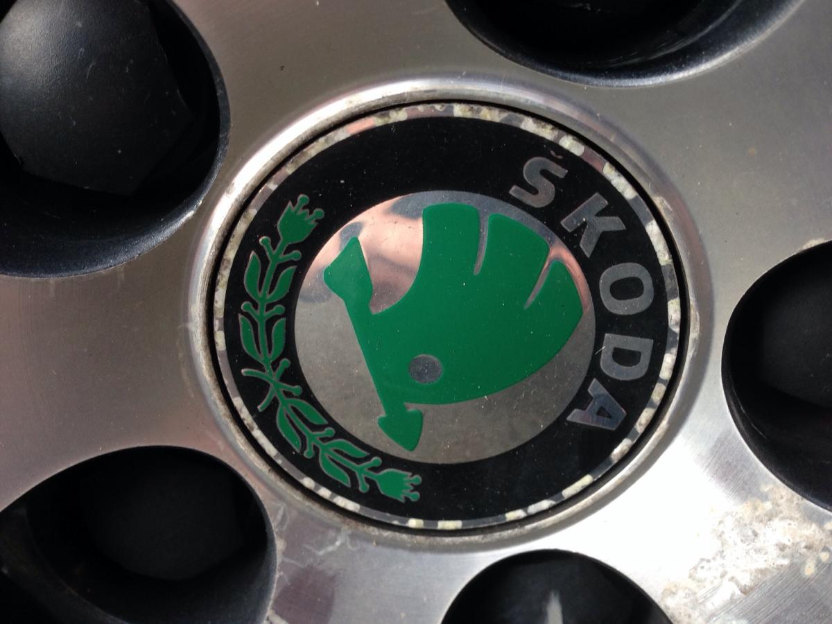

These are mine. They look a right mess as you can tell. Centre caps look dire too.
Have you had those wheels off and looked at the other side,
that is if you can know get them off without lots of persuasion.
If they have been on there without a little Copper Slip or some barrier grease they will be well stuck on.
Have the car well supported on the axle stands not just the Jack if trying to get them off.
