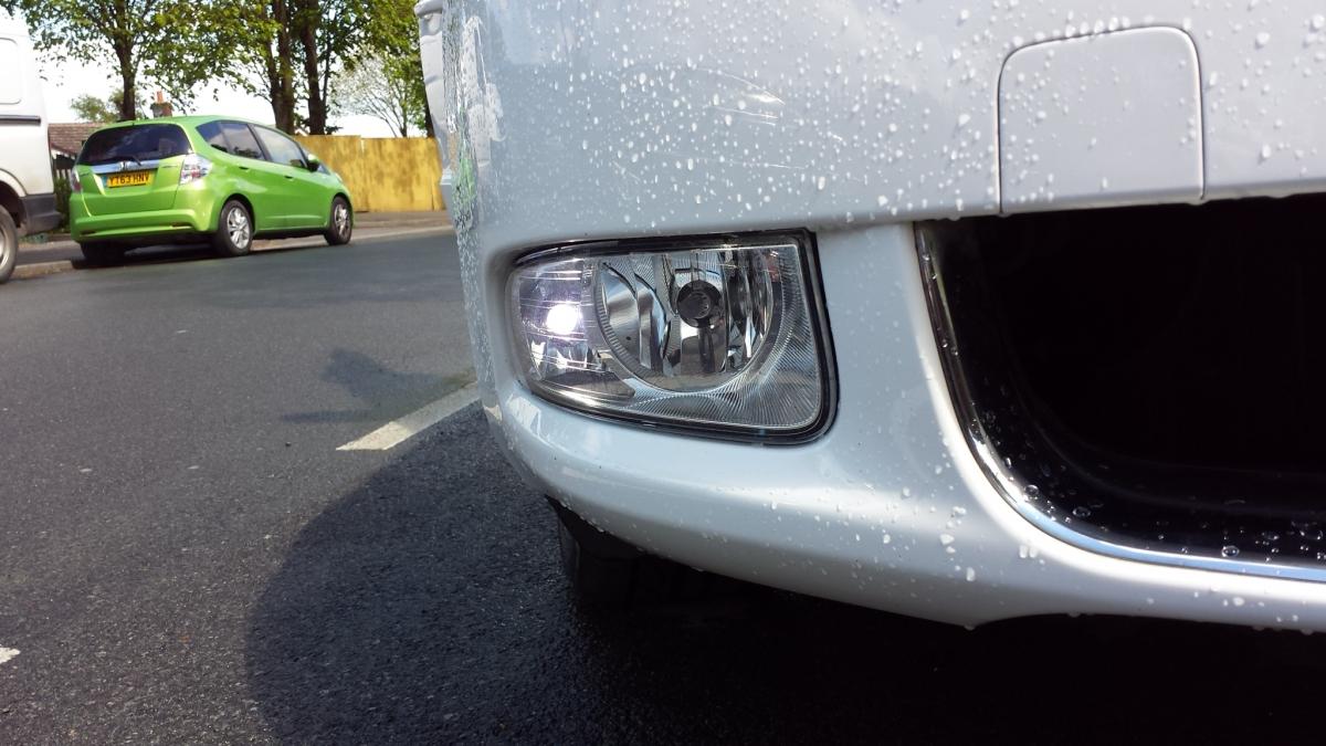

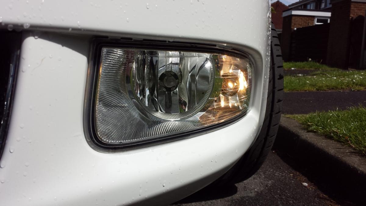

post-129764-0-42503900-1431435046_thumb.jpgpost-129764-0-10745200-1431435078_thumb.jpgThanks again to the OP and JakeBlade for the bulb link .
Fitted them this morning and hey presto , they bloomin' work !
Hard to see in the pics 'cos of the bright sunlight , might take some more when it's dark .
attachicon.gif20150512_123603.jpgattachicon.gif20150512_123554.jpgThanks again to the OP and JakeBlade for the bulb link .
Ye of little faith.
Glad you got them sorted. Now time to turn your attention to the interior LEDs!
