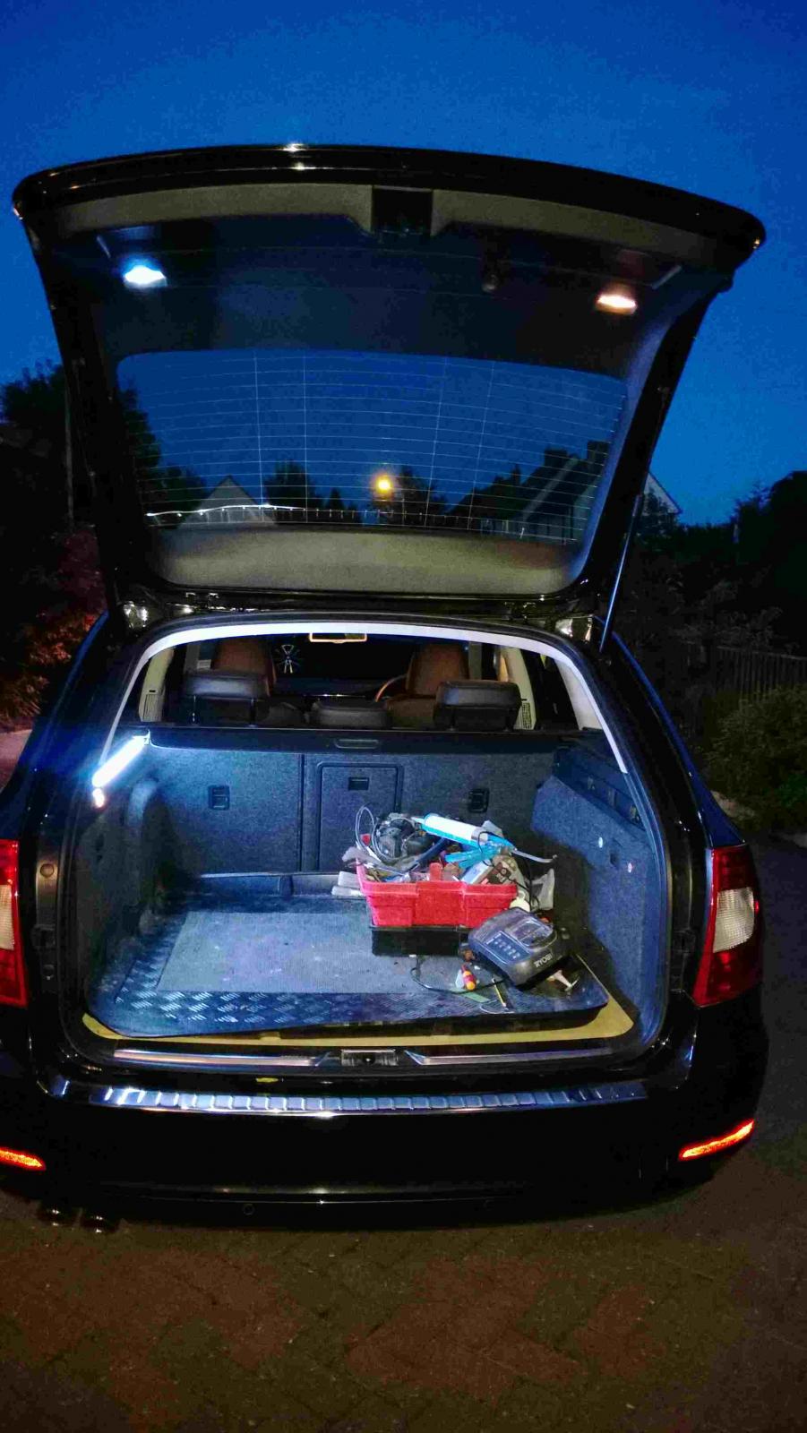

Boot bulbs made hardly any difference which is why I added the led strip.

Which boot lights did you get in the end?  The ones I bought from hids-direct are very bright.
