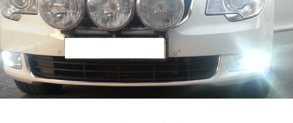

Looking good! What would be your best guess on the colour temperature? They look very white, with just a tinge of blue on my screen.
Loving the spot lamps!

  • Ordered, delivered and fitted in a couple of days...excellent service from ebay seller. Haven't been off the drive yet but the LED's look good and give no errors so far. Here's my car with the LED on
Wery hard to say what temp, but i would say a bit higher then the head light original xenon, so about 5000k maby.
I wasent after any high kalvin i just wanted a fresher looking drl without looking "fast and the furious" stylish, and that´s pretty much what i got so i´m pleased.
