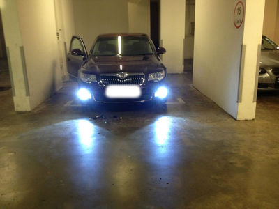

I went out and took a few photos, they are a bit close i can get better photos another day if there is intrest.
Still no radio interference or any errors (been driving ~1.5h today)
