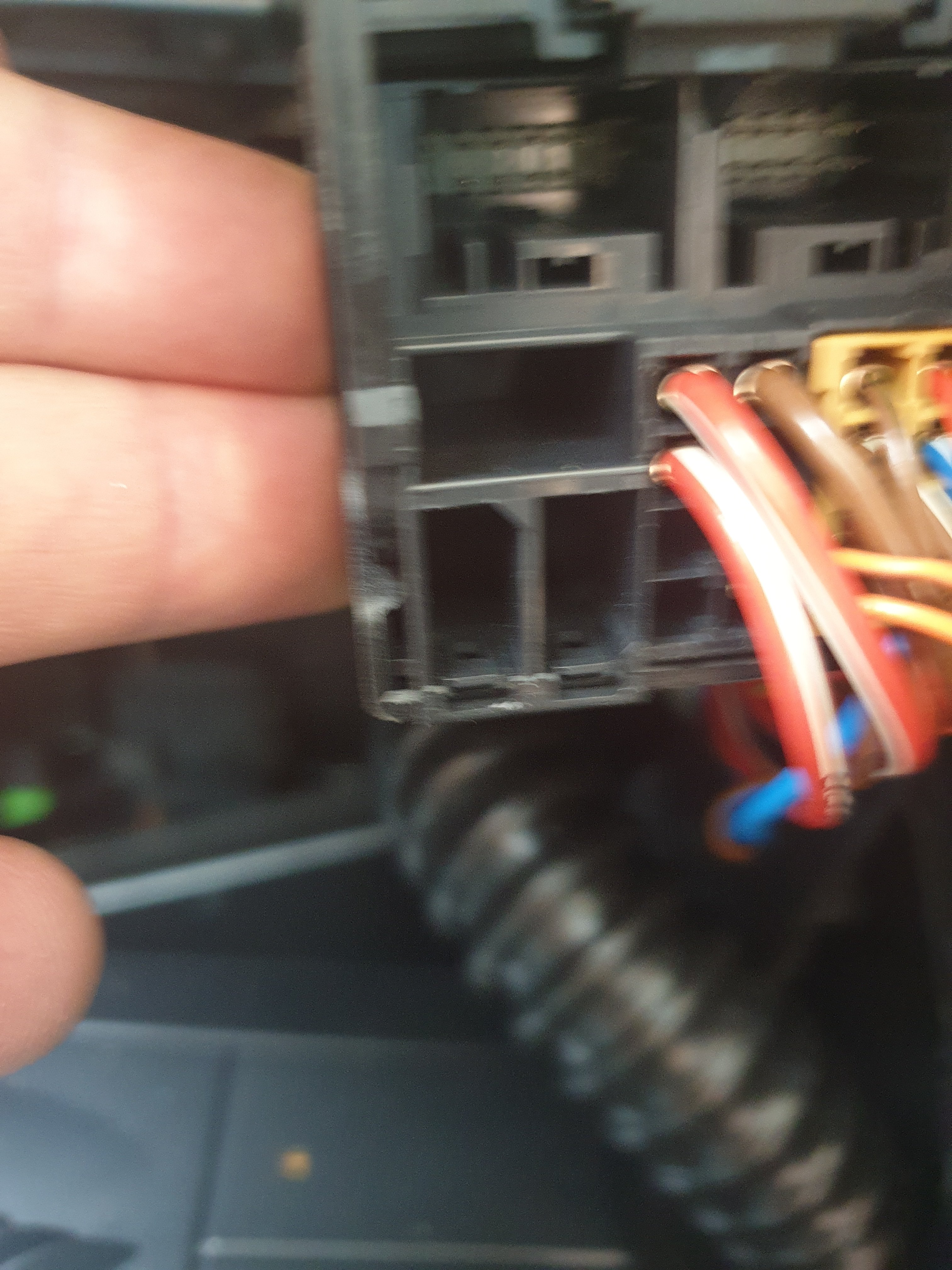

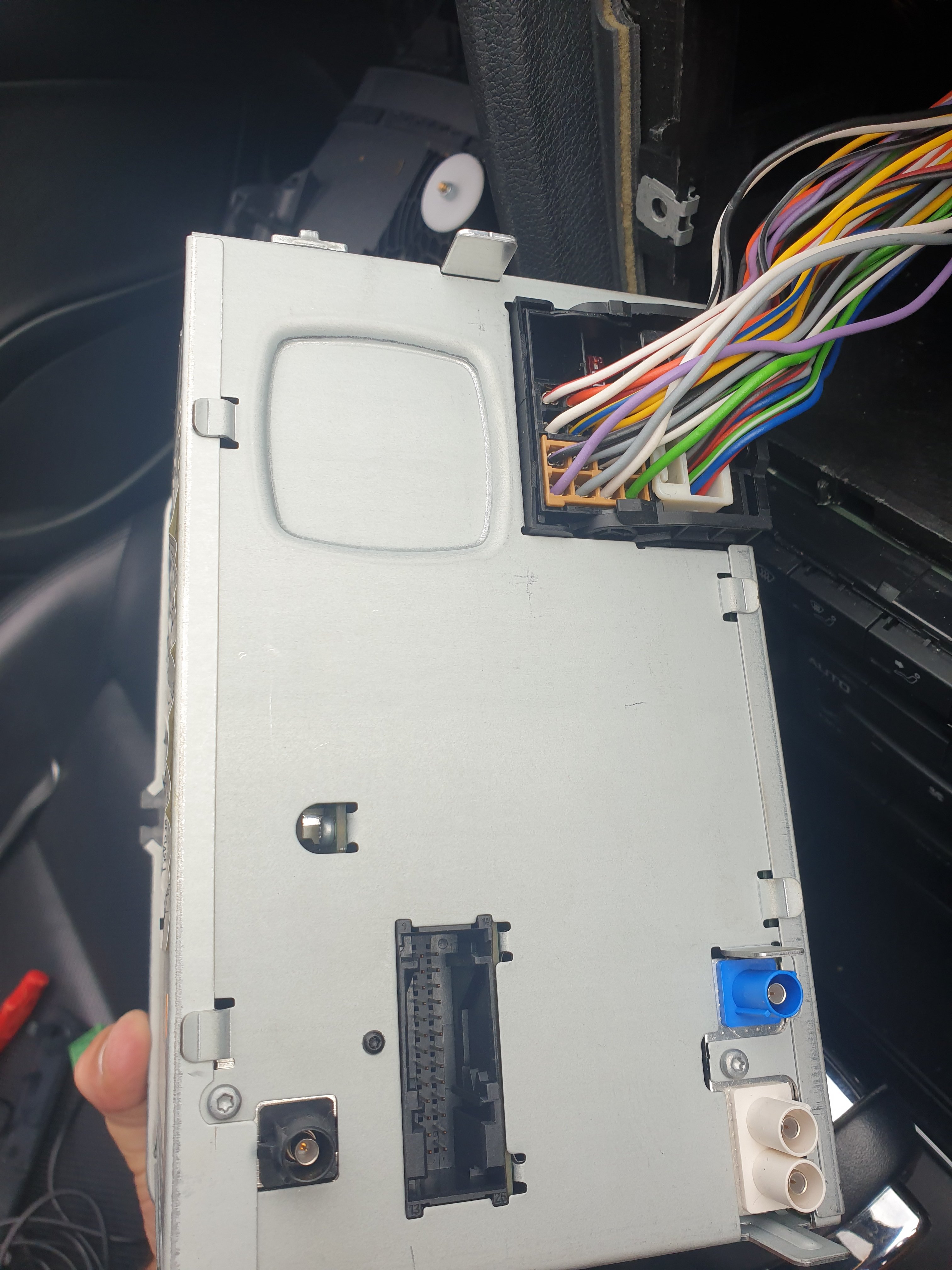

Ive bought a mic and am sat here with the head unit out.
Where does the mic plug into the rear of the unit.
Nothing obvious any pics ?
Ta.
Rear of unit, only available port is the big one with 26 pins.
Or does it go into the quadlock thingy that is round the corner near glovebox ?
That has 2 ports where it would fit. If so which one and which way round ??
Thanks.
@Jake126 - the microphone will use two of the pins in the quadlock connector.
See this post:
Thanks, well that narrows it down.
But the green connector dosent quite fit and when you remove it then it will fit in either one and either way lol.
Spose the way the green one nearly goes should show the way.
Cheers
