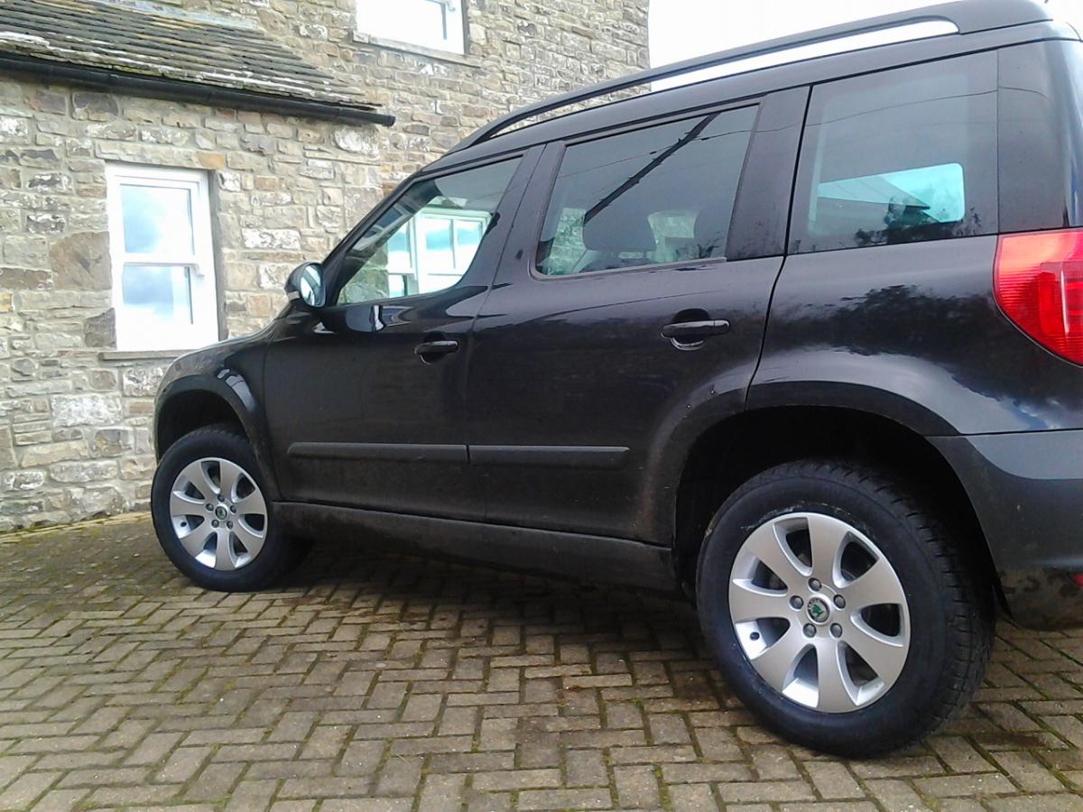

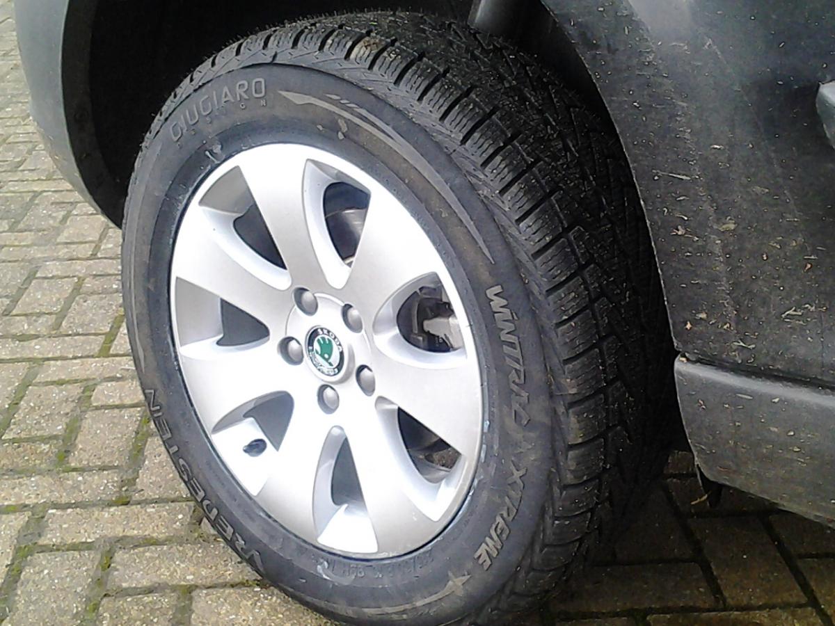

  • I'm just in the process of sorting out a set for my Mother's Yeti - will go for 17s (Dolomites) to maintain the look and probably Vredestein Wintracs which I have experience of. I have a big X5 mysel

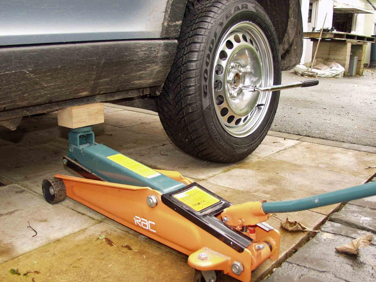

A further question, it has been mentioned on here and other threads about using a 3 ton hydraulic jack: would a 1.25 ton version do?
I'm no expert on weights and jacks but a Yeti is over 1,300 kg so it is clearly over the limit (either metric or imperial).
I'm sure there is a tolerance/ safety margin built in but personally i wouldn't risk it given the downside could be catastrophic - for you and the car.
My X5 is 2 tonnes and I bought a 3 (US) ton jack which I'm comfortable with. For a Yeti I'd be looking for a minimum 2 ton capability.
You can get them for well under £100. Steel are cheaper, more stable but heavier. Aluminium lighter + easier to transport.
You will never lift the entire car with the jack. But still I wouldnt feel too save if a jack is a bit smallish.

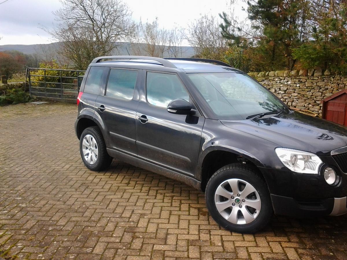

Went into my local Skoda dealer today to have my Skoda steel wheels with Continental winter tyres fitted.
Complete with RIF wheel trims,and they're storing my summer alloys for me till next March'ish.
All for £ 535.(Got a car wash and quick valet thrown in.) :)

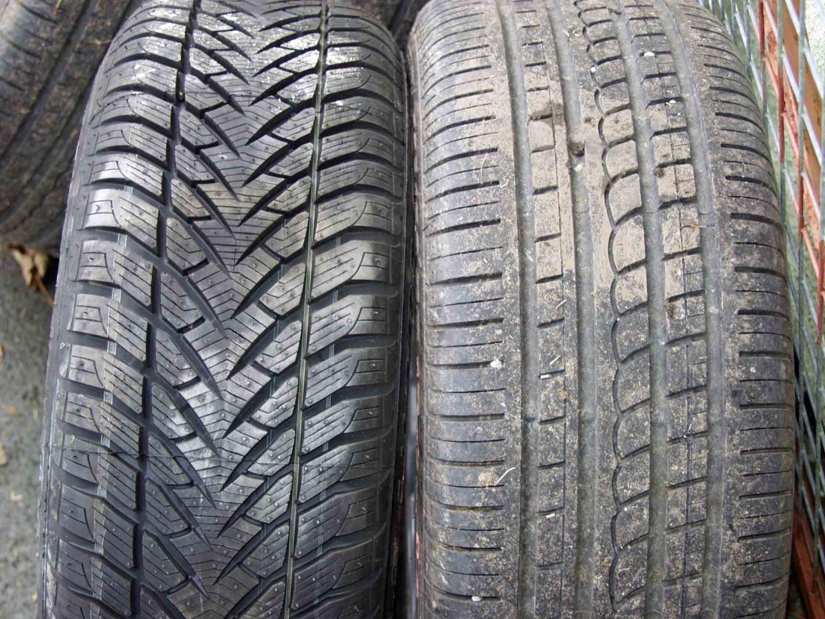

Glad I put my cold weather wheels & tyres on yesterday (205/60/R16) Goodyear Eagle Ultra Grip. It's snowing!! We are 1400' up...

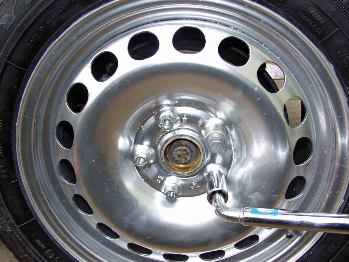

Put my winter wheels and tyres on today took about 40 min, though not including cleaning the summer ones!
Went to change the Golfs and couldn't get the locking bolts off the front think they have been over tightened and I've damaged the key trying to remove them!! Dealer wants £52.99 for full kit as they don't sell the key on its own.

I bought a set of steels and Nankang SV-2s for winter use, having endured the first winter with TIBET I on standard issue footwear. That year was very snowy and the Yeti was remarkable but...
Living next to and driving over and around the Chiltern hills means things can get interesting during winter. I found the winters give a tremendous feeling of confidence on cold, wet, icey and snowy roads - the sub 7 degC temperature advantage on winters is genuine. Normally I fit them from the beginning of December through to the end of March.
I don't like the Rif trims on the steels but should the worst happen they are cheaper to replace than an original alloy. Keeping to genuine Skoda steels keeps everything legit with the insurance company. And you can't see the wheels when driving...
I went for the Nankangs because when I wanted the winters most other types were out of stock. Googling the type came up with a quote from someone who proclaimed to have the worst car invented for use in snow - a BMW 330d Coupe auto! Said it drove perfectly with the Nakangs. £60 a corner for the Yeti. Remember, the tyre cost is not direct as you're not wearing out the standard tyres when they're tucked up indoors.

There really is a world of difference with winter tyres, however there is just as big a world in "opinions".
I spend 5 days driving a mercedes vito Rear wheel drive "winter nightmare", winter tyres make a BIG difference.
however, 2 wheel FRONT wheel drive Yeti, std supplied tyres, went every where the Merc couldnt.
All I will add is if you DO ,dont buy cheap.....
