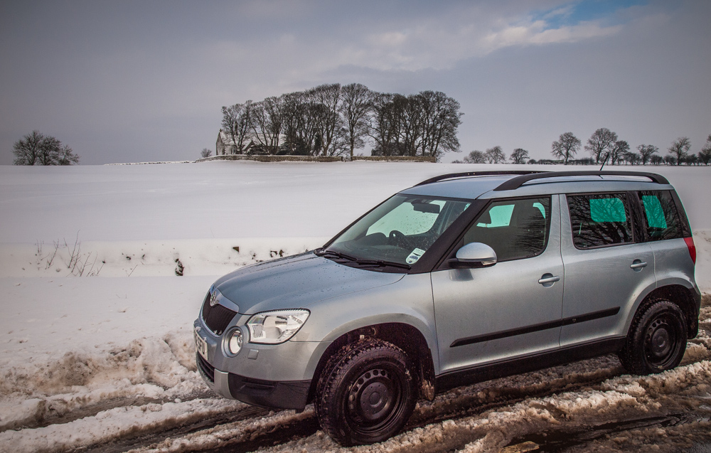

Been out lately in the white stuff-- we have over a foot of it lying now. Took a little photo of spook near the Roman Wall yesterday--then the battery died on the camera!post-82637-0-71926900-1358944275_thumb.jpg
It's got rif wheels and Avon Ice Touring ST tyres
