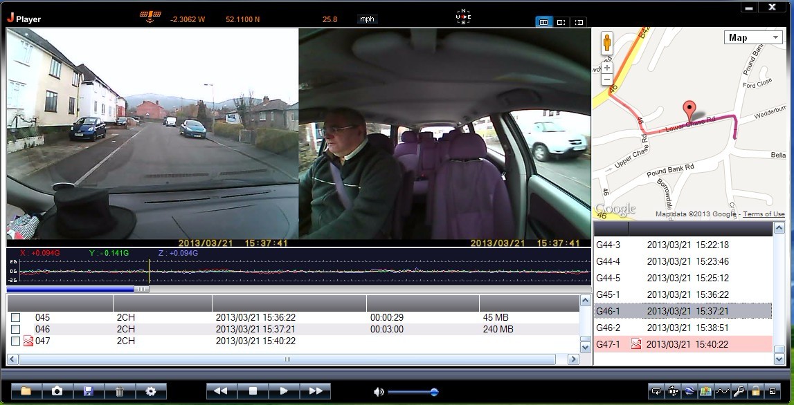

OK, so if you remember, I ordered a cheap 720p dashcam from China, I saw several reviews that praised its video clarity, even at night, and with GPS included for £31 I couldnt really go wrong.
Sadly, it never arrived, I had a call from the makers saying they were having GPS firmware issues and so werent shipping any more units, and offered me an “upgrade” to the dual cam X3000. Now I had read the specs for the X3000 and wasnt overly impressed, also, the UK reviews of other X3000s havent been very good, so I really wanted to wait for the original, but nearly a month had gone by and still no good news, so I accepted the X3000 and hoped I was getting one of the better made versions (like many electronic products, there are hundreds of sweatshops churning out clones in China).
So, it arrived; well packed and a fake value indicated to avoid customs (not my idea, a lot of the suppliers do it); the box was well presented without too much obvious “chinglish”; inside the X3000 unit looks sturdy and well made, nothing rattles and all the connectors are a good tight fit, the suction cup is multi adjustable and also mounts the GPS sensor, my only gripe is that the rubber cover is futile as it needs to be left open to allow both the power and GPS leads to be inserted.
The microsd card is a little fidly, but I have big fingers and microsd cards are... well... micro sized!!
Opening the (slim), manual gives you a few worry pangs – everything is in Chinese! But shuffle through a few pages and you will find a fairly well translated English version, and after that a Russian version.
Set up is painless, just insert the card and it will ask to format, then go into the menu (which takes a little while to appear), and set up the options as you want them. The unit can take stills as well as video, and the battery alows it to run for a short while without power.
The X3000 contains two camera, one pointing forwards and one facing the rear, the rear one is a 140 degree wide angle lens and the front one is a 120 degree wide angle lens with a tilt action, and the display shows the two video feeds alongside each other, although there is an option to select either front or back to display on its own. The display is rather dark, although that might be the angle I am viewing it from.
The camera works well, starting up quickly and saving the files with only about 1 second gap, the actual size of each secgment seems very variable, I havent yet figured out the logic behind it – some sections are a few megabytes, others run to a gigabyte!!
Formating the card also installs the “Jplayer” software that is used to access the files, although you can save them to your pc as video files only, or as stored Jplayer files, you can also copy and paste the Jplayer exe across, so you can view the files without having the card inserted.
The Jplayer software works well, displaying the video feeds (F, R, F+R), with speed in KPH or MPH, lat/long co-ordinates, direction of travel (using a tiny compass), G force and shows your progress on a google map insert.
There are issues though; there is no maual for the Jplayer, and some of the menu items display as mostly blank boxes, so it is a guessing game finding out what they are; the player will also not run full screen, so you have to export the video file to see them enlarged.
One final (possible) issue, I am wondering if the GPS speed reading is low; either that or my car over reads by about 10% as when I am doing about 60MPH, the display says I am doings nearer 54MPH.
I dont have any night time footage yet, I DID have some but something strange was happening; the first day or two the video quality was a bit disappointing, the picture just didnt seem as sharp as it should be, then suddenly the picture seemed to get better. Perhaps it was some chemical film on the lens that finally evaporated, I dont know.
Various sellers list various video file sizes, and the unit is supposed to be “HD”, but in actual fact the video size is a very odd 1280x480 combined; and if you decide to only record with the one camera, you only get 640x480, so DEFINITELY NOT HD.
PS, the car seats arent really purple, I am not sure why they show that colour when everything else is correct. (They are actually black)
Just FYI I did a detailed calibration of my speedo against two GPS units (Medion Satnav & Samsung S2). Both GPS agreed with each other, showing my speedo consistently reads around 10% over the GPS speed.
I asked a Bobby on here (privately) for his opinion on speedo vs GPS speed for police purposes and he confirmed he would only ever go on the GPS speed.
I will repeat the calibration exercise and report the detailed numbers on here at some pount.
Finally, many thanks for the detailed report on the camera; much appreciated.
Regards, Mike
Thanks for that Sticky, I did suspect it was the car, as I know some manufacturers do it on purpose, as they are allowed 10% OVER read, but 0% UNDER read on the speedo calibration, so go low to avoid trouble.
