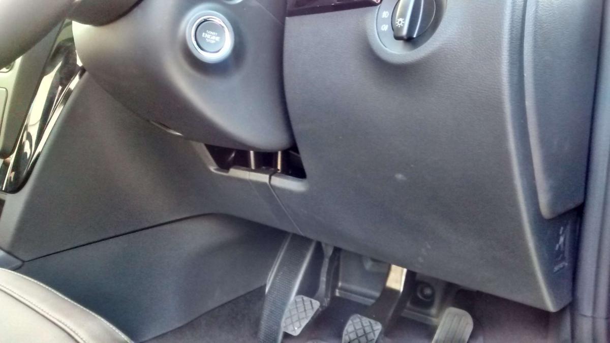

Having taken a Blackvue out of a Fabia and now want to put it into my FL Yeti it looks like i will need some guidance in dismantiling in the drivers footwell.
As you can see from the picture the fuses are directly behind the panel in the top right, however the plastic panel under steering wheel is quite solidly fitted , so my question is - Has anyone unscrewed / unclipped this panel to access the space & if so how is it done ?
I do not want to damage a 2 week old car.
Not sure why you need to remove the panels Steve.
I wired the Backvue into the Superb like this:
As you can see there was enough room in the side panel to fit an additional cigarette lighter socket (so the OE Blackvue power cable plug straight in with no modification)
I intend doing the same when our Yeti arrives.
Hard wired obviously looks neater as you will barely see any wires (a tiny bit of cable can be seen where the power cable runs from the interior mirror up to the roof lining).
It obviously will take a little longer to fit this way, but it’s hardly difficult, you also do not ‘loose’ a power socket.
Plug it in is quicker, but you have the power cable running from the interior mirror down to the power socket - looks tacky IMO and it also alerts anyone walking by the car that you have something worth nicking fitted.
It’s your choice of course but for me ,,, hard wired every time!

So to confirm.
I would need those two parts posted above to hardwire it?
You don’t ‘need them’ as you could cut the plug off the cable and wire it direct to the fusebox.
But personally yes I would buy a ‘fuse tap’ and female cigarette lighter socket as it will be easier and fully reversible
