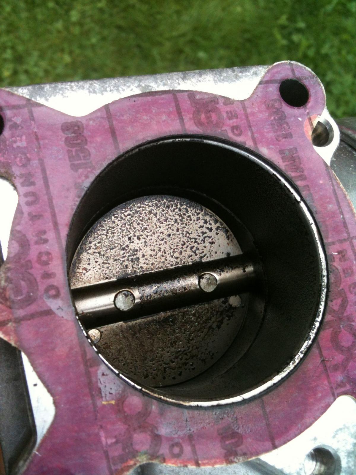

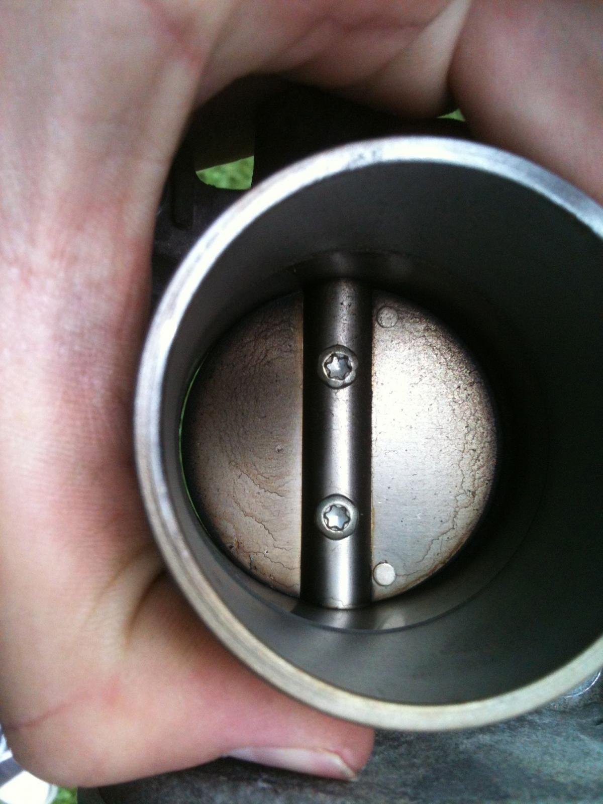

I have taken the throttle body off (I'll give it a clean) and I'll post some pictures of what it is like now, if someone could tell me if it looks OK or not that'd be greeeaaat :). I've read it might be the idle air control valve, so thats the next step.
Bottom of the throttle, looks pretty oily. There is some oil in the inlet manifold too.
Top of the throttle.

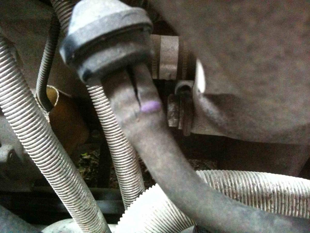

Finally, I saw there was a pretty battered looking tube going into the back of the inlet manifold, with a crack at the entrance. I think its brake related, and I read somewhere that this can cause stalling problems? It does make a sort of low whistle as it speeds up, which I assumed was just the noise the engine makes, but I guess it could be the brake vacuum thingy. The MOT guy did reckon the brake pedal poked out a bit far, but he let it go. I  can't see how this'd be heat related, and I imagine this is irrelevant. I'll post a picture though.
This is the entrance to the manifold, looks pretty cracked

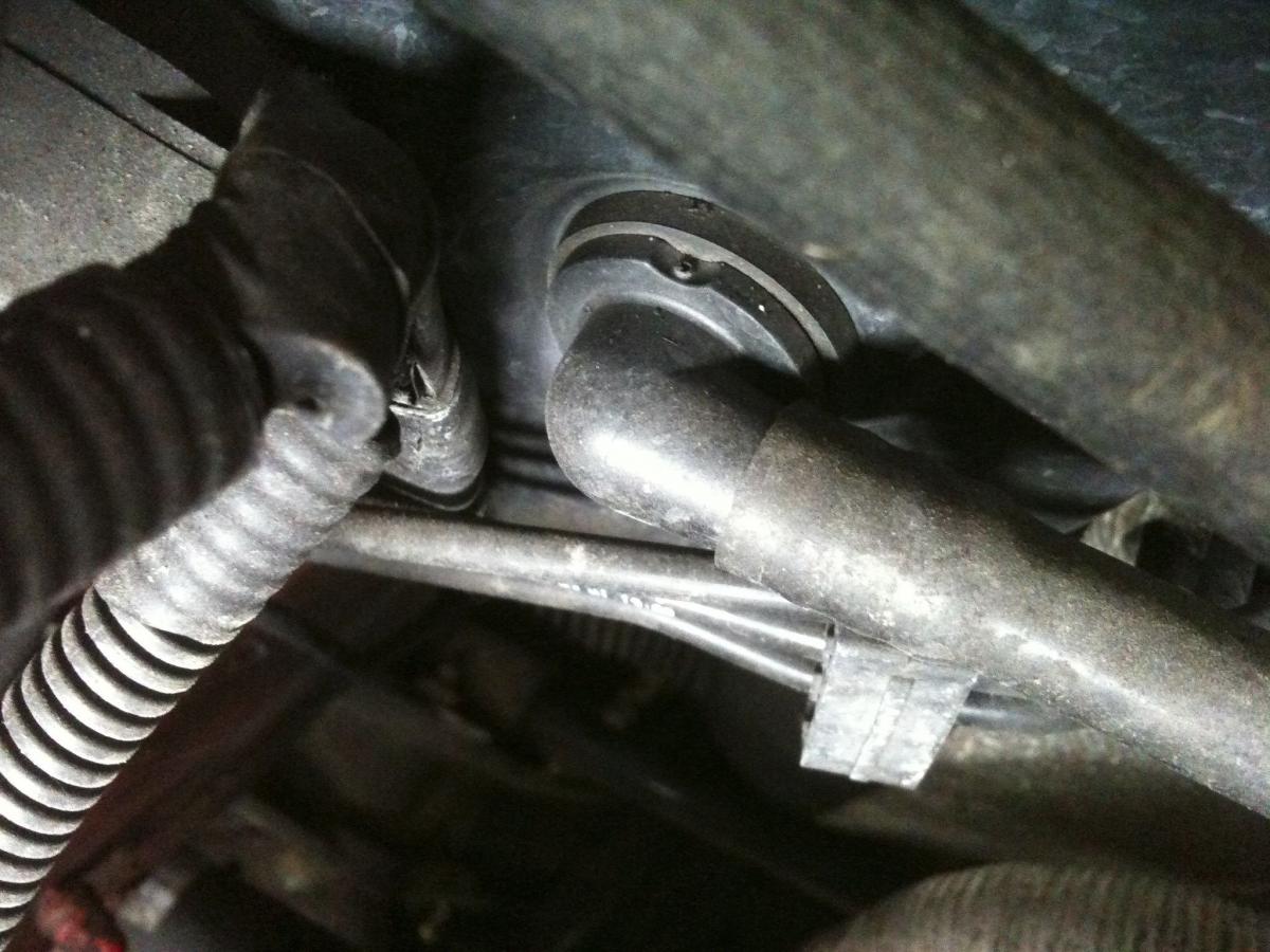

This is where that pipe enters the brake thing (drivers side of the engine) This area looked a bit damp around the pipe entrance earlier, no idea if this has any relavance.

That pipe is the vacuum pipe for the brakes.
Start by getting that changed.
It can cuase stalling problems or even loss of braking assistance.
Quite common on the fabia.

Yep, heat will make the pipe softer, more flexible and so leakier at that cracked area.
Throttle body looks like it has been cleaned pretty recently.
