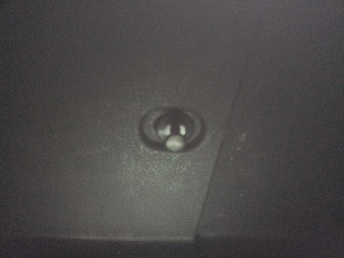

Hi lola, this is what the part looks like and if it has popped out, then it will just need clipping back into it's position.

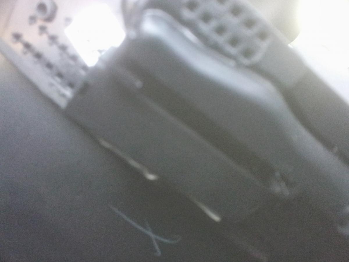

This is where it should be slotted in.
You will need some screwdriver torx bits (for the star shaped screws) to remove the fold down plastic hook, the large round baggage anchor & star screw in the gap left by removing the parcel shelf.
You will also need to remove the large knob that holds the rear light cluster in place, a large flat slotted screwdriver will do this.

You should now be able to gently ease the rear of the large panel away frow the side of the car to see behind it and replace the clip.
