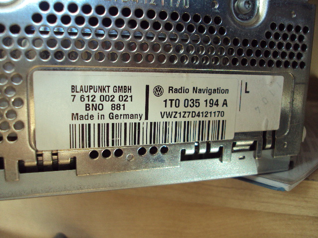

hi guys i have been offered a mk5 golf unit with nav. I need to know will it fitt in my octavia sport which is on a 56 plate does the unit have built in bluetooth etc if not i wont bother as im really after bluetooth as i have a long commute or can anyone recommend a double din unit with bluetooth for calling and music this would be fab thanks. hope this all makes sense.

The unit is an Mfd2 and an early version and uses a CD for the map data
The same unit was fitted in Skodas too, although with green illumination I think it was called the nexus
http://www.oemretrofits.co.uk/satnav-skoda.shtm
It will fit
As Eddie says, but it has no bluetooth as std.

I fitted one of these into my 07 vrs estate and it was'nt a bad unit tbh.
I had the incorrect canbus gateway so if left for any longer than 3 days my battery would be drained and would not start.
no bluetooth as standard.

Chinese copies, best avoided unless you like tinkering with software. Members have tried them in the past, some are better than others. Some have major software issues that cause them to crash, they are mostly using a very outdated version of Windows CE.
As there are so many, its difficult to know how they fair until you get one and try it.
The MFD2 in the first post, is quiet old and dated but you can still get new maps for it. The current 2014 version is provided by Tomtom but is expensive at more than £100 just for the UK.
