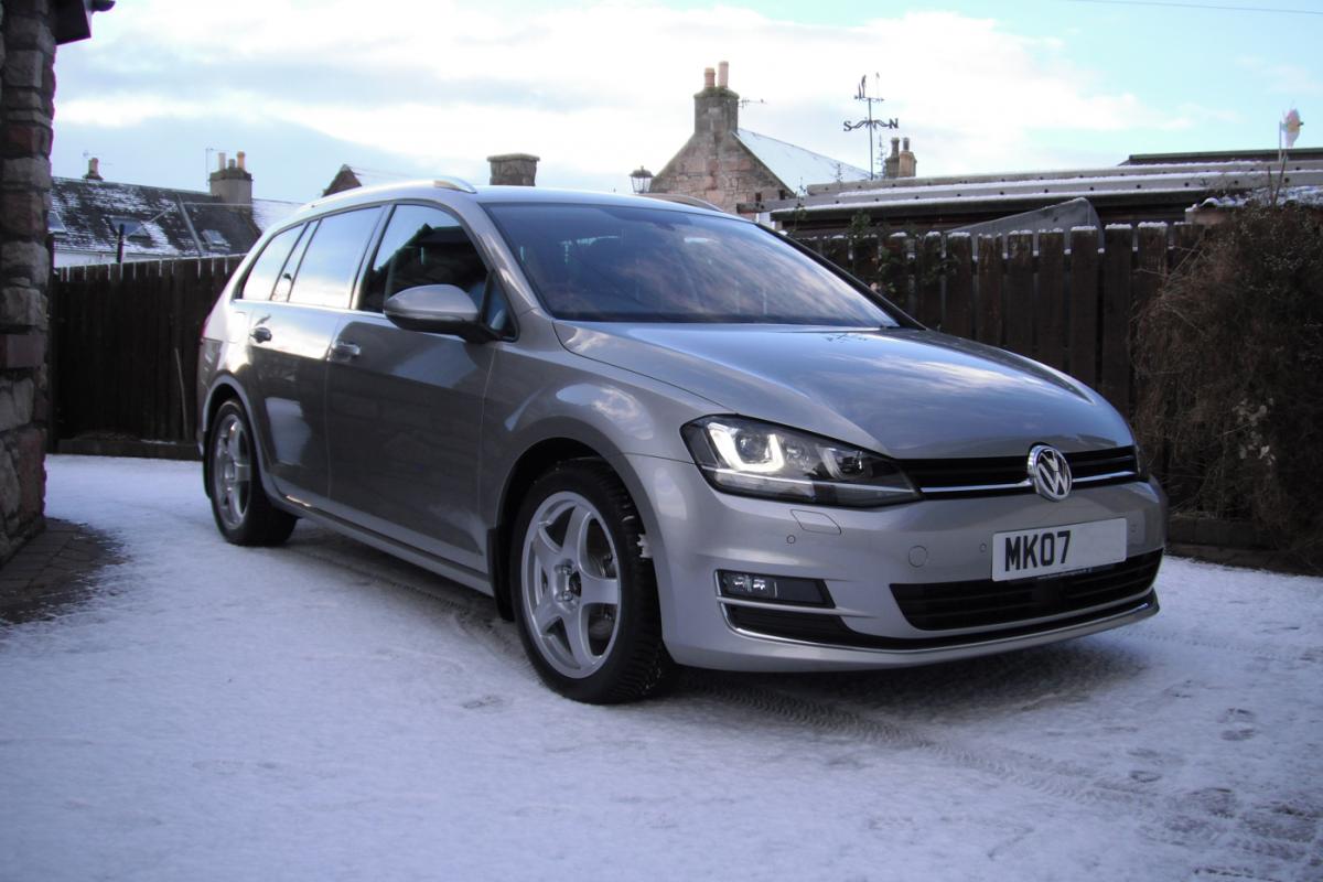

Ok so not an Octavia as such......................but most of the same components................& alloys are Team Dynamics Pro Race3, 17x7 et45 with the new Michelin Alpin A5, 225/45R17 tyres.....
Most aftermarket wheels are 60 degree taper bolt figment which the Skoda has as standard. I had to use radius bolts for my Audi wheels.
You may find the aftermarket wheels require different length bolts though
For ATS Radials you'll need M14 x 1.5 60 degree cone-type bolts with 17mm head and around 30mm thread length.
Nice wheels, I have them on mine.
