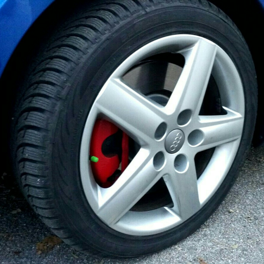

Nokian's D3 225/45/17
Rims are obviously Audi's leftover (previous car), 4F0 601 025 AF Z17:
7,5 x 17 ET45
BTW I cant see any crucial difference comparing to Gemini 18", except colour. They even look nicer than I thought they will [emoji12]

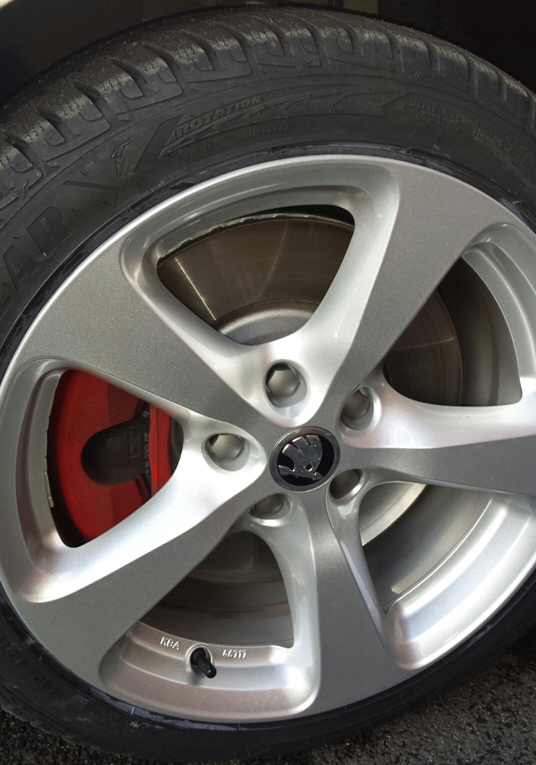

Put mine on this morning. Bit of a bonus that the centre caps are the same size as the standard wheels so they look like skoda wheels (ish). Bad news is after only 600 miles the wife has caught one of the standard wheels. Only very slightly fortunately.
The tyres are goodyear ultragrip gen 1.
Borbet also make some of the OE Škoda wheels which is why your caps fit.... bonus.
That will be why then. Far cheaper than OE this way.
