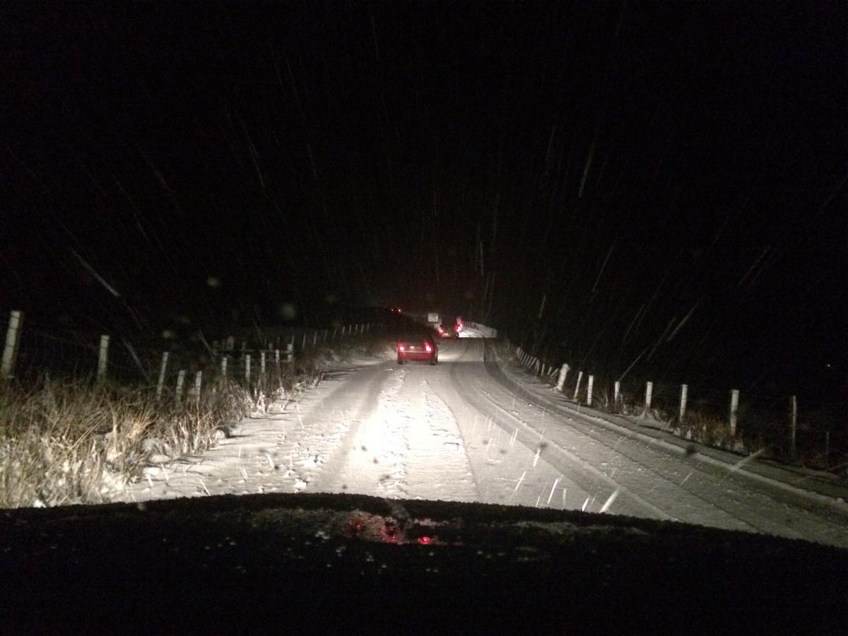

This is where I got stuck last week (along with a dozen or so others just out of sight).
I couldn't believe how bad the Octy was being FWD, on swapping to the winter wheels I could see why, my factory fitted Sport maxx RTs at 4-5mm are literally just 3 continuous ridges of rubber - great for dispersing water and lateral grip but unbelievably bad in snow.
You are crazy, diving with those Dunlops in such snow :D
 The less contact area the better on slippery surfaces.
Maybe you should call Nokian to share your knowledge. Tell them they need to develop a special 125 width tyre for driving on ice  :rofl:

People forget that driving in the winter in conditions such as that seen in the picture kindly posted 8 posts up by 1600cr, that it isn't about being able to drive wherever and whenever you want to reliably. If you can't drive to work because the roads are far too slippery or are blocked by the summer tyre shod 4X4 Chelsea brigade, no one gets hurts or dies. However, if you are driving in snowy conditions (such as the picture above) and have to stop in an emergency or wipe out a bus shelter / slide through a red light into the traffic etc), that is the only time you will wish you had winter tyres fitted. They DO MAKE A MASSIVE difference in conditions like those in the pic above and in the cold and wet sh**ty conditions we normally experience every winter.
