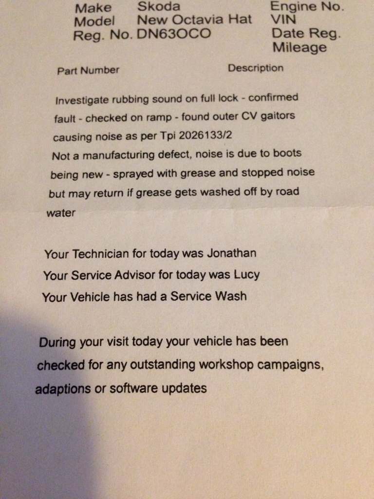

Apologies gents. I commented without getting the sheet back out - see attached image, is that normal?
Phew! That's one less thing off the list to check when I pick mine up :)
Haha my bad. I presume the above is ok then?
If it settles down after a bit of use then it's fine mate :)
If it doesn't then back to dealers for a free replacement...and again it's fine :)
So it the boot creaking and not the boots innerds. Hmmmm.
THanks.. will mention it when I get the headlight washer fixed.
Surely that aint nomal either - I thought the boots were made of rubber, so where is the creaking coming from?  Why would they need to grease the CV Boots?

Replying late this topic, but I notice the worksheet has the car down as a hatch & yours is an estate !!!
Mine isn't it's a hatch.
Sprayed with grease, what grease can you spray ? Sounds more like sprayed with wd40 which will have been washed away in a week. Have they never heard of silicon grease, great stuff and very resistant to heat and water, but is expensive so I guess that's why they don't use it.

I would have thought silicone or ptfe spray was maybe a better solution. The bellows squashed closed on one side at full lock so folds touching and rubbing as it twists.
Probably the boot is a little too closely clipped on the drive shaft end, that is, looking in the straight ahead position, the boot is too compressed. The dealer should really undo the clip and pull the boot back a little and reclip, if that's possible. Rubbing could lead to the boot splitting over time.
Mot testers might fail a car with visible grease on the boot as they will assume it's come out of the CV through a split.
