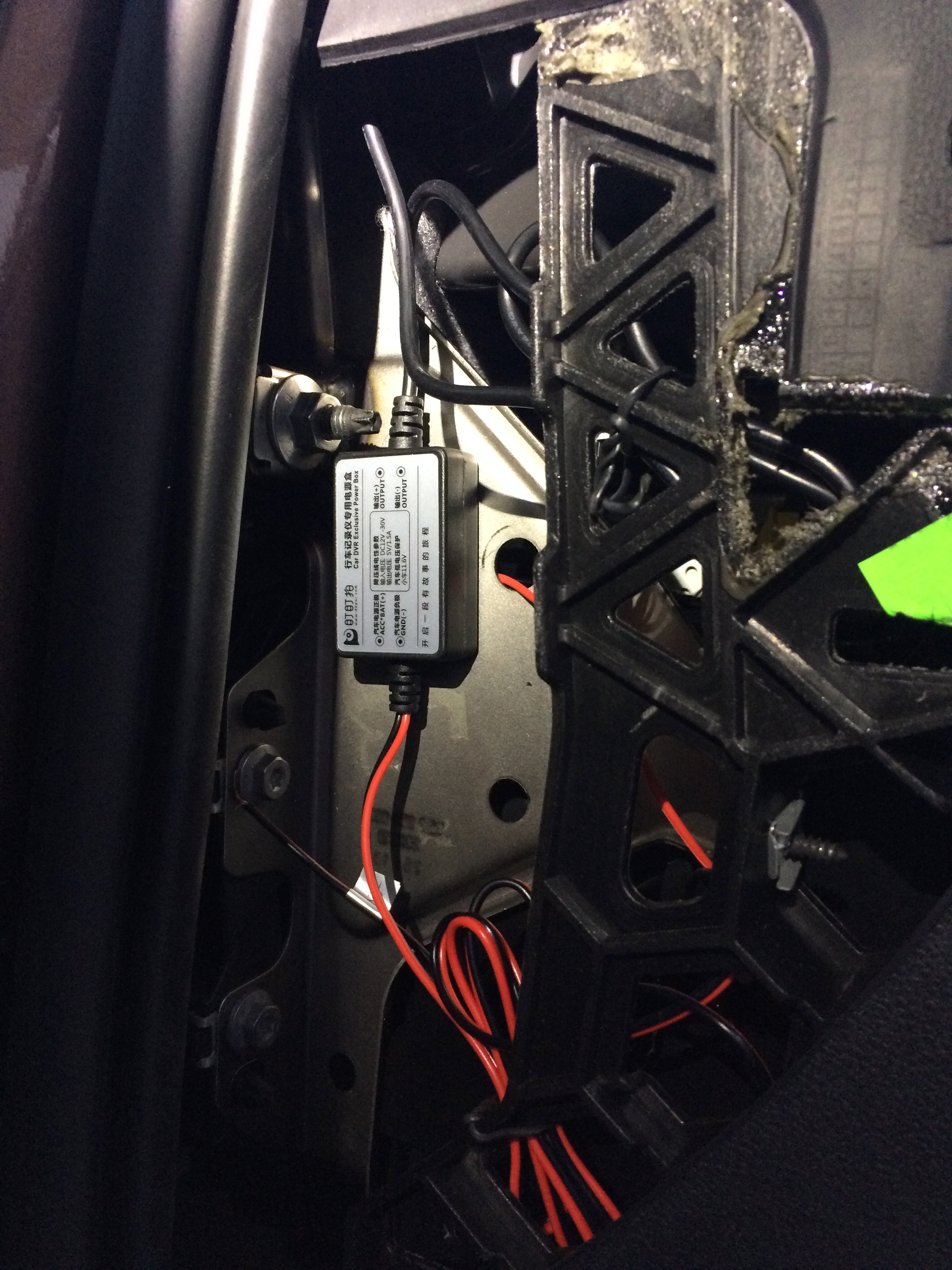

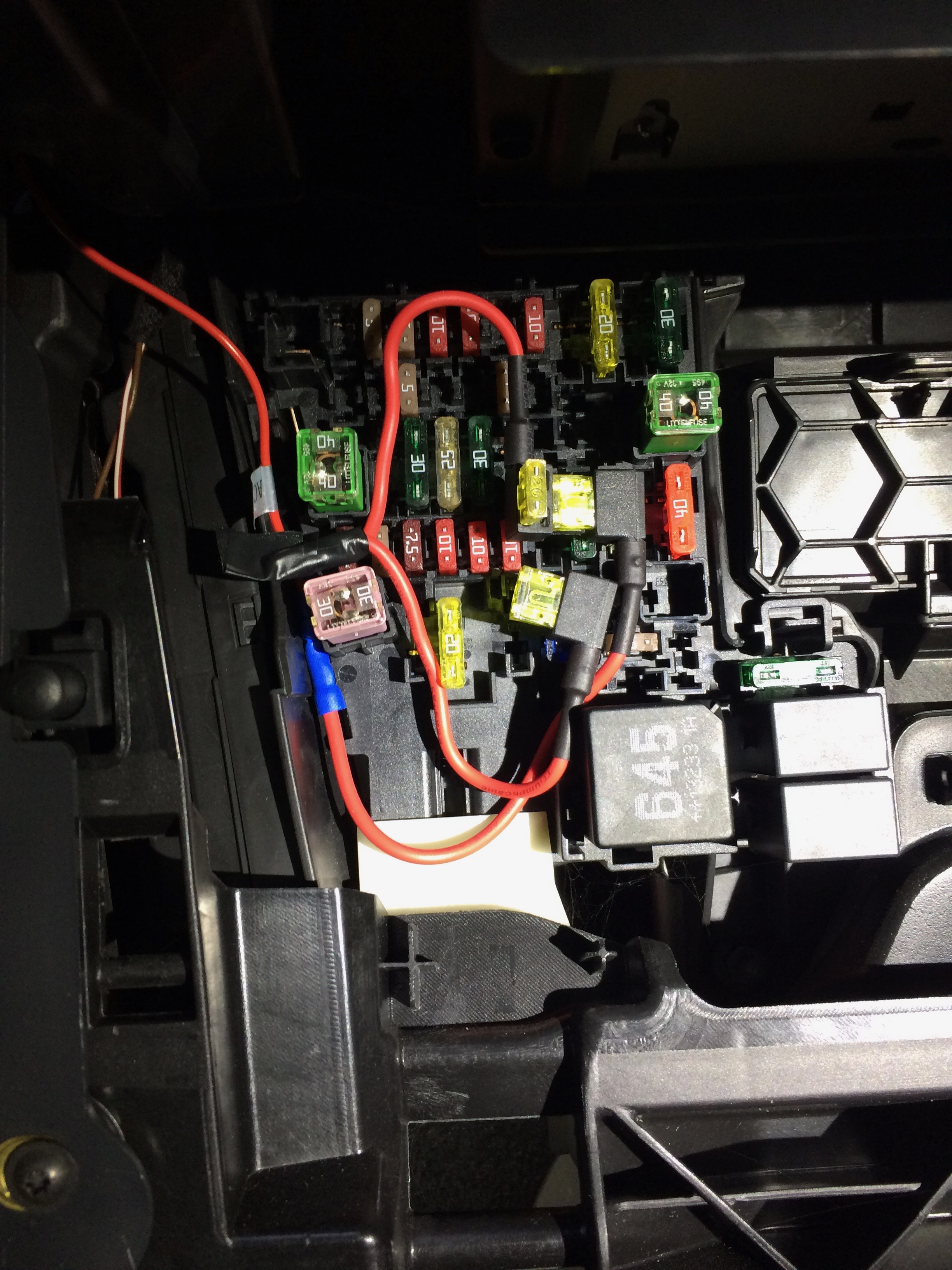

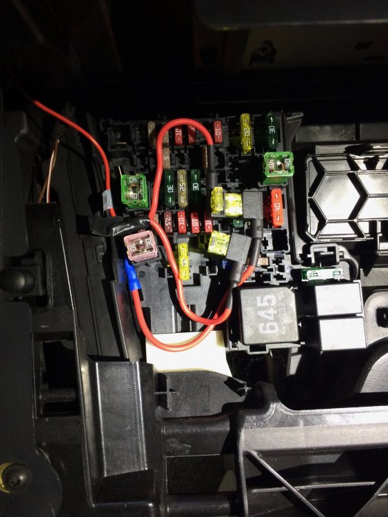

I've just installed my DDPai mini 2 today. Powered 24/7 with timelapse parking guard and 11.6v battery protect. Whole kit including 32GB SD card only costed me £63. I wanted something that is so tiny it's very hard to notice. The dashcam is completely hidden behind the rear view mirror, completely invisible to occupants. I as driver can see a part of the blinking LED if I move my head slightly, so I can check its status if needed.
IMG_0281.thumb.jpg.db626da2198c0fe6a5f1e2c9c3a5e470.jpgIMG_0279.thumb.jpg.fbf588e993040ed89d01000a271f8a4f.jpgIMG_0278.thumb.jpg.d8ddb624307e4773dfccd14036c17290.jpg
The fuse box wiring is because I wanted key switched 12v sockets. See my thread for more info:

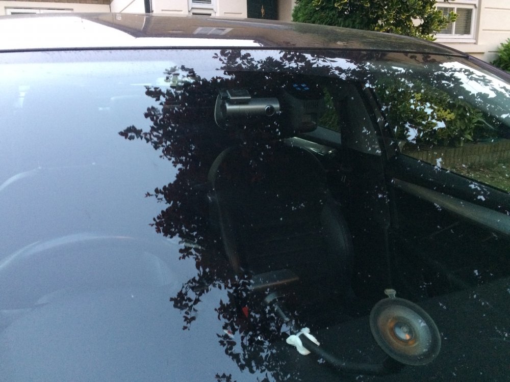

Been meaning to add these for a while. Using a pair of Mobius cameras both hardwired in. Took a while for me to find mounts I was happy with for easy removal and placement.
Edited by WayTooTall
Forgot the photos. Doh!!
Seen some posts mentioning that the Octavia 3 needs a mini blade, but some posts say standard.
Which should I order?
A lot of mounts here are shown on the left of the mirror. My mirror has a sensor there. Dont other mirrors also have similar sensors? Doesn't trhe camera block the sensor?
I needed standard size blade fuses in my Octavia 3.
Thanks. I ordered the mini ones, saw that they were wrong and reordered the standard. Using the mini now in my other car.
