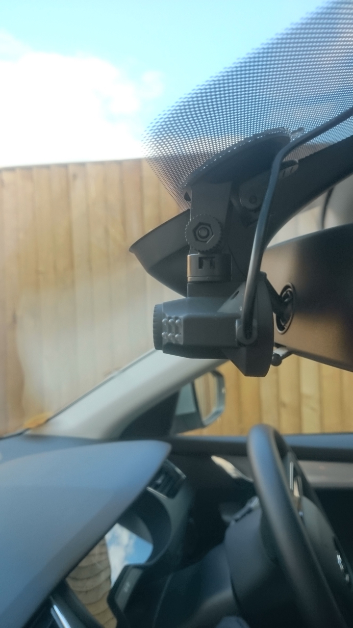

I see your point - Ill try to point it down a bit. The low sun doesn't help - I've also uploaded a couple more from last night and this morning.
The morning sun really does highlight the reflections
Morning low sun

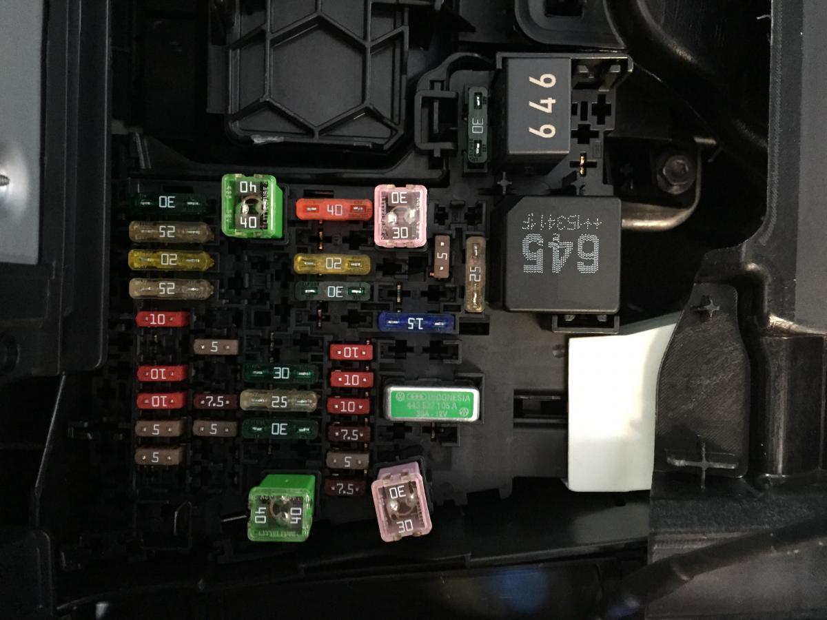

Guys
Tried to hard wire mine in this morning and use the Rear Wiper Fuse, but on the L&K theres not enough room to get the piggy back fuse in, the fuses either foul the ones to the left or right (I guess these are for some of the extras that come on the L&K?).
Any ideas which other one I could use?

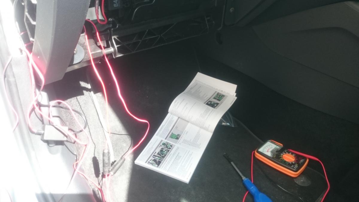

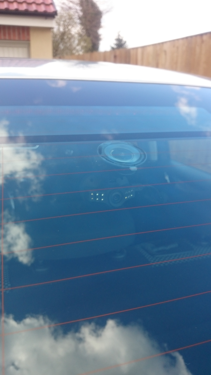

Did my dash cam install today, i should have taken more/better photos so apologies in advance for not doing so.
Used the fuse for the rear wiper as mentioned in this thread, no problems. I used the middle bolt of the three visible in the end of the dash as it was easier to get to with my socket.

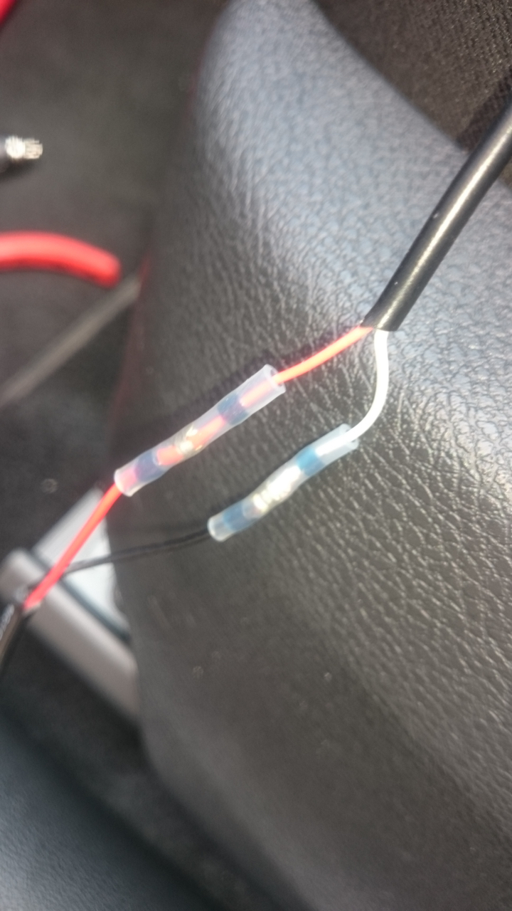

My wires from the rear cam were not long enough, so i extended them using some solder sleeves.

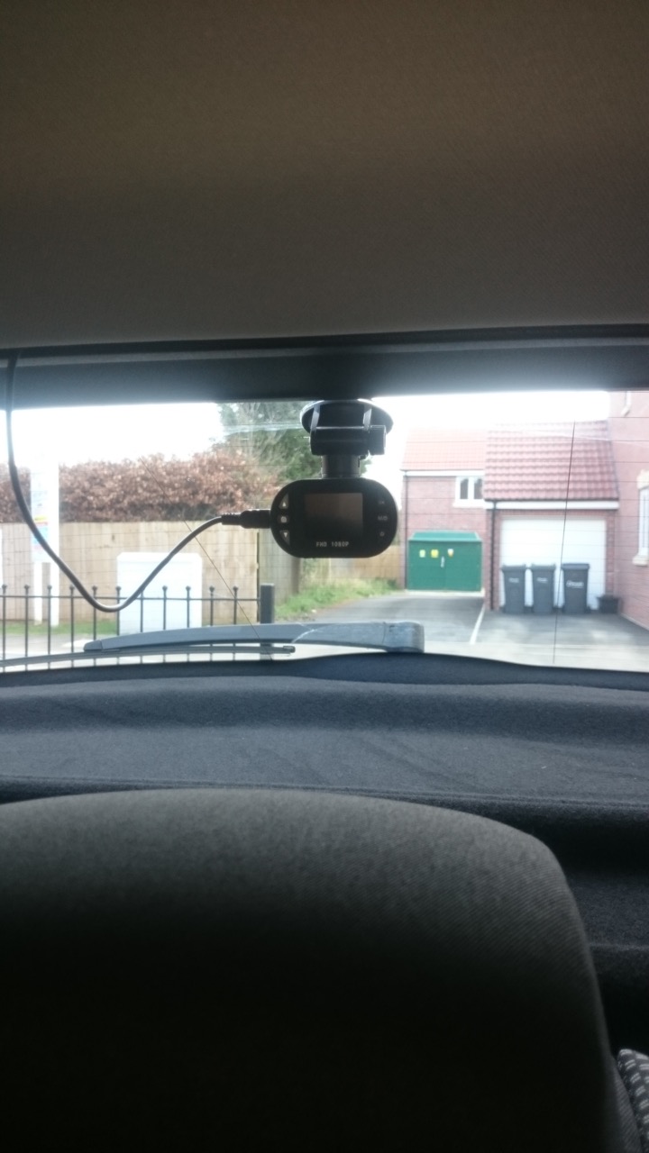

Front cam interior
Front Cam exterior
Rear Cam interior

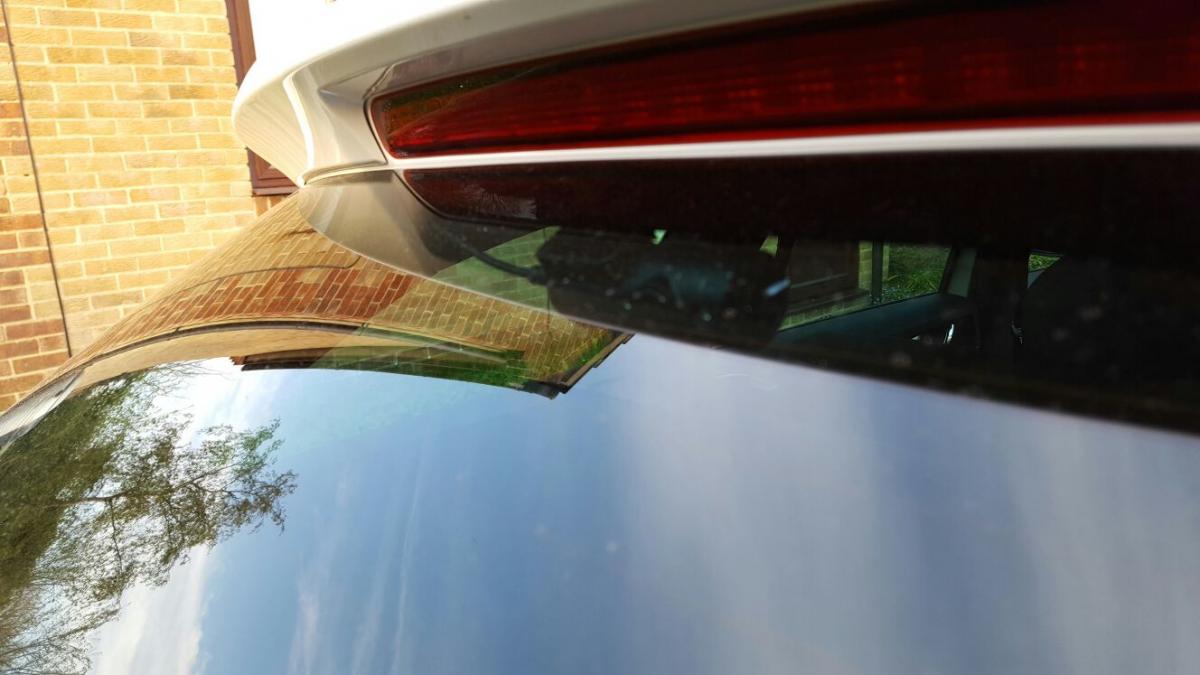

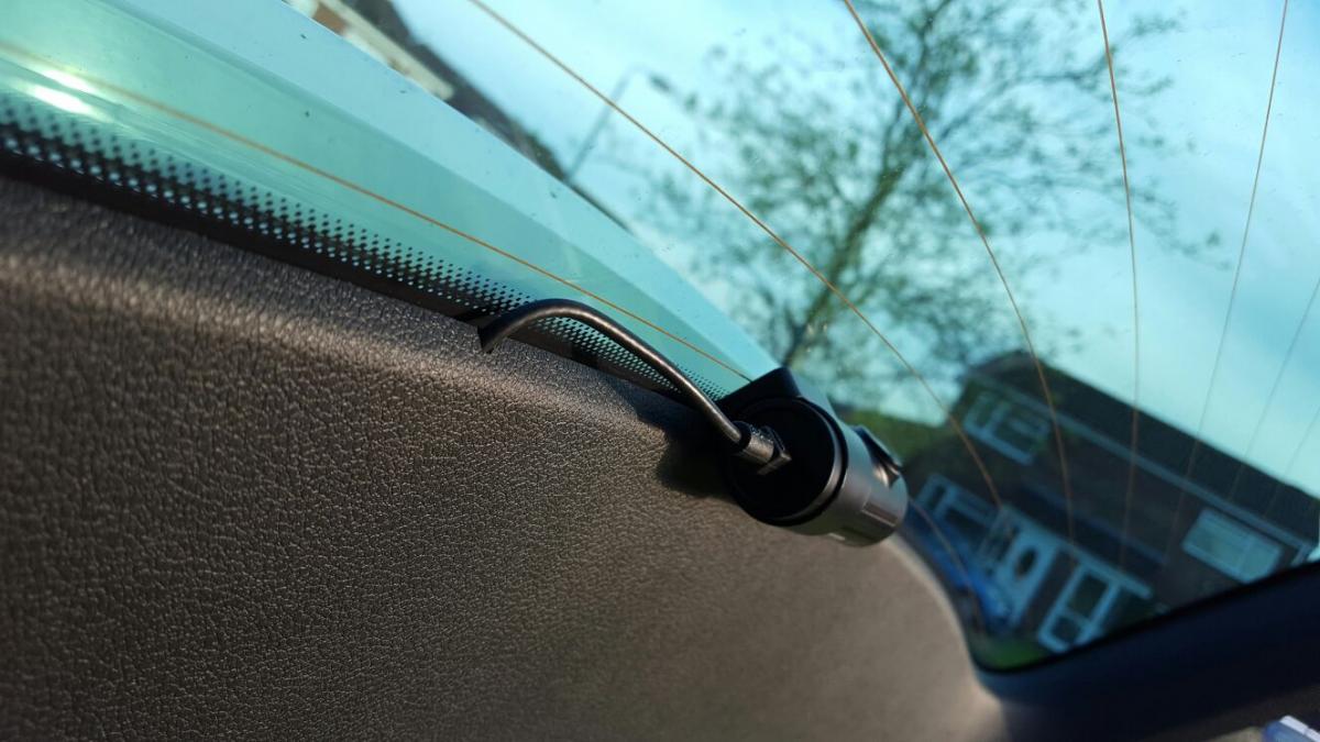

Not really happy with the rear cam hanging down so much. I bought an adhesive mount with the intention of sticking it to the plastic housing of the high level brake light, but it will not stick to it. Need some stronger double sided tape maybe???
Rear cam exterior

Guys
Pic attached of the fusebox!
Thinking of fuse 26 - Heated Front Seats, that should be switched I reckon......
Edited by skyjawa
Can't use the rear wiper as mentioned. L&K has other fuses that fowl it :(
thats a bugger - did you try the heated seats fuse? That must be switched
Well, that's a pain. Tried every other fuse I was happy to and all were live grrrrr.
In the end I had to slightly bend the fuse tap connectors so it angled the fuses away and up slightly away from the other fuse in the way (which the manual says that slot is not used lol!) and still use the rear wiper one.
Not ideal but all sorted now!

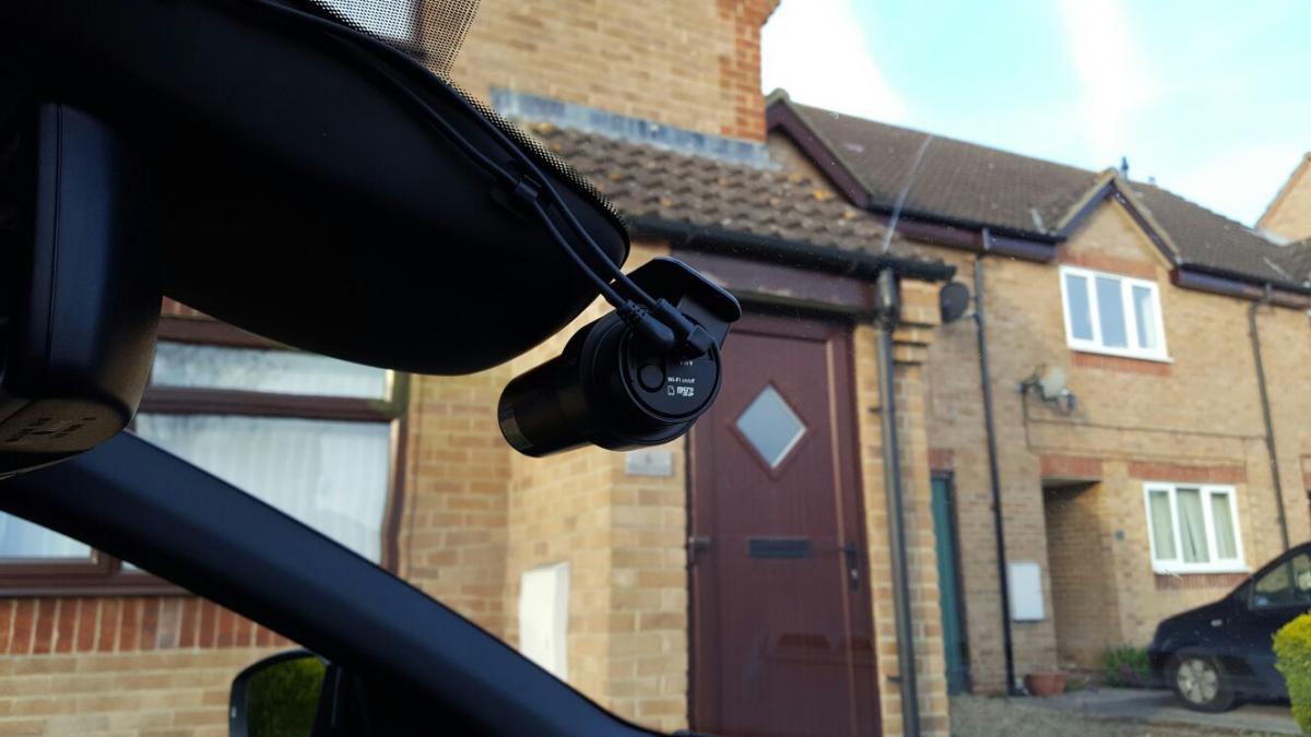

Blackvue DR650GW-2CH IR (with over the cloud) Power magic pro fitted behind glove box (as this seems to be the norm) rear camera wiring fed through with tailgate harness, small groove filed into upper tailgate trim to allow for wiring, then ran along headlining towards front camera.
Blackvue DR650GW-2CH IR (with over the cloud) Power magic pro fitted behind glove box (as this seems to be the norm) rear camera wiring fed through with tailgate harness, small groove filed into upper tailgate trim to allow for wiring, then ran along headlining towards front camera. post-72580-0-11972800-1462732769_thumb.jpgpost-72580-0-91336300-1462732792_thumb.jpgpost-72580-0-28076600-1462732815_thumb.jpg
Blackvue DR650GW-2CH IR (with over the cloud) Power magic pro fitted behind glove box (as this seems to be the norm) rear camera wiring fed through with tailgate harness, small groove filed into upper tailgate trim to allow for wiring, then ran along headlining towards front camera. attachicon.gifIMG-20160508-WA0003.jpgattachicon.gifIMG-20160508-WA0004.jpgattachicon.gifIMG-20160508-WA0002.jpg

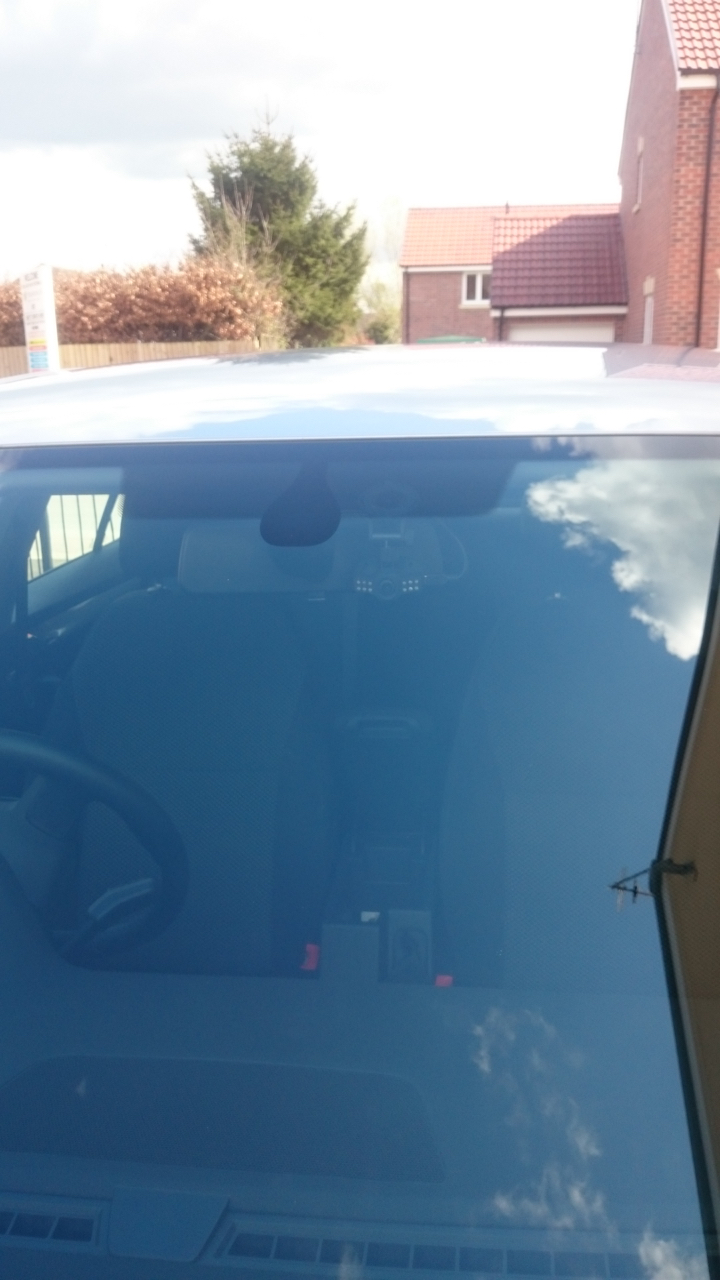

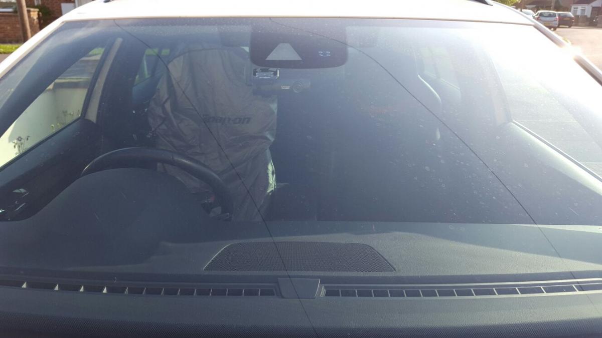

What does the front look like from outside?
I've mounted to the side of the mirror to keep it all as discrete as possible - view is a little off centre but even the Mrs didn't notice it and she knew I'd fitted it
I have lane assist so there was no way mine was gonna be discrete :(
Thanks for sharing that one - just what I wanted to see how it looked :)

Guys
Had a similar issue with my car. Managed to use the fuse that powers the airbag warning light on the dash. Turns out it's an ignition only fuse too
