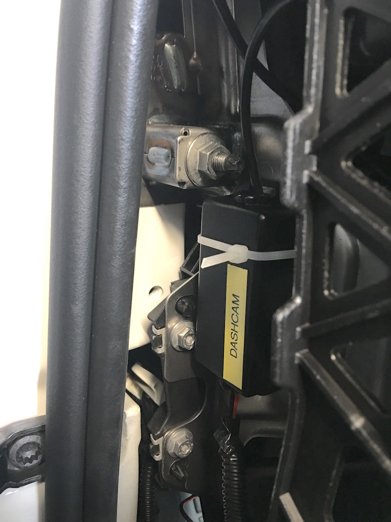

Hard wired my dashcams today, was surprised to find only one unallocated ignition controlled fuse position available. I bunged a male spade connector in it and connected, via two in line fuses, to auxiliary sockets to these, plugged the cams transformers into the sockets and bunged the whole wiring mess in a Tupperware box in the glove box.

I am running 2 cameras (1 front and 1 back) I have piggybacked a switched live feed into the glovebox where the charger sits with both camera usb leads plugged in (nothing plugged into the cigarette lighter type ports bit of this)
this has knocked off my DAB signal almost completely
any links for the charger bit that folk have used in an estate that doesn't affect the DAB signal? It needs at least 2 usb ports
thanks
I use the chargers that came with the RAC cams in a similar set up to yours except I hard wired the power rather than piggyback, and used female 12 volt accessory sockets to plug the chargers into - no DAB issues. Can only suggest checking your wiring runs where it passes close to the DAB aerial on my SE L estate this is the rear side window - I think, but may be wrong, that there is an aerial both sides.
Could it be that two cameras plugged into one charger is overloading the charger enough to cause interference with the DAB but not stop the charger working?
Edited by YMe
the interference happens when both cameras are unplugged as well which makes me think it is the charger in the glovebox. rf chokes have helped a little. I've just ordered a dual usb 12v-5v adapter off amazon for under a tenner to try instead

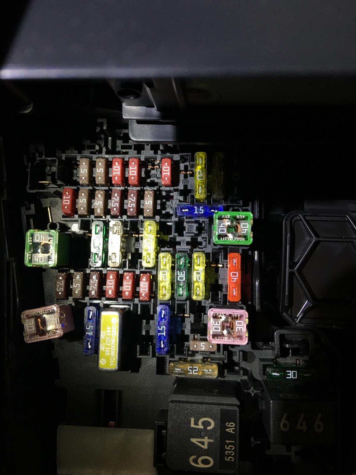

Had a nightmare getting the glovebox off today with a view to fitting my dashcam I took out of my previous car, however I have noticed that the circular connector that was at the end of the black ground cable has somehow come off:
In relation to this, I am wondering:
  • Which is the best fuse to piggyback on to?
  • Where is the ground point around the fusebox, and can I just unscrew and wrap the exposed wire cord around?
Also, with the sensors pictured below, will I have any trouble trying to install the camera in and around the mirror area?
Sorry for all the questions, hoping someone can point me in the right direction.
LD.
Well I have managed to use the fuse port 35 (HL beam adjust/camera/radar) for my camera and all appears to be working fine. It is not as covert as I would like, but it does not restrict my view as such and gets a good viewpoint. I will upload some photos of the setup and upload some drive footage tomorrow.
One thing I did notice was that I am missing fuse number 16 which is said to be for the signal amplifier for telephone, does this mean for the phonebox feature which I apparently have?
Edited by LaneDiesel
For the earth or ground you will want a fork crimp at the very least or a circle ring crimp ideally. There is a very handy bolt under the side cover that you remove to get access to the glovebox. Its highlighted elsewhere in this thread. I used the rear wiper fuse for a switched live if that helps.

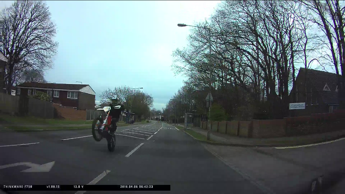

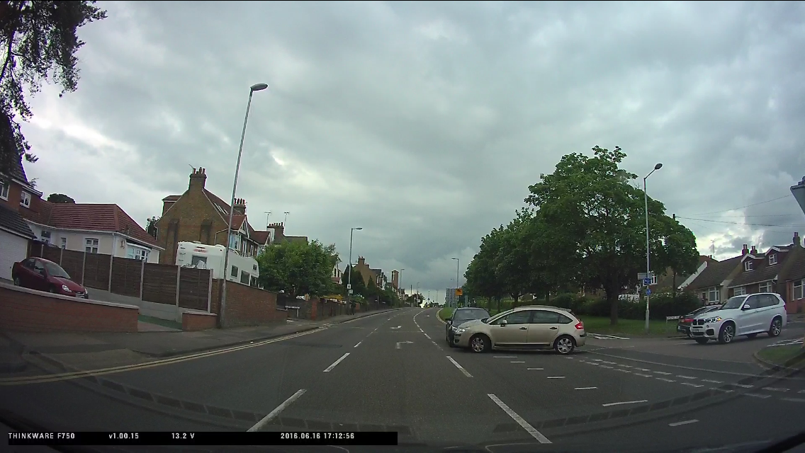

Slow moving vehicle footage:
Normal driving footage:
Rather happy with the install, even if the camera does appear to shake a little bit.

Hey guys
I've got an O3 with a fair few options, and after trying to use fuse 47 (rear wiper) I've found my fuse tap physically won't fit in as it hits fuse 50 (boot lid) on the way in. Turn it around the other way and it hits fuse 45 (operating seat adjustment).
I got a multimeter in there and it literally looks like only two fuses are ignition switched - 47 and 49, neither of which I can use with the fuse tap I have.
Has anyone else got any other suggestions?
Mike.
Hey guys
Mike.
Use the empty unassigned fuse slots, should be one for both live and switched live. You can get VAG fuse box connectors that slot in from behind (just like the OEM wiring) and connect to the devices wire, then you just use a normal fuse.
Thanks for the idea. Managed to find a switched fuse (don't know how I missed them yesterday) but hooked into 37 (headlight left). 36, 35 and 33 are also ignition switched.
