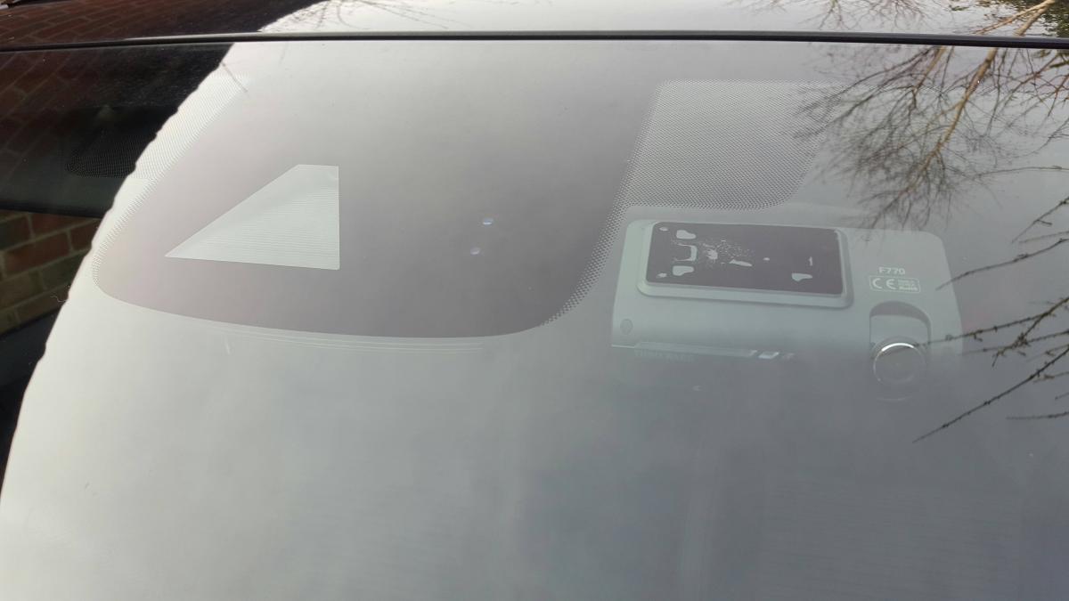

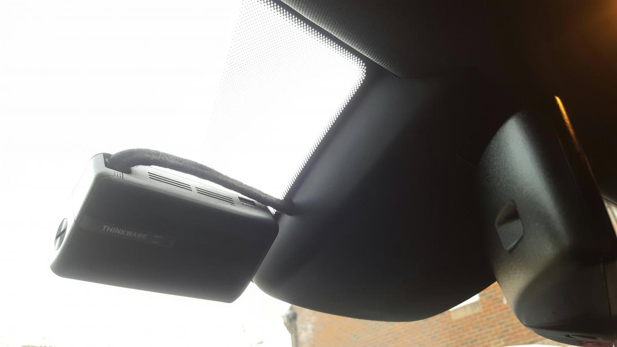

Thinkware F770 front and rear dash cam (vRS) Chickened out and had professionally installed! Would have liked central in windscreen, but apparently cabling would have been too cramped entering bottom of lane assist housing.
Edited by Maverick999
Have you checked the operation of lane assist (whether or not you use it?) since the dashcam was fitted, just in case they've upset the LA camera and disturbed the calibration when the took the cable into the housing?
No reason why it should effect the lane assist, I fitted my F750 along the same lines (I used the rear camera in the windscreen though as it is smaller):
That did cross my mind, but lane assist still works absolutely fine and housing's secure.

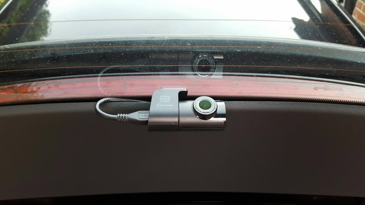

In the process of finishing off installing my rear Mobious. Doing at the same time as fitting the reversing camera. Taken power from the wires I put in for the rear camera with a 12v to usb converter, and the converter tied up under the boot lid trim. Drilled a hole for the USB cable to come out and into the camera.
Probably have to play around with the positioning of it as it needs to be off centre because the rear wiper will be in the way. So just using Velcro to hold it while I get the position right then will think about mounting it better (or not).
Will post photos when done.
Where is the lane assist housing?
The plastic cover between the rear view mirror and lane assist camera and wiper sensors. This plastic housing varies in size and contents depending on model of car.  As I chickened out and had the camera installed professionally, I'm not too familiar with the process of removing etc! :)
