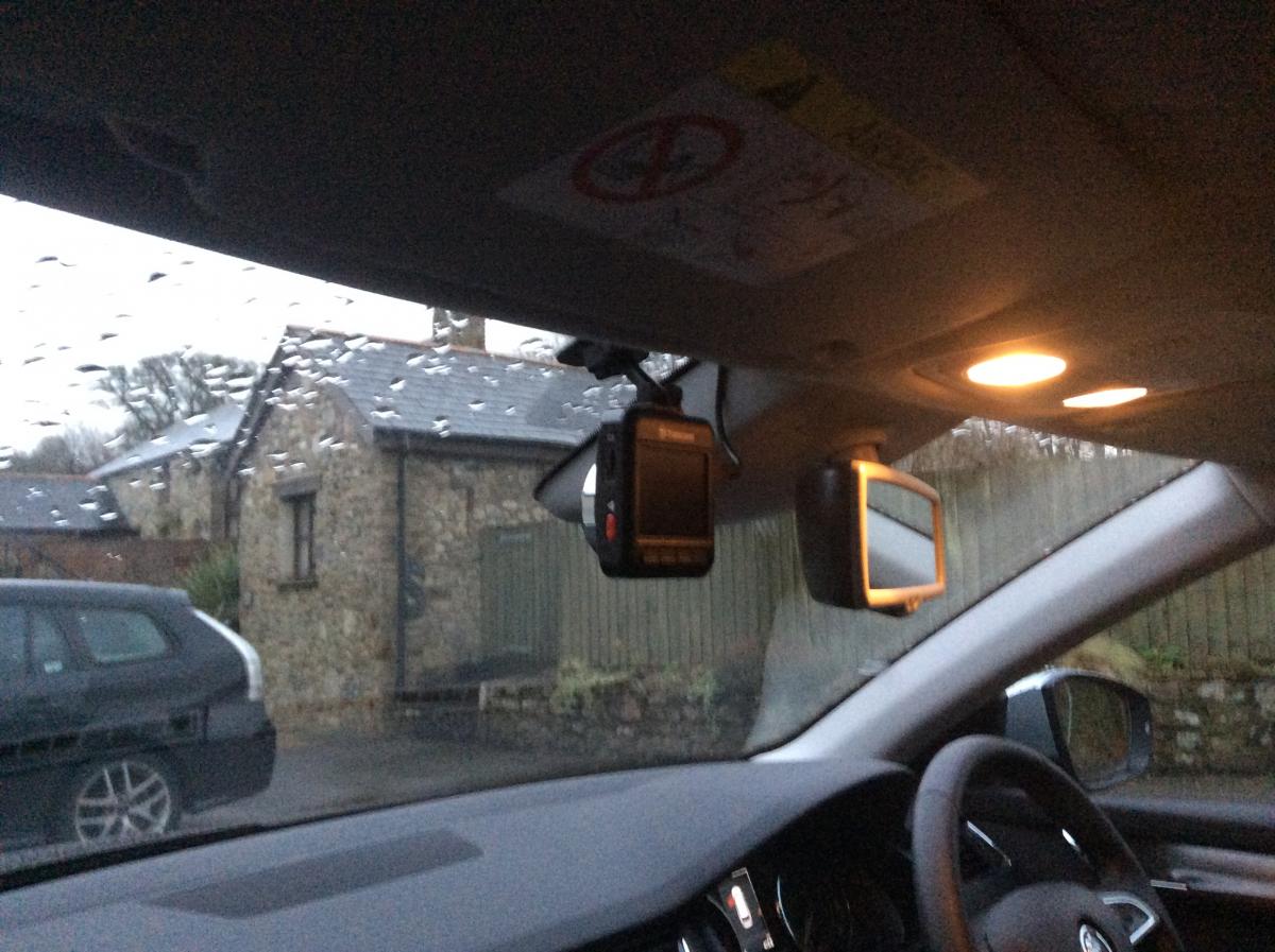

What can I do about my dash cam. It hangs down too much...
Anyone recommend a good compatible holder?
It doesn't look as bad there but irritates the other half as it blocks her view! In fairness it would be better a bit further up and more discrete.
This camera looks very similar to the mini 0806 so one of these should work just fine or if you want the mount with integrated GPS antenna try this.
Just check your model to make sure you get the right one but should end up looking something like this ....
Edited by Makefish
Thanks, that's the sort of thing I want but without the built in power point.
