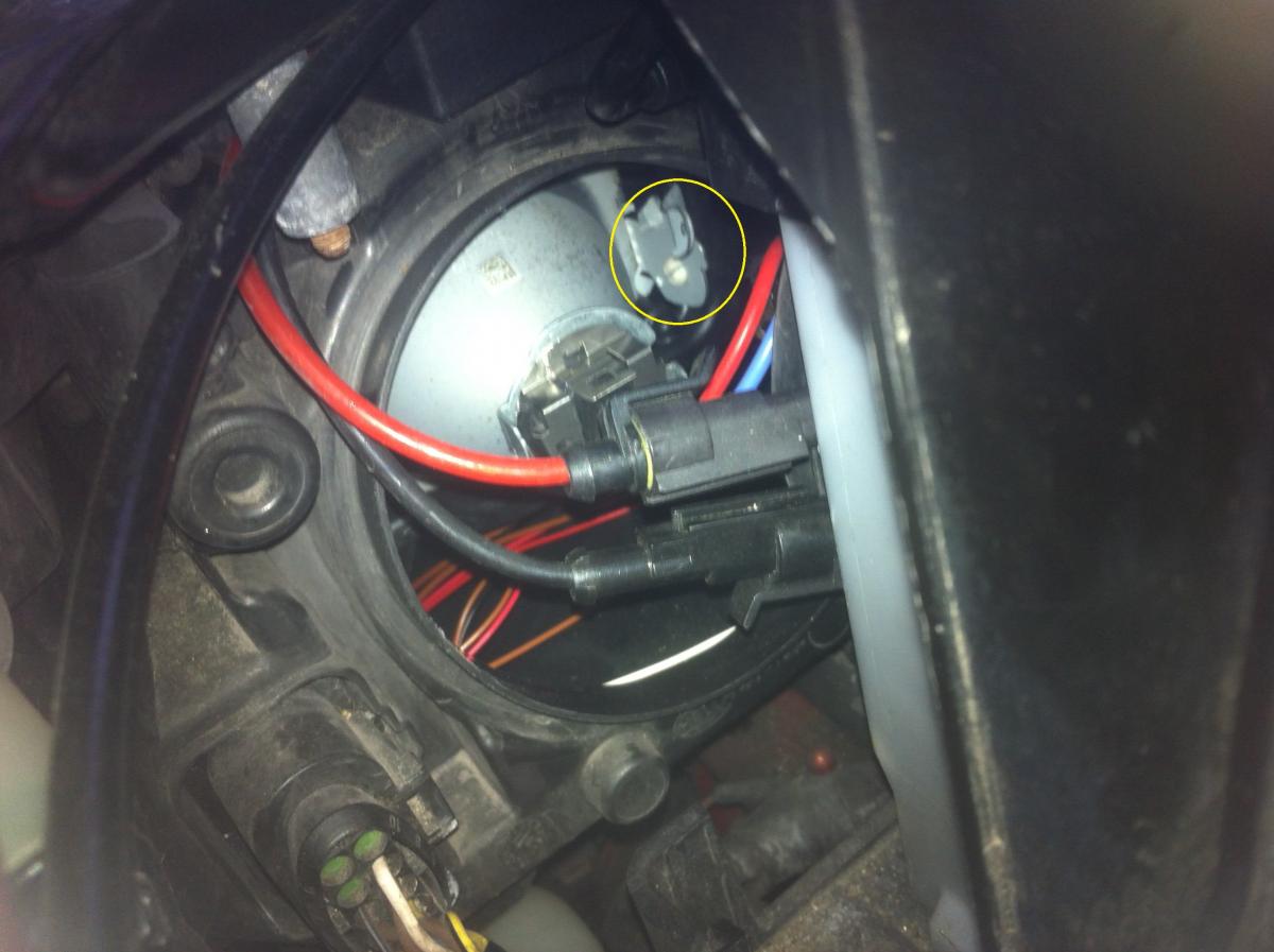

Good to meet you today and thank you for showing me the magic levers, unfortunately it looks like the later headlamp units are different, had a good look with a torch this afternoon and I cannot see a lever, I may have to resort to the stick on things :(

No probs...:) Have you checked both..? The dipped and main beam as I know mine uses one H7 bulb for both where yours has two separate ones...
Only dipped beam should have one though.

No probs... :) Have you checked both..? The dipped and main beam as I know mine uses one H7 bulb for both where yours has two separate ones...
Only 1 bulb and a shutter system to give you main and dipped maybe that's why there isn't a lever!
I've got the black pack lights, one bulb for dipped and main and I have the lever.

Where about is this lever
Sent from my SM-N9005 using Tapatalk
I couldn't see the lever when I looked yesterday jonro2009 and mine should be the same as yours. I was using a torch and looking into the back of the headlamp unit where the H7 bulb is fitted (in my case ) is it a case of you can't see it but you can feel it or am I missing the point completely?
I need to get it sorted as I'm off to Europe in just over a weeks time :S or it will have to be stick on beam deflectors.
Boys, here's a picture of the lever. Black headlights on my monte with the one bulb does all.
This is obviously looking from the back , drivers headlight as the lever is on the right. So if looking from the front of the car, it would be your left. :)
Edited by Sargentsiri
Brilliant, thank you, I should be able to find this now :)
No worries, the lever is only little so you gotta get your fingers right in there!
Good to see the lever, I've never seen it just felt it and flicked it.....then I forgot which position it should be in.... Oops
The lever was a bit stiff and actually felt a bit sharp so be careful.

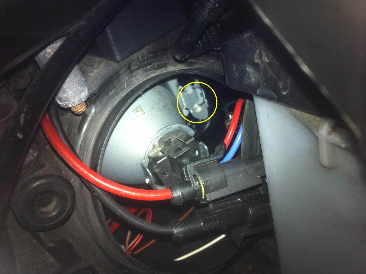

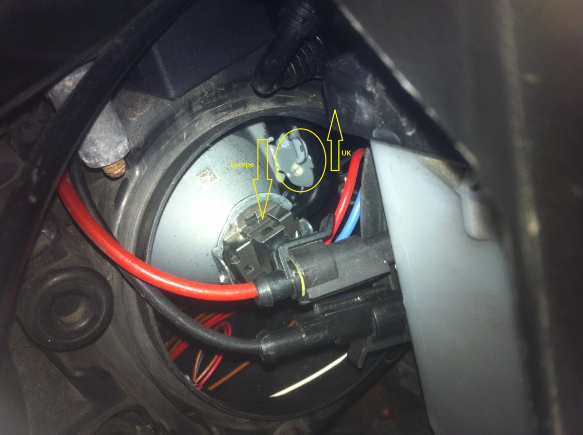

Sorry for being so late with these but here are the pics showing the lever (yellow circle) on the Projector Headlights...If you going to Europe and don't want to dazzle the others you need to push this down, when back to the UK remember to flick it up (Mines are set to the UK)...:
post-80790-0-49158900-1403650395_thumb.jpgpost-80790-0-50292900-1403650425_thumb.jpgpost-80790-0-03030600-1403650446_thumb.jpg
I hope this helps... :)
Matty
Huge thanks to Sargentsiri and Slotty for taking the time to produce photos of the inside of the headlamp unit showing the lever that alters the dip arrangement on projector headlights. :clap:
I still couldn't see mine (Black Units in a Monte Carlo) but with the help of the photos I could feel them and actually move them even with my big hands and sausage like fingers.
This will save me sticking on beam deflectors when I go to Germany next month for another reunion with the Nordschleife and the beautiful landscape of the volcanic Eifel Region and the Mosel Valley, I can't wait :)
