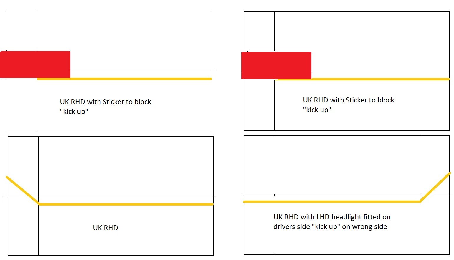

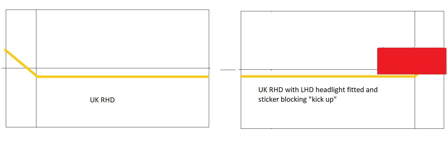

Please forgive me bumping an old thread but I have a headlight issue with my Monte and wonder if anyone can advise please.  Car was a Cat D before we bought it, with front end damage so may have had headlight(s) replaced.  Had MOT yesterday and it failed on poor alignment on driver's side headlight.  Garage reckon the headlight is actually a LHD version not for UK use (this is third MOT the car has had since the repairs and never picked up before).  I rang around for a quote for a new light and baulked at the price, so for now have fitted a stick on beam bender to get MOT pass.  I came across this thread with regard to the levers for adjusting UK beam for European driving and I have them on my car.  So in theory, if the drivers side is LHD light, would setting it in the "down" position be enough to make it RHD compliant, ie the opposite of a UK car being set for European roads.   Don't like the naff beam bender sticker as ruins the look of  the car.
Any advice appreciated, thanks
Edited by KernowMaid

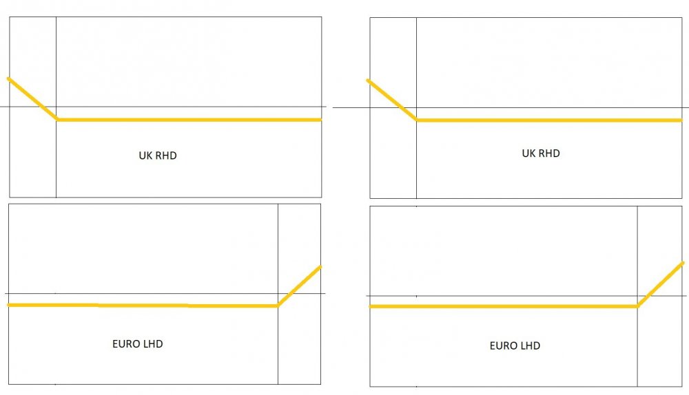

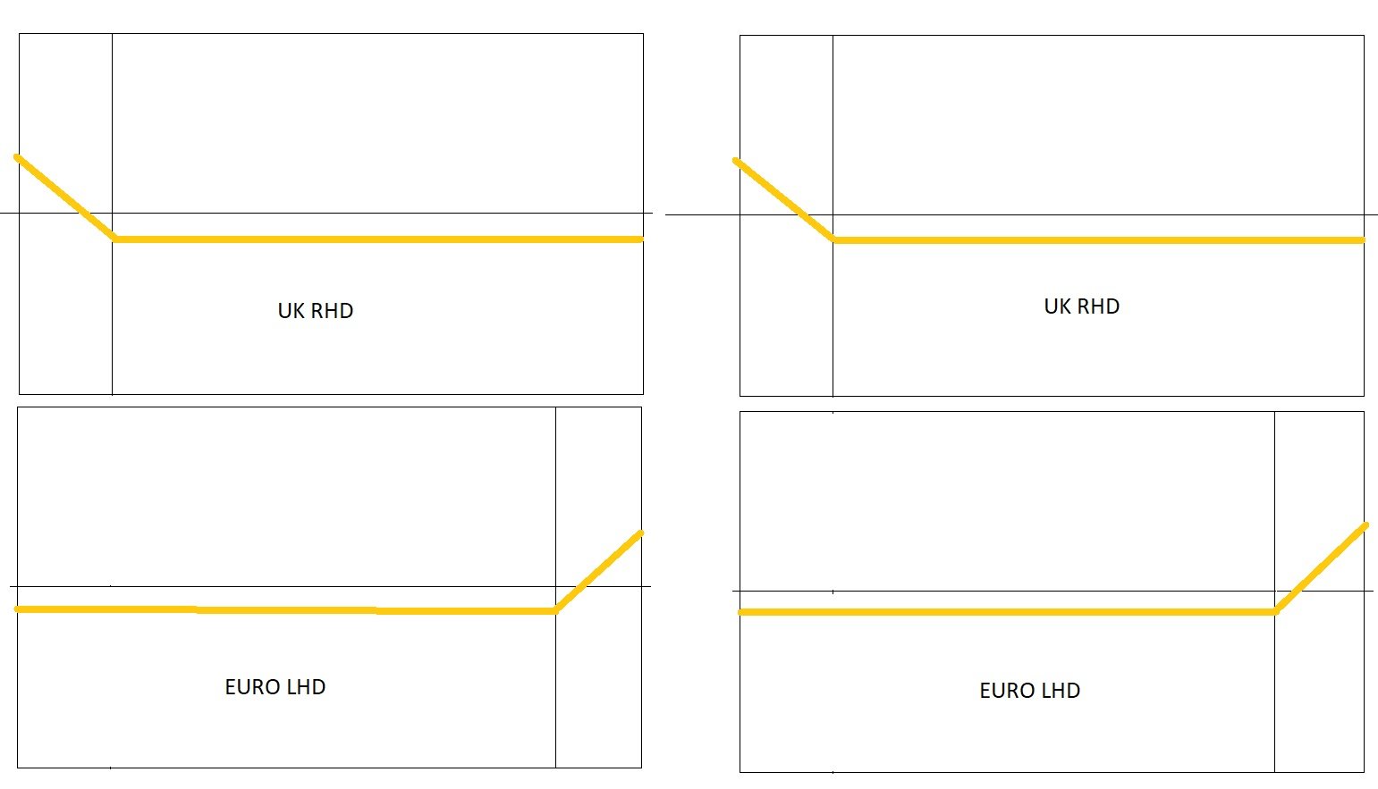

This is not much of an issue to sort..... I have done a few diagrams to hopefully assist in explaining.
Years ago UK cars just fitted stickers to block the "kick up" for european driving. European cars have headlights the opposite as Im sure your aware. Nowadays lots of cars have a simple lever to do the same job, now in all honesty I dont know whether some or all or which do it, but the lever can do 2 things :-
1. Block the kick up
2. actually fully reverse the image so kick remains but swaps sides.
So images below explaining what is should be and what you have....
The yellow line is the "top" of you light pattern.....
image 1 and 2 are how they should be for RHD and LHD cars..
Image 3 is UK car, no lever with stickers blocking kick up for European driving.
Image 4 is UK car fitted with LHD drivers headlight...
Image 5 is what you have now with sticker, either because the headlight IS a LHD version, OR because the lever is moved to the European version and it has fully
flipped the image.
So the last image shows what you have now...... so all you need to do is drive up to a wall or garage door so your about 3 feet away, best done when getting dark as its easier to see your light pattern.....
turn on the headlights and you "should" see the last image
If you "remove" the sticker and the kick up appears, flick the lever and see what happens, it needs to go or flip to be like the first image.
If it passed the MOT with the sticker fitted, the height must be ok, "if" when you flick the lever the height changes on the drivers headlight, just adjust it down to match the passenger side.
