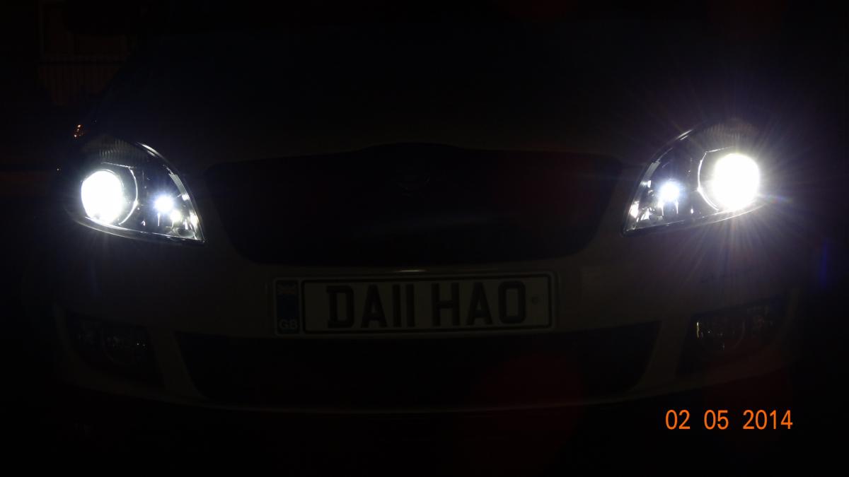

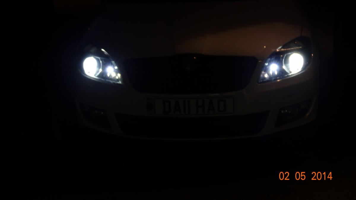

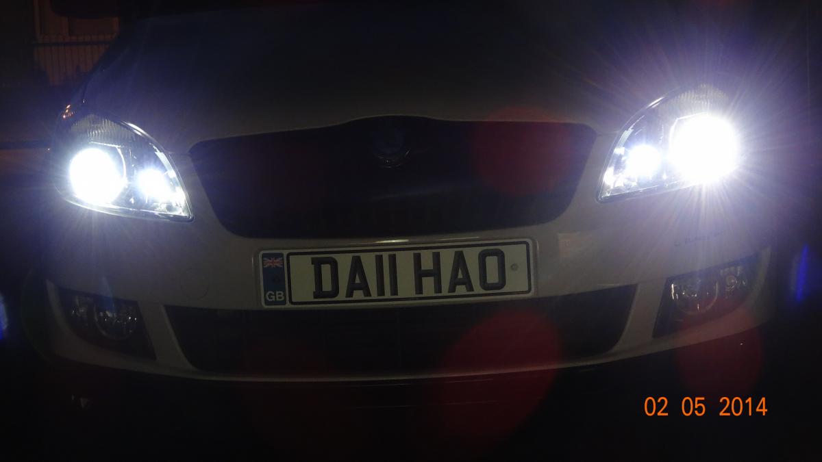

Thanks ryno, just been out to have a look and yes there is a small label I totally missed it must be getting senile , both say 5000k , so I wonder why both lights when on don't look the same.?
Had exactly the same feeling but trust me. It's just your eyes. Both bulbs match perfectly.

Thing is when H.i.ds looked at the pics. I sent , they agreed the bulbs did not look the same colour, if the wire made any difference I thought he would have asked me how I had installed them, will have a look when it gets dark , am wondering whether to swop  the ballast around and see if this makes any difference, if they still look the same in darkness
I agree that they look different colours in the pic but they are at slightly different angles, can you get a decent head on pic?
The return wire makes no odds to the light colour. It can throw a shadow on the road directly in front of the car that's all. If there is no shadow there is no problem ;-)
Sent from my GT-N7105 using Tapatalk
Its the bulb itself that produces the colour.
Maybe theyre different makes, or ones a dodgey one.
Im sure the replacement one will be fine :).
Is it me or what , the right hand one know looks brighter to me. will try the new bulb when it arrives  . Thanks everyone for replies.post-71068-0-06135300-1399062687_thumb.jpgpost-71068-0-28925800-1399062712_thumb.jpgpost-71068-0-11779500-1399062731_thumb.jpg
