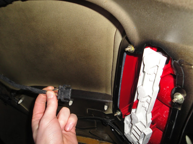

Loom install nearly done:
Just a few issues:
Anyone identify the whatyamyjig:
Plenty of space for a battery:
Electric boot release?
Thought so. The Ibiza had one too, but it was in the rear door rather than on the body... looks like I've got some wiring to do.
Convert it to a manual one? Less to go wrong
Its already got a manual override connected to lever near the drivers seat, so yeah, if lazyness takes over that's an option :) My key has a boot open button though and it would annoy me if it didn't do anything.
