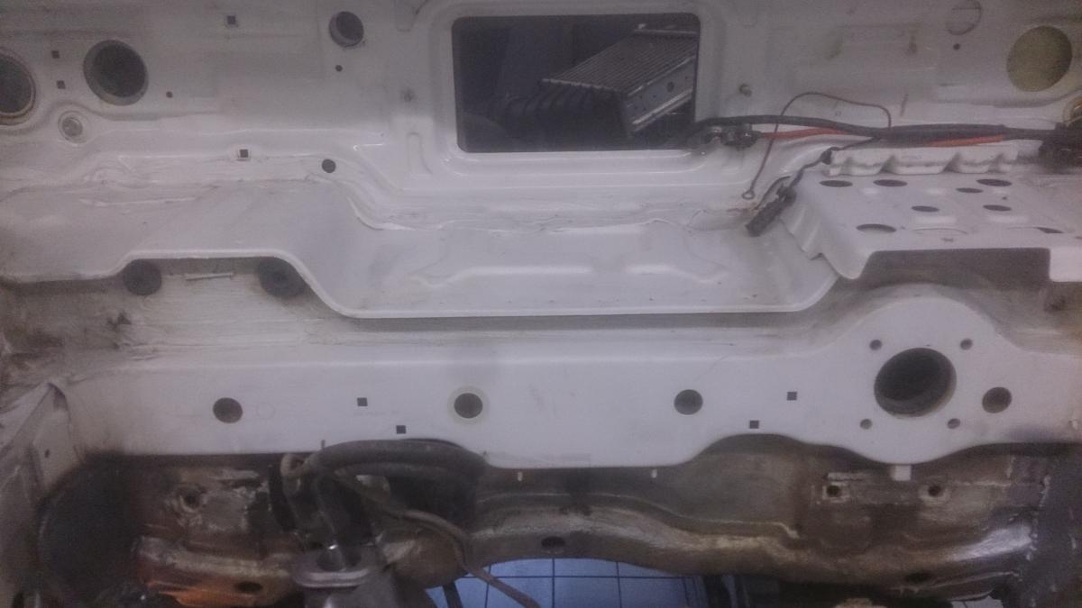

Been a while since we updated, Christmas holidays have meant not alot of action, however, we have the engine back out, mounting plates for engine finished and both front subframe mounts finished, just in the process of prepping the engine bay for paintpost-110371-0-13493100-1420298184_thumb.jpg
