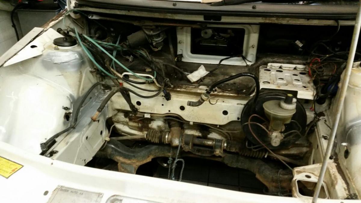

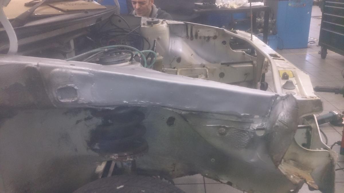

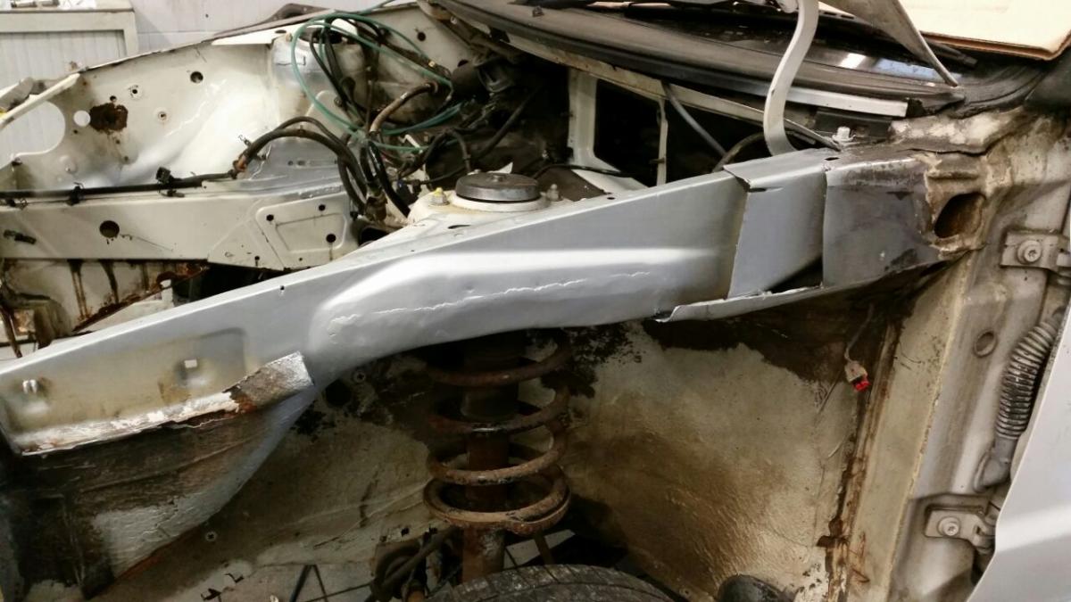

post-110371-0-82482600-1415459275_thumb.jpgpost-110371-0-99795900-1415459611_thumb.jpgpost-110371-0-97959200-1415459633_thumb.jpgpost-110371-0-44507800-1415459664_thumb.jpg
crikey, those inner wings are some of the worst I've ever seen
Which ever genius owned it before fibreglassed over the rot, nearside is sorted and looks good

So the plan was to have the engine ready for mounting this week, but the rot needed more attention than first thought. Finished the repairs at the front end, now to start what we set out to do.

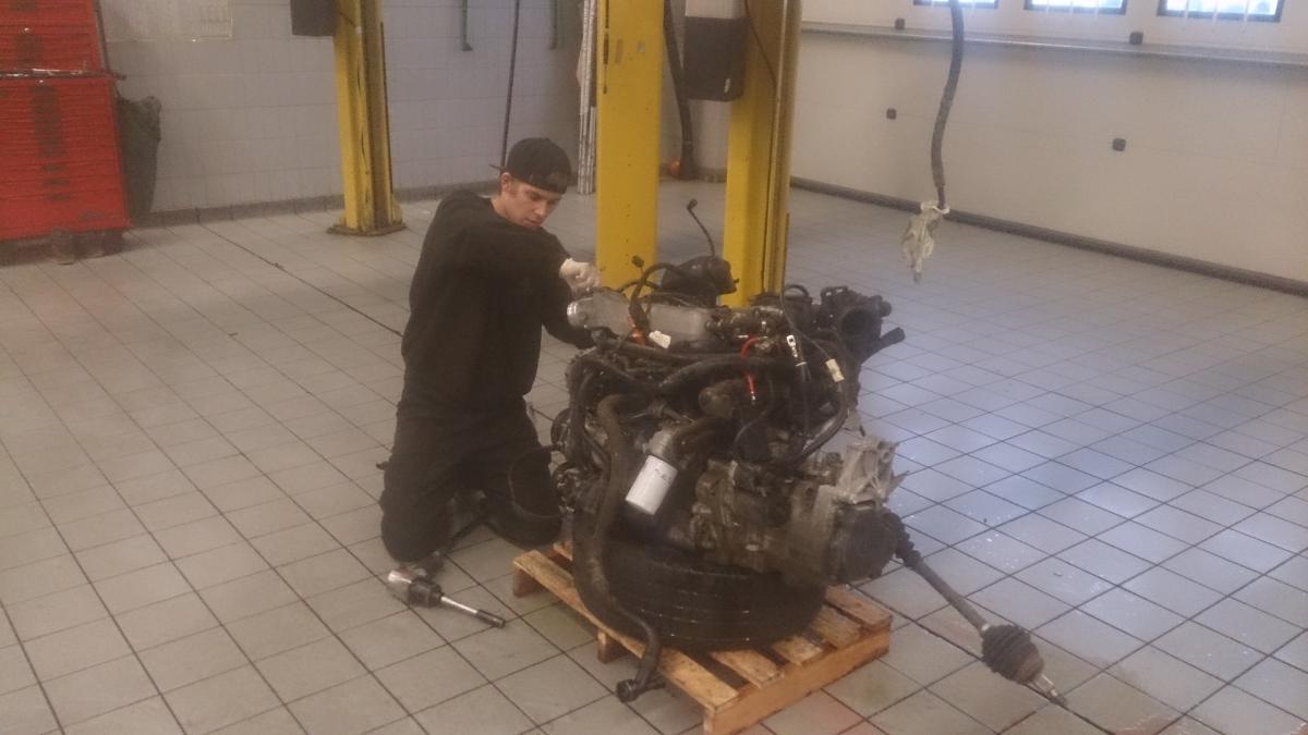

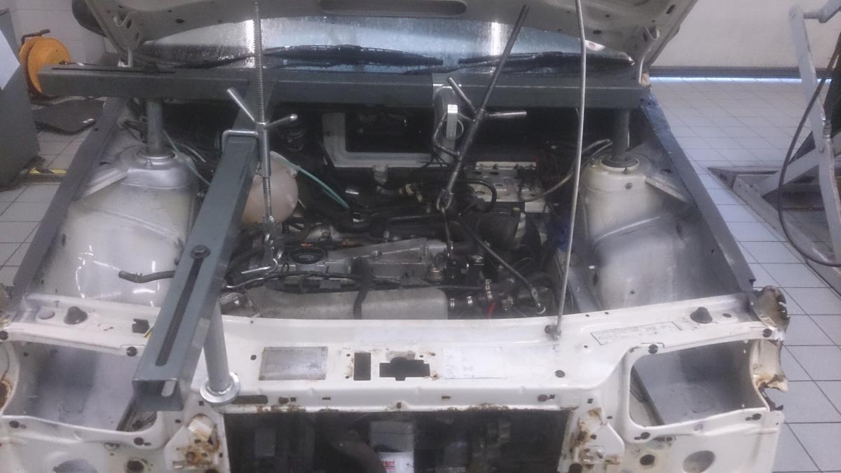

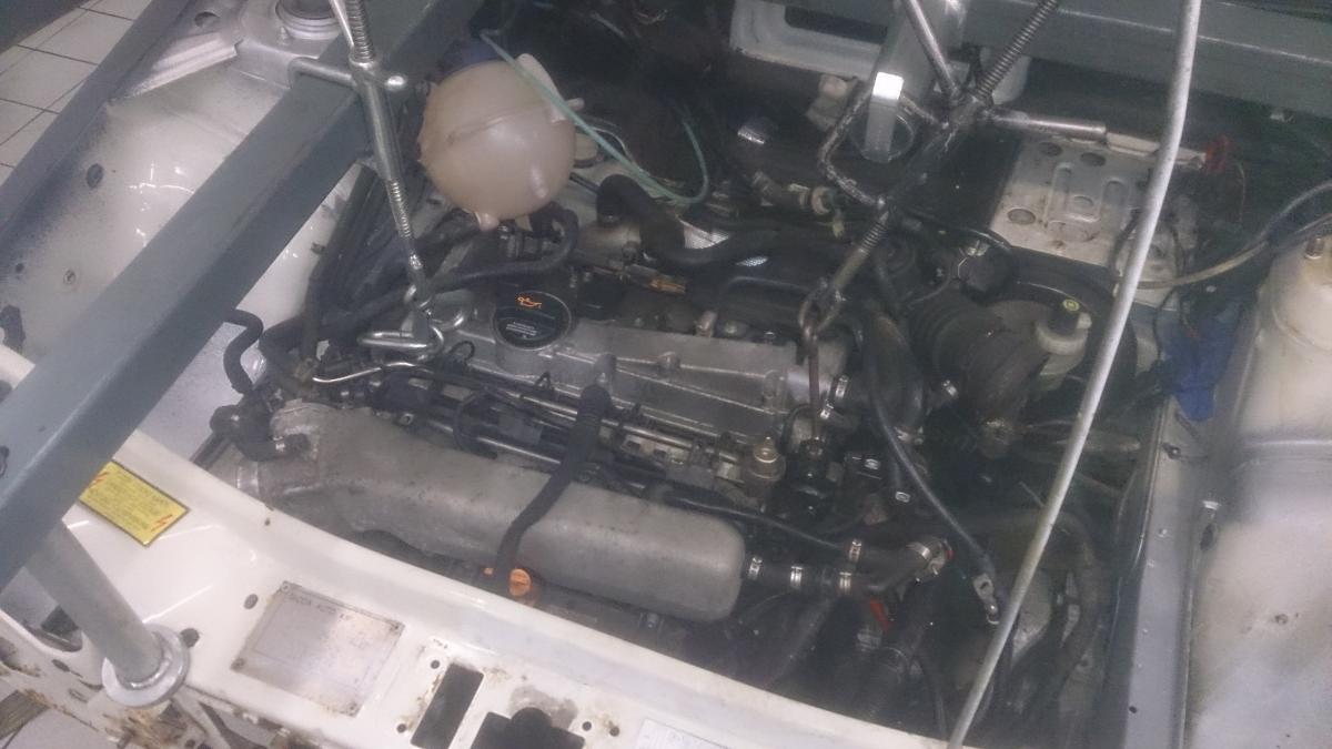

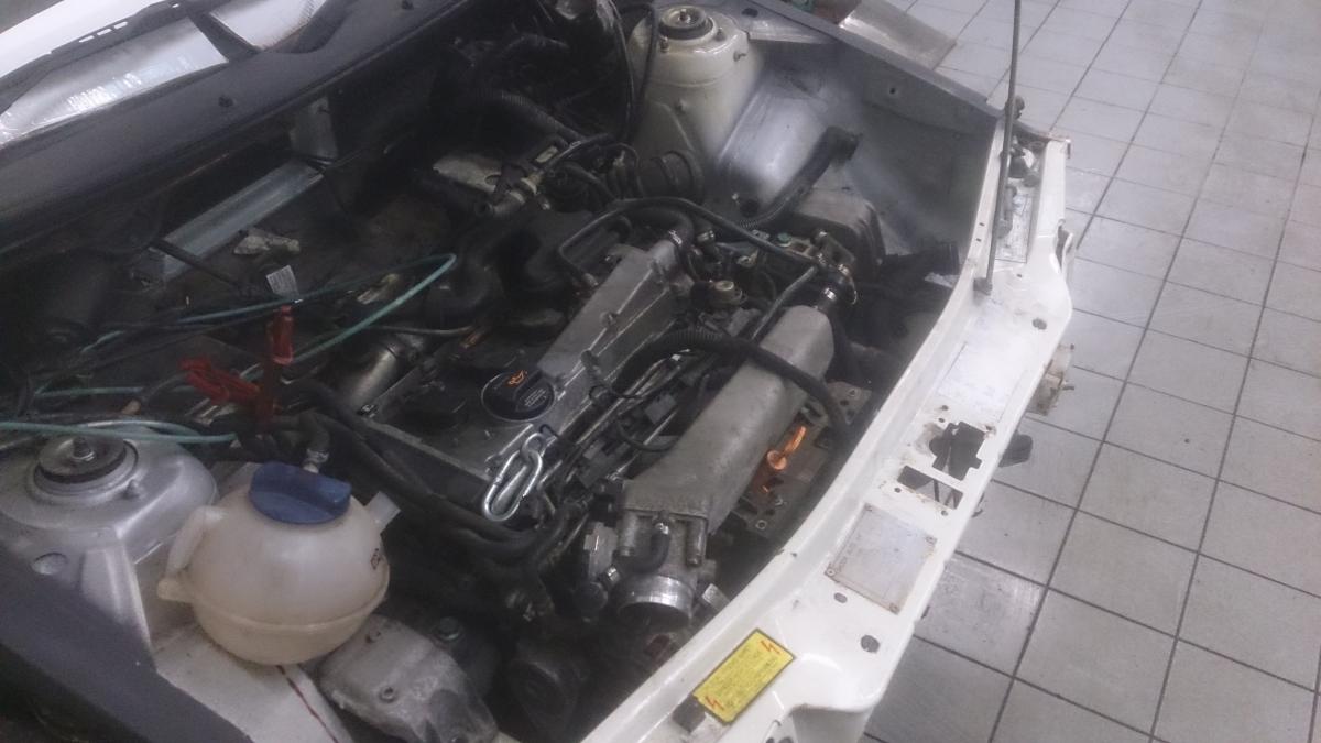

Big morning thanks to jamie (technician at hortons) engine was out and mounted in place, surprising at how well it fits, it went in the pickup easier than it came out the octavia
Custom gearbox mount made this morning, and installed, engine sits perfectly level as it did in the octavia.
