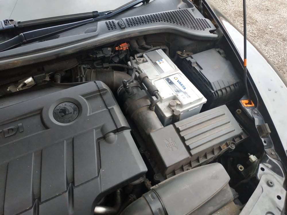

The Scout almost didn't start a couple of days ago, Bitten the bullet and ordered the Varta E44 from Amazon. £67.95 delivered. First impressions are its much more powerful.
Mark
Indeed it is Mark, I have the Varta E44 fitted to my 2.0PD and I only paid £70 ish delivered last year. My wife also has one in her Seat Altea XL 170 which has more gadgets than mine, it has more than enough oomph for the job and for future tech mods.

The Varta E44 and Bosch S5 (same battery, different branding) are very well respected and proven batteries.
Remember you need an 096 (size / fitment) for the MkII Octavia.
096 should be ample for a MK2
Make sure you get the highest cca and ah you can

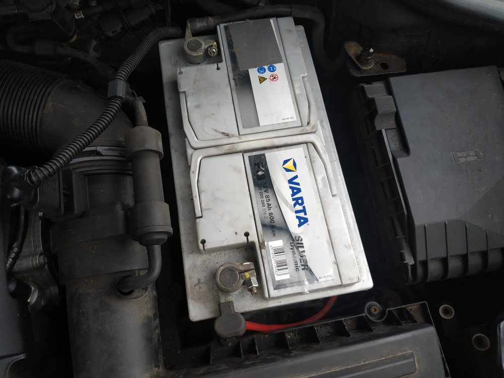

So I've been having a couple of small issues lately.
If the car is sat for a day or two when you start it it's very rough when turning over but starts fine but just doesn't seem as instant as previous.
Hot starts it feels even rougher.
While sat with the radio on and engine not running a couple of times I've had a warning pop up on the Columbus warning me to start the engine to prevent the battery from dying.
Often if I'm sat with the ignition on and engine not running and stereo on for a few minutes when I start the car again it idles at 1000rpm and the battery voltage showing on the maxidot is under 14v.
I put a multimeter on the battery and it read 12.4 volts which then dropped to 11.9v with the ignition on. It read 10v while cranking.
Took it into quickfit for a free battery test and the printout report came back that the battery was fine with 96% starting capacity remaining (whatever that means).
I've ordered a new battery anyway as I don't trust the kwickfit printout.
Got a Varta E44 (same as the Bosch S5) for £67.50 with free delivery arriving tomorrow.
Phil
100% a failing battery.
100% the reason I'd never set foot in a Kwikfit.
It's the original battery (going on for 8 years old now) and the same as you had fitted to yours (the weak 340CCA one). The little "magic eye" thing on top of the battery is black too which also adds to the case of a dud battery.
For the sake of £68 I'll stick a new battery in and I'm pretty confident it will sort it.

It did the 1000rpm idle again this evening after being sat 5 minutes copying some music from the SD to the HDD on the Columbus. Also sounded dog rough when starting. Will have the new battery in tomorrow all being well.

Please excuse what I suspect is a newbie question. My 1.8 TSi (DSG) has a huge box, and I suspect will easily accommodate the E44 referenced above. But I'm slightly concerned at alarm codes, etc, being reset on replacing the battery. Is it really as simple** as disconnecting/reconnecting?
Many thanks,
Mike
**ignoring cleaning, greasing, liberal application of swarfega and ripped knuckles...
Yes it is that simple, the dash will light up like a Christmas tree when you turn the ignition on after the change but a quick drive up the road resets all the systems and extinguishes the lights.
No issues with the alarm or stereo code.
The only thing you will have is a power steering light- just drive and it will go straight out.
You will then need to manually raise and lower all 4 windows to reset the auto down/up feature.
Your trip computer figures will be reset.
That's it.
It will definitely accommodate the E44 096 battery. All the battery trays and boxes on the MK2 Octavia are big enough for this battery.
