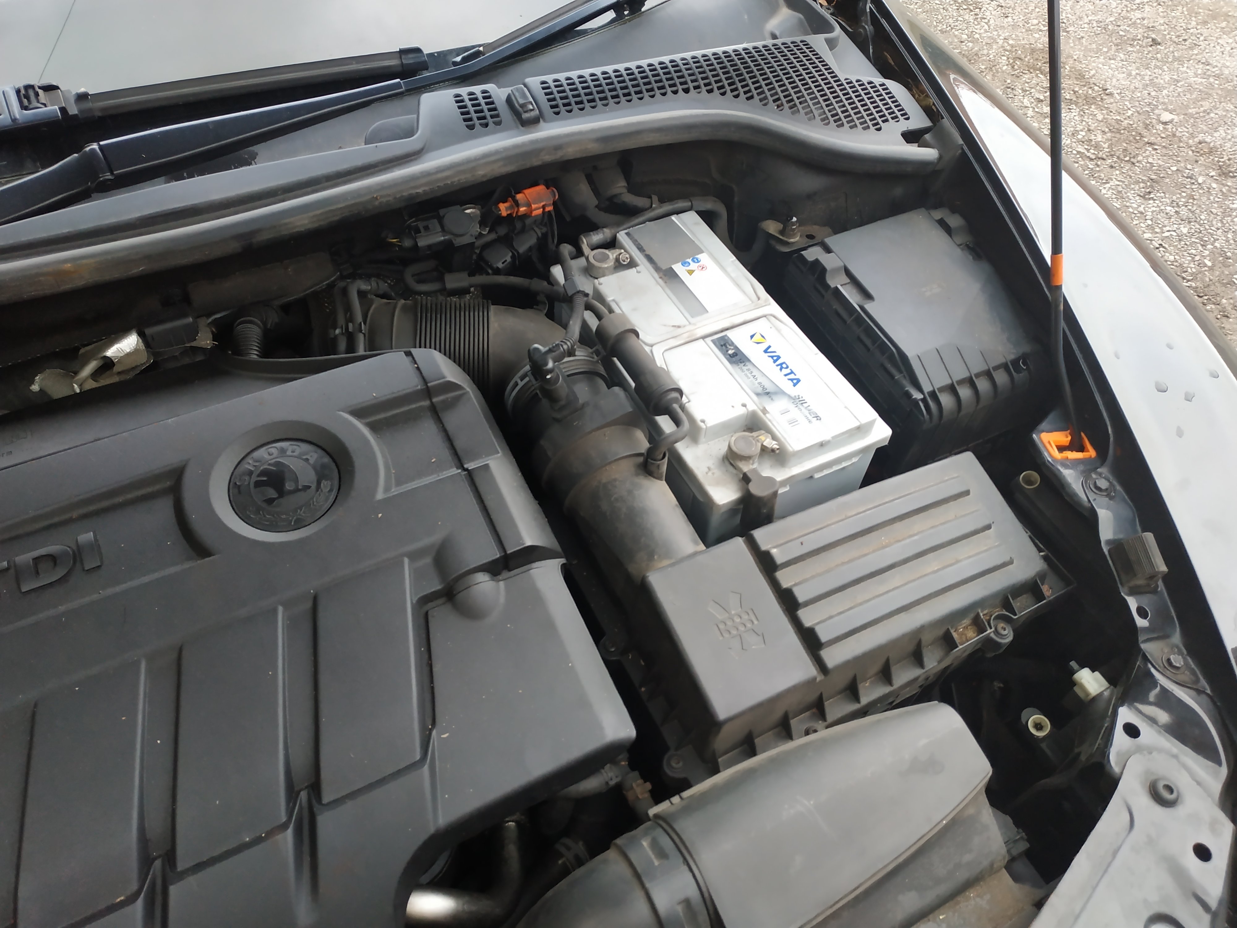

Thread necromancy, but it's possible to fit an f18 varta battery that's 315mm long. Only basic DIY on the tray required.

I generally do short journeys and my car is sometimes not started for a few days,. I do use a ctek charger but returned from a weekend away to a flat battery, so fitted one i'd bought for a previous car which used to do the same(until I fitted this bigger battery).

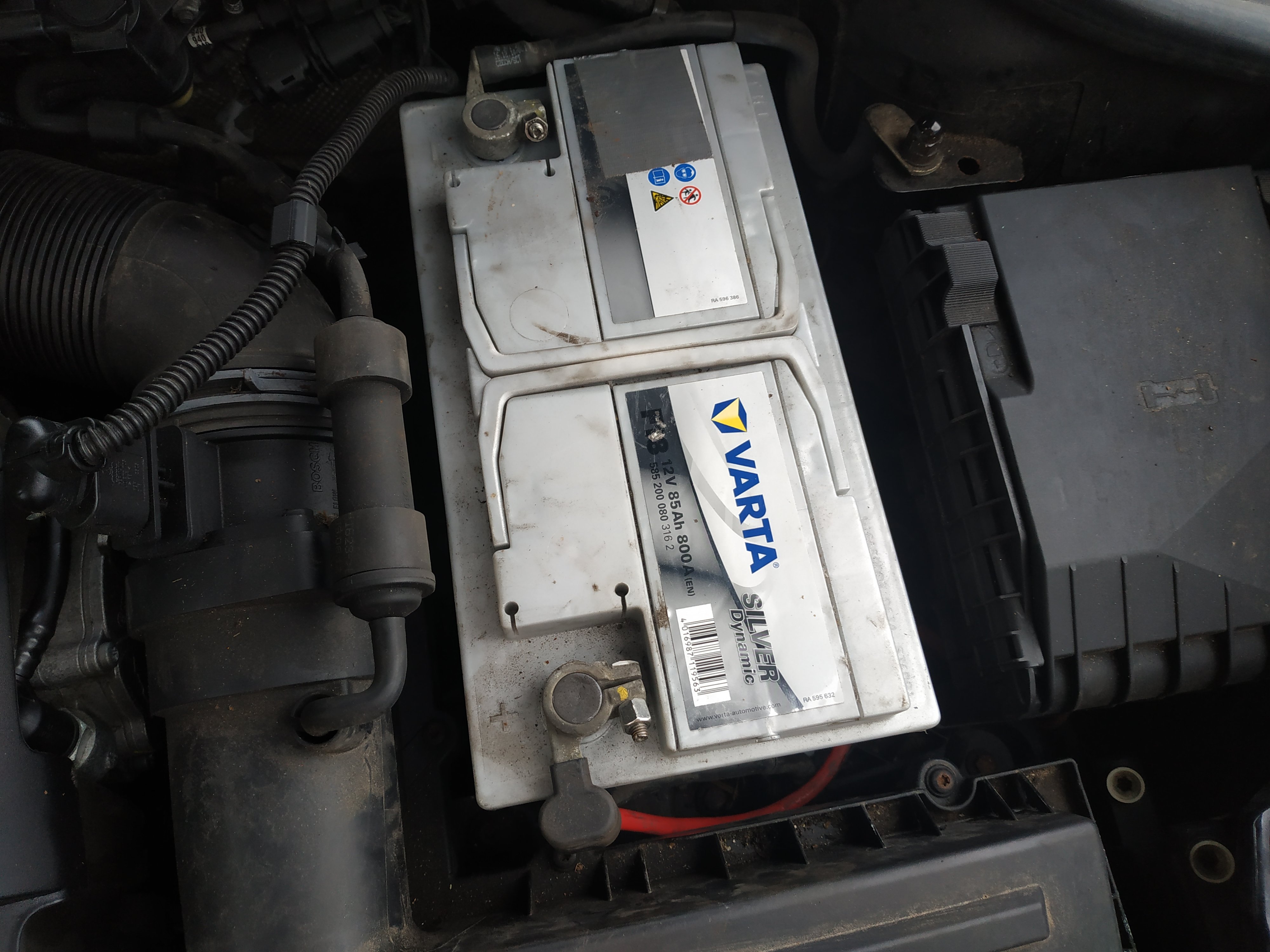

The Octavia VRS does have a small battery really as standard (only a 60ah and 600cca iirc). Upgrading this will help with starting but unless you have extra drain on the battery upgrading it is a waste of time.

Yep, I put the wrong unit up before. It's 85ah and 800cca.
