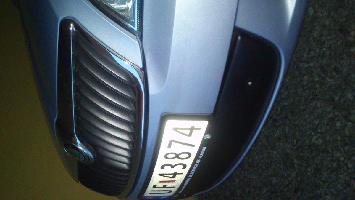

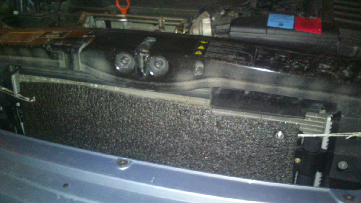

I think that the cooling system of the 1,4 TSI is designed to circulate in engine internally until thermostate opens. In addition I suspect the engine produces little heat to the coolant water. I found that adjusting AC heat to max. (red) was better than setting temperature. In addition I restricted the air flow through the radiator by covers, the lower grill with panel cover from Superskoda (upper exists also). I made my own.
It became a little better, but still not optimal.
