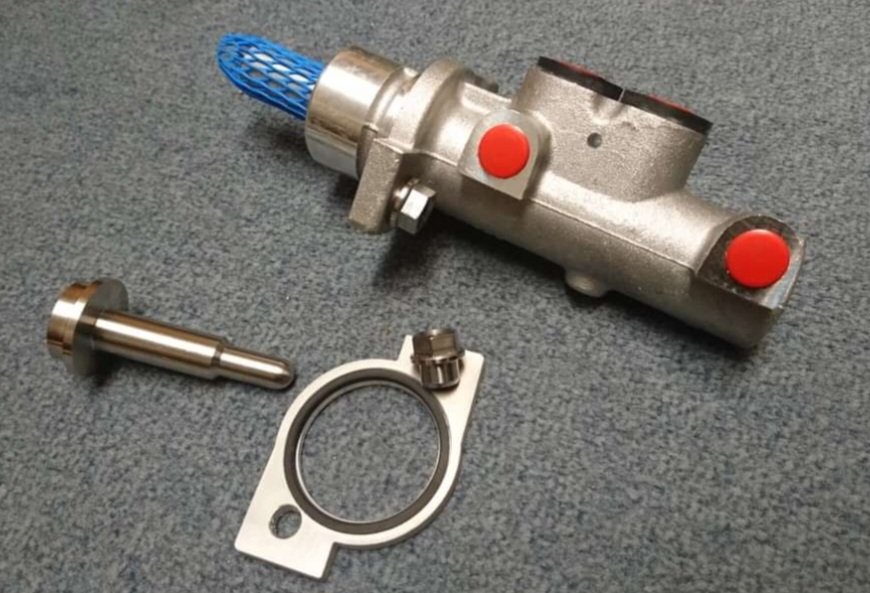

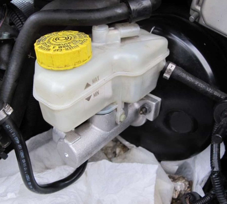

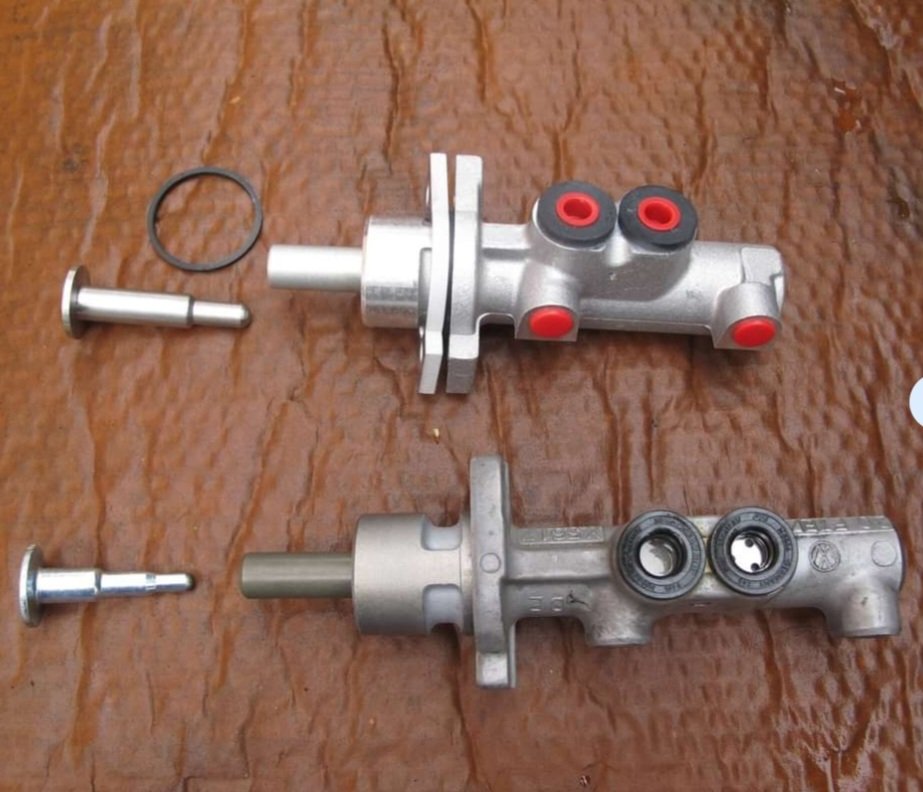

Included is a picture of a guy who offered master cylinder upgrades with these parts. 23,8 mm master cylinder, plate and tappet with small nuts in order to fit. According to many comments it made a big diffrence.
1.Picture fitted on car
2. Picture:
- top new 23,8 mm master cylinder
-bottom old 20,6 mm master cylinder
3. Parts needed
Edited by Tim497
