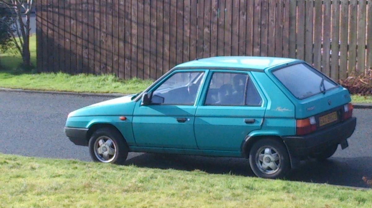

My first project - GAZ the Favorit
Are you sure the NSF door didn't buckle as you exceeded the 35mph??  :giggle:
I'd be fixering up the RWW if it were me - you know's it makes sense.
Nice project opener post  :thumbup:
Gaz

Well done Jon. Paint colour is Carribean Green 5280 if that helps, should look better with a T cut and polish. The wheels are off a Silverline they are wider than normal. Just take the wiper off they are prone to packing up, stick a gromet in the hole though.
Thanks Ken, good info!
