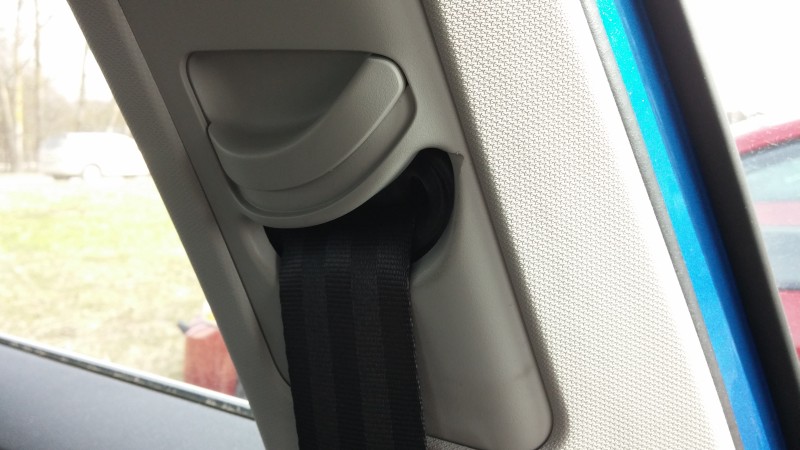

B-Pillar cover - damaged by seat belt.
At polish Octavia's forum, many users claim the B-pilar wear by the safety belt.
In my VRS this is not appears yet, but I would like to know Your observations.
It looks like bad design - in other cars this problem is not existing.
The dealers are saying to the customers, that improper belt using is the rootcause, but I don't think that people changing their usual methods with car change.
Below some pics, from cars not older than 1-2 years and mileage 3000 - 10000 km:

  • On those photos the adjuster is all the way up an the wear is in an upward direction as if the seat belt is being being pulled up towards the roof for some unknown reason. . Not sure me why people

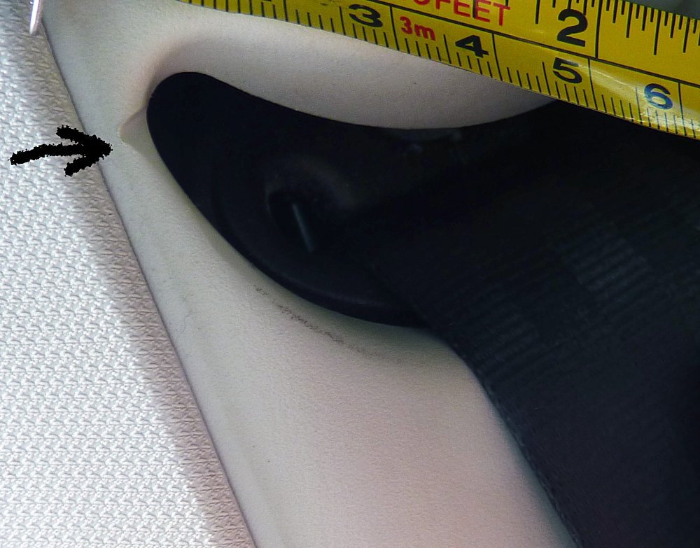

Biggest danger could be that the seat belt is also being damaged..
Suggest keep alert for seat belt fraying at that side where it rubs against pillar edge..
Not sure me why people expect the manufacturer to be responsible when something clearly isn't being used as intended or designed.

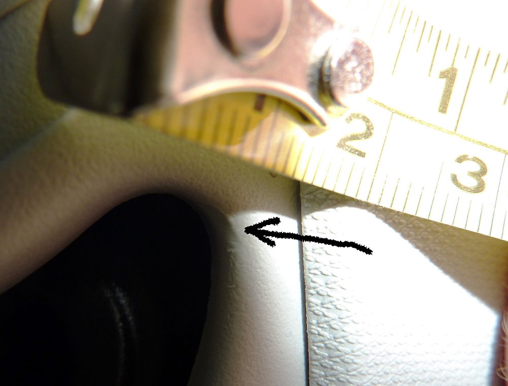

I had similar damage on my old A6 but that was 11 years old, occasionally the belt would get gripped by the slot and the edge of the belt became furry. Not enough wear to cause concern though.
Seat position could play a factor in the wear. The previous owner was a fairly short woman, so the seat would have been very far forward.

I wouldn't say it is improper use of the seatbelt, more likely it is the wrong 'technique' they are using.
Are the people complaining about this extremely tall or, ahem, Chubby? It looks like they have been pulling hard and in an upwards direction as if to get the seatbelt out to its full extent.
Perhaps the people who submitted the photos could film themselves using the sea belt as they would normally and then people could determine whether it is a design or user fault?
A v strong edge of woven nylon being pulled at speed across a piece of fairly soft low heat resistant plastic....gonna rather be like a knife through butter.
My wifes Astra H has a bit of this damage evident, but she is quite short and also pulls and retracts her seat belt at about a million mph so not entirely surprised. A tiny bit of evidence of this in my O3 probably from the odd occasions she uses it.
TBF the design just isnt that great, use of better quality plastic and a larger opening would prevent it altogether I expect.

Just checked mine and the seatbelt has eaten a bit of the plastic too. I don't pull the belt out with excessive force and it does not even touch the "corner" this when putting it on, but when I wear a winter jacket and take off the seatbelt, I have to pull the belt away from my body - when going back like this, the it is eating the plastic. The car is almost a year old and has done 15k km.

You'd have to pull the belt parallel to the door all the way and only then move over the body in order for the belt to make contact with the adjuster and cause any damage. But I have read on some German forums where "a lot" of people seem to have the problem.

Mine is the same as the bottom picture, drivers side only. Car is only 9mths old and has 9.5k on the clock
