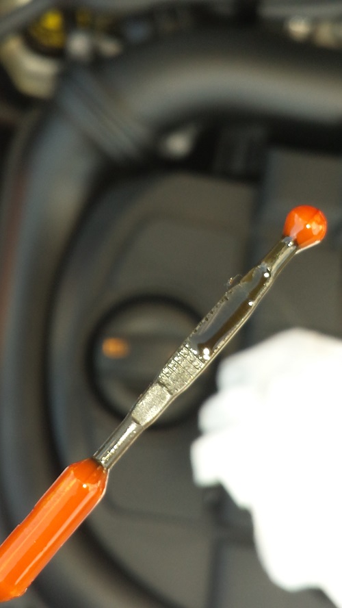

Dip the oil when cold & car on the flat, so before you start it.
Oil should be at top of the cross hatch, a little above on the flat bit is good, should not be up to the orange marker.
When home and oil cold next morning, dip again, same thing, hopefully oil where it was at in Manchester.
So when stone cold top of the Crosshatch.
Down the cross hatch too low when cold.
