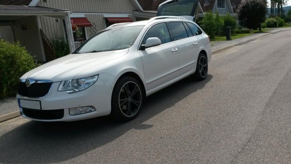

Since it´s time to replace my stock suspension i´m going to purchase new ones. The car is in my opinion quite high of the ground and the space between the wheel and fenders is about 7cm and it makes 18" look small.... I would love to take it down about 3-4 cm. Ofcourse i know it´s a family car and it´s supposed to be this way but i still want it a bit lower to the ground
As you can see in the picture the 18" looks so small with the big gap between tyre and fender. Looks a bit wierd  :D
The setup i´m thinking about is good old "Bilstein B4 + Eibach springs". This will run about 330-350 gpb which is abut what i want to spend. This will be about 3cm lower according to Eibach. I know the B4 are for standard replacement and the B8 would be better suited for the job. But since i´m not lowering it that much i think the B4 will suffice.

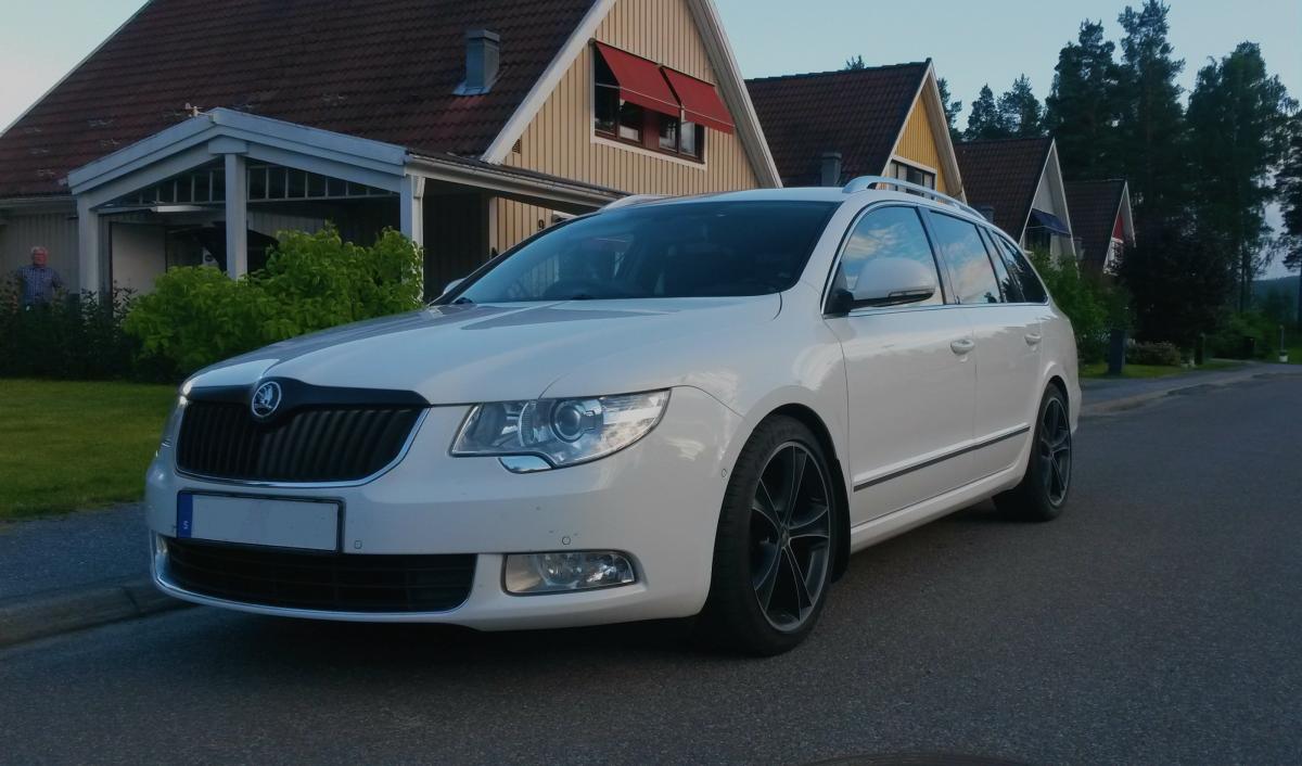

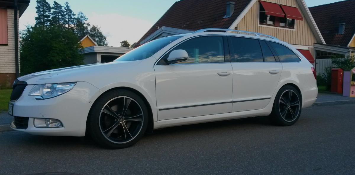

Done!
Had some problems getting the B12 kit so i ordered a AP Coilover kit. After two adjustments to the height i got i to work just fine! The car feels much more responsive and stiff.
Here are some samples.
Looks fantastic...glad it rides well too.
