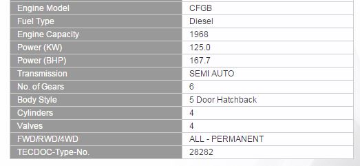

In fact if I put mine in the registration look up at work it comes back as a "semi-auto"
