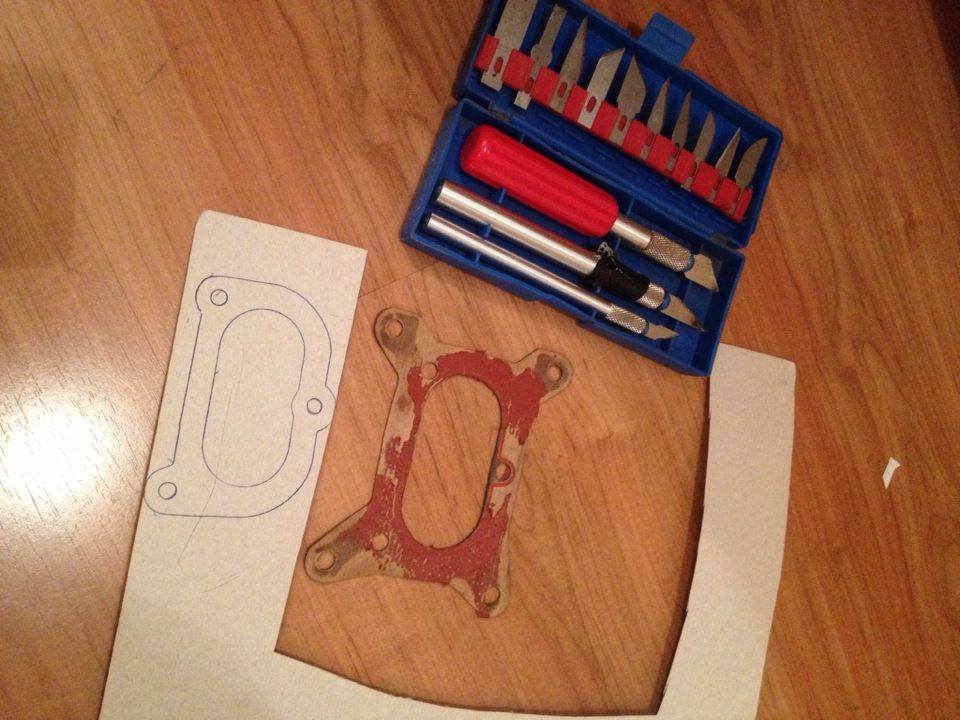

I can try that to make sure it's straight. I already out on a new one, as the old one had no rubber left on the bottom and was dried out.. I did slightly lean on the carburettor to see/hear it makes any changes in revving, but it didn't.

Oh yeah... vacuum leak. An engine can't idle with the idle fuel channel blocked by the shutoff valve. Unless it's a vacuum leak.
The carb looks cleaned recently (more or less). It's the usual scenario. The owner wants to clean all that gunk inside carb, takes out  the carb and cleans it on his kitchen table. Nothing wrong so far. But once the carb is removed, the vacuum seal is disturbed around the base gasket. As cooked as it might be, years of driving 'sealed' any gaps with dust, dirt, oil, etc.When installed there is no way that will seal again. The rubber of the gasket looks like stone or like charcoal.
So now you know why that happens. You need a new base gasket and some special silicone. I have always used REINZOSIL because it is fuel and heat resistant. Have a close look at all vacuum hoses too. Take one at a time out and bend it to check for cracks.

Actually, when the carb was off, I have replaced the base gasket with a brand new one... That's the current one.
