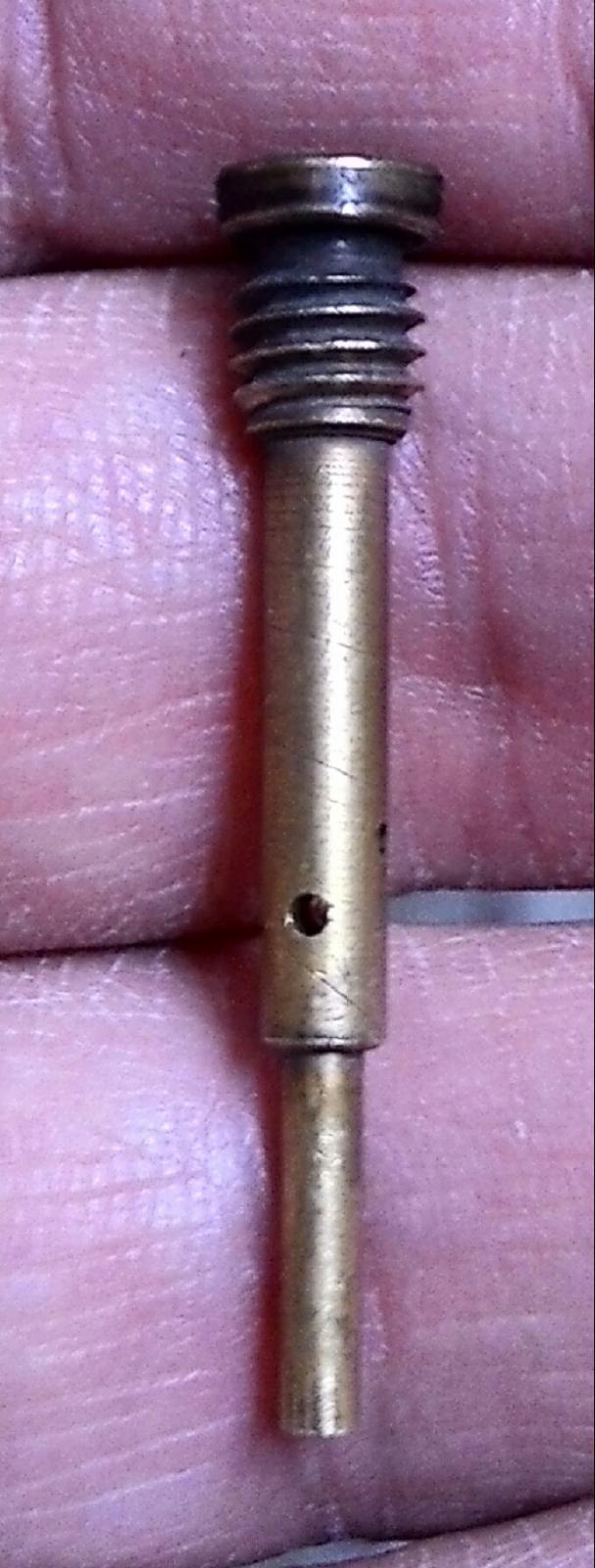

Hi Ricardo
At last i found one problem : idle fuel air jet is faulty ( the on in the photo ) . the narrow tube is long , it should be short . replaced it with new one with a shorter narrow tube . now when i turn mixture screw all the way in , engine doesnt stop running , but it runs in low rpm . at least i can set mixture screw very much better than before .

It is hard to give you more advice when the carburettor is a mess and I don't have direct access to it. You should 'thank' the previous owner for the nightmare he left you with. It is quite understandable why your patience is close to an end. My patience is dying very fast too.
I witnessed many times the frustration of people having problems with the carburetor on Felicia. Some wanted to drop their car from a cliff. Some wanted to set their car on fire. But after I cleaned the carburetor, set it back to factory settings, and solved the vacuum leaks, the owners wouldn't sell the car for any sum of money. I don't want to sound that I do wonders, everyone can do the repair / setup if they follow the instructions in service manual. I just want you to know that I've seen people going from agony to ecstasy only from this type of carburetor.
In your case, things are tougher probably because people are used to swap parts from other cars or 'tune' their engines according to various experts or popular beliefs.
In your particular case, hoping the carburetor has now all its correct parts (!), my only guess is there are still vacuum leaks. I base my diagnostic on your observation that the engine doesn't stop with mixture screw all the way in.
