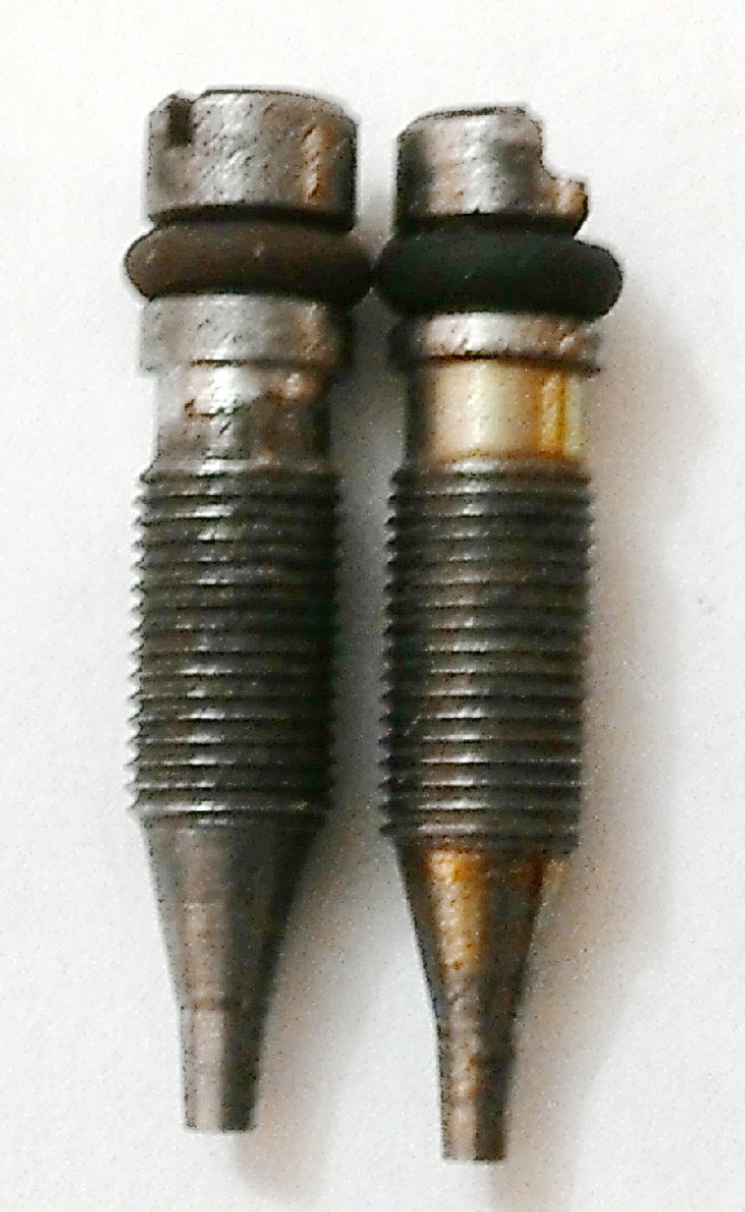

hi Ricardo ..
finally i found where the problem is : mixture screw , i had to change it two months ago , because it was broken as you see in the photo , i brought another one , and discovered yesterday that it doesn't block the mixture when it's screwed the whole way in , you can see the difference between the two screws in the photo , now i'll look for new screw that fit in my carburator , i wish to find one ,
thank you for your help
