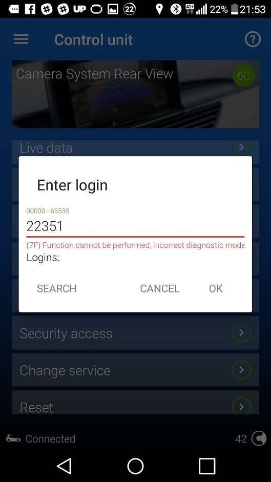

Does anyone know the security code for 6C Back-Up Camera?
20103

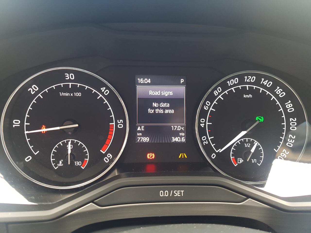

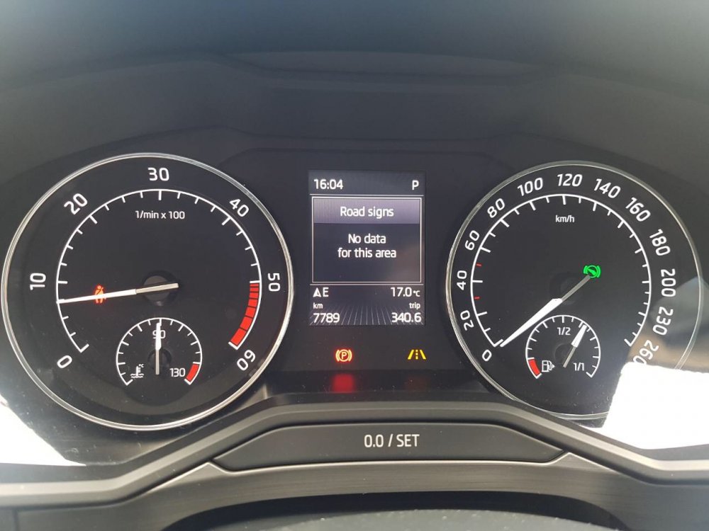

Ok let me inform regarding my results :) i have activated refuel quantity, offroad mode, throttle response to audi, lane assist, door lock on slam etc.
i have activated also traffic sign recognition however i have following remark ( see photo).
i dont know what the problem is. Does anyone have experience for this?
Worth to mention that i did not activate the following code hence there were no option in my superb

gony have you tried driving the car?
Not all roads have TSR data for them.
Yes gizmo i tried driving the car in city and in highway. I also pass the border to see if it will work in neighbor country but no luck. I have passed several road signs though. I don't know if is something related to the region or something is missing in my coding.
Were you in Serbia? Because in Serbia TSR does not work. Tested.
In fact i am in Kosova and also traveled to Albania to see if something changes. I will give a try to Macedonia or even to Bulgaria or Greece in next weeks. But i was sure that was something that i have done wrong and not something region related
If you will go to Croatia try it there, in Croatia definitelly works.

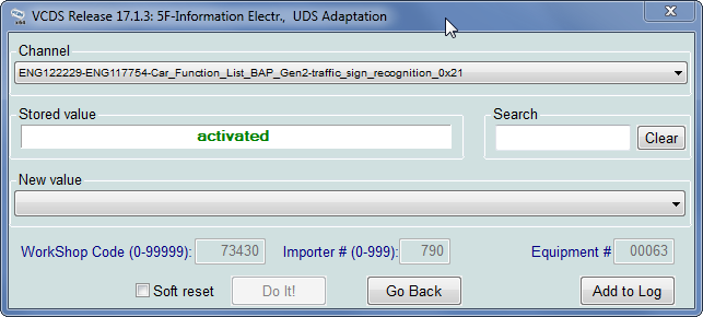

Controller 5F (Information Electrical)
10 - Adaptations
Select channel: (63) Car_Function_List_BAP_Gen2-traffic_sign_recognition_0x21 & Channel: (151) Car_Function_Adaptations_Gen2-menu_menu_display_road_sign_identification
Mine are showing slightly different but both activated OK

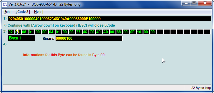

Controller A5 (Front / front view camera)
07 - Coding
Byte 1
Bit 0 Enable - "01 traffic sign recognition (FTE) active"
58eb652df2a7e_2017-04-1010_40_37-VCDSRelease17.1.3_SelectControlModule.png.22b54658b94ce7d27f3a1bd45b8c9631.png

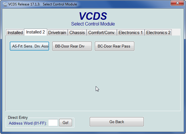

Not having any luck with this at all. Firstly it doesn't show as 'Front /Rear cameras' and is displayed as 'Frt Sensor. Driver Assist'. After selecting as instructed am getting the the following.
58eb64fe98694_2017-04-1010_41_54-Ver.1.0.6.24-3Q0-980-654-D_22Byteslong.png.9a292c5c3623151e82fce74ad4b45324.png
As you can see there is no option to select anything on Byte 1. I have checked through all other options on this controller and there is nothing resembling 01 coding_VZE Coded. I did consider changing Byte 1 value from 4 to 5 which would set bit 0 to 1 but didn't in case it messed something else up. On checking Byte 0 as instructed it just gives you a list of different VAG car models, though Skoda Superb Limousine  & Combi was on the list.

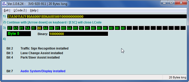

Controller 17 (Instruments)
07 Coding
Byte 5
Bit 2 Enable - "Traffic Sign Recognition installed"
58eb6a20bb520_2017-04-1010_45_26-Ver.1.0.6.24-3V0-920-911_20Byteslong_c.png.d40c9b1415dd01bb1e5f6aa83386ba4c.png

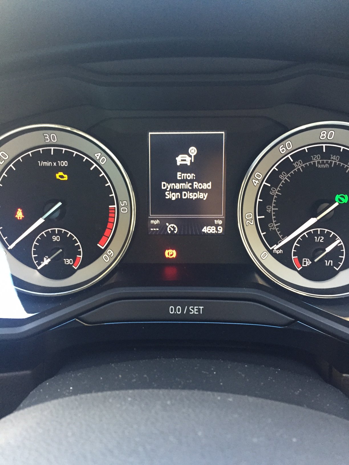

Selected bit 2 as instructed and this activated OK but got the following message on the maxidot
each of the other steps appeared to go OK but the end result is its not working. Any suggestion would be gratefully received.

TSR on Superb 3 is in Controller A5 not in byte 0!!
TSR must be activated in byte 16 bit 4.
If you change something in the first 4 bytes in Controller A5, in worst case, you delete the calibration of the camera

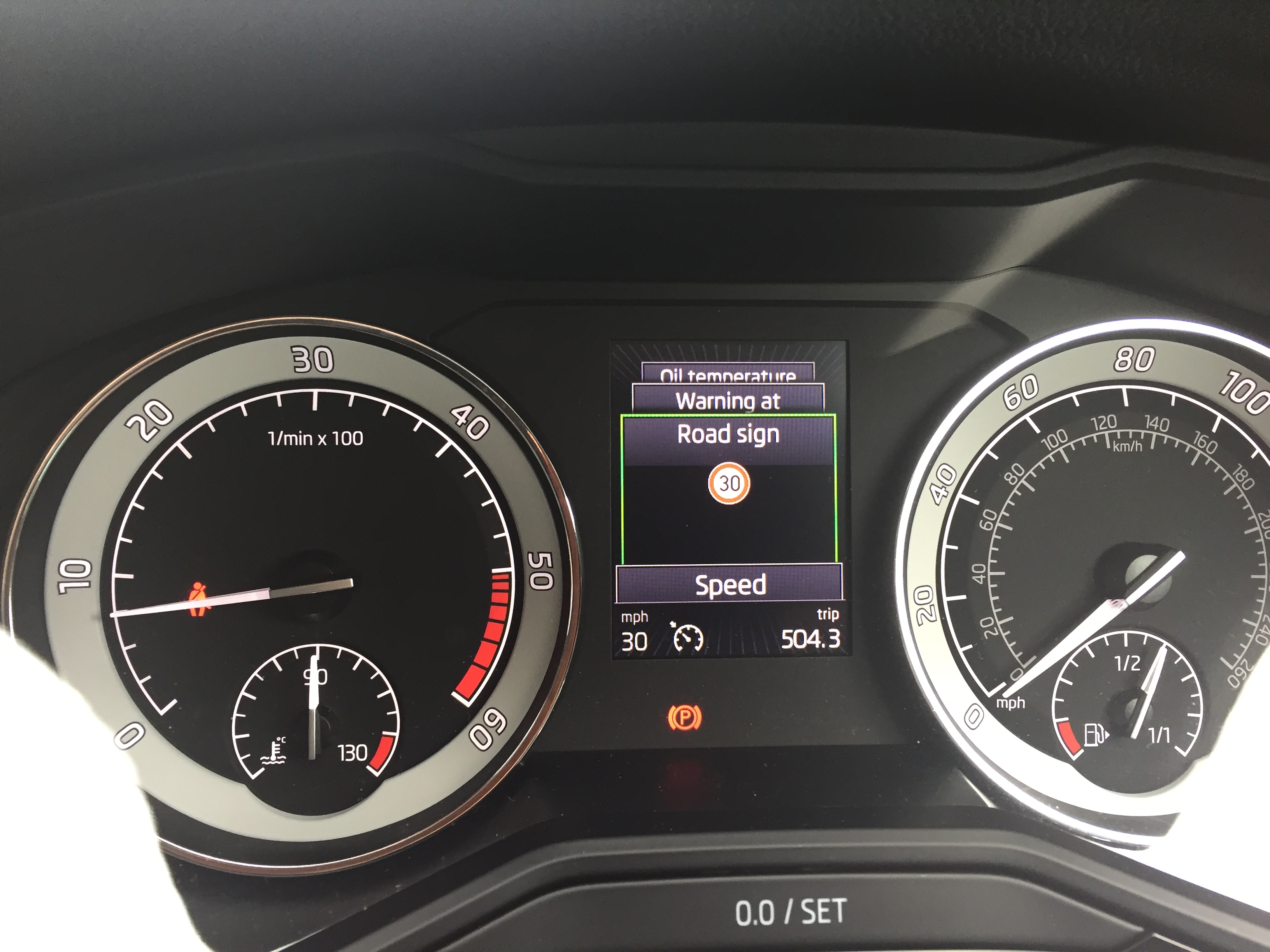

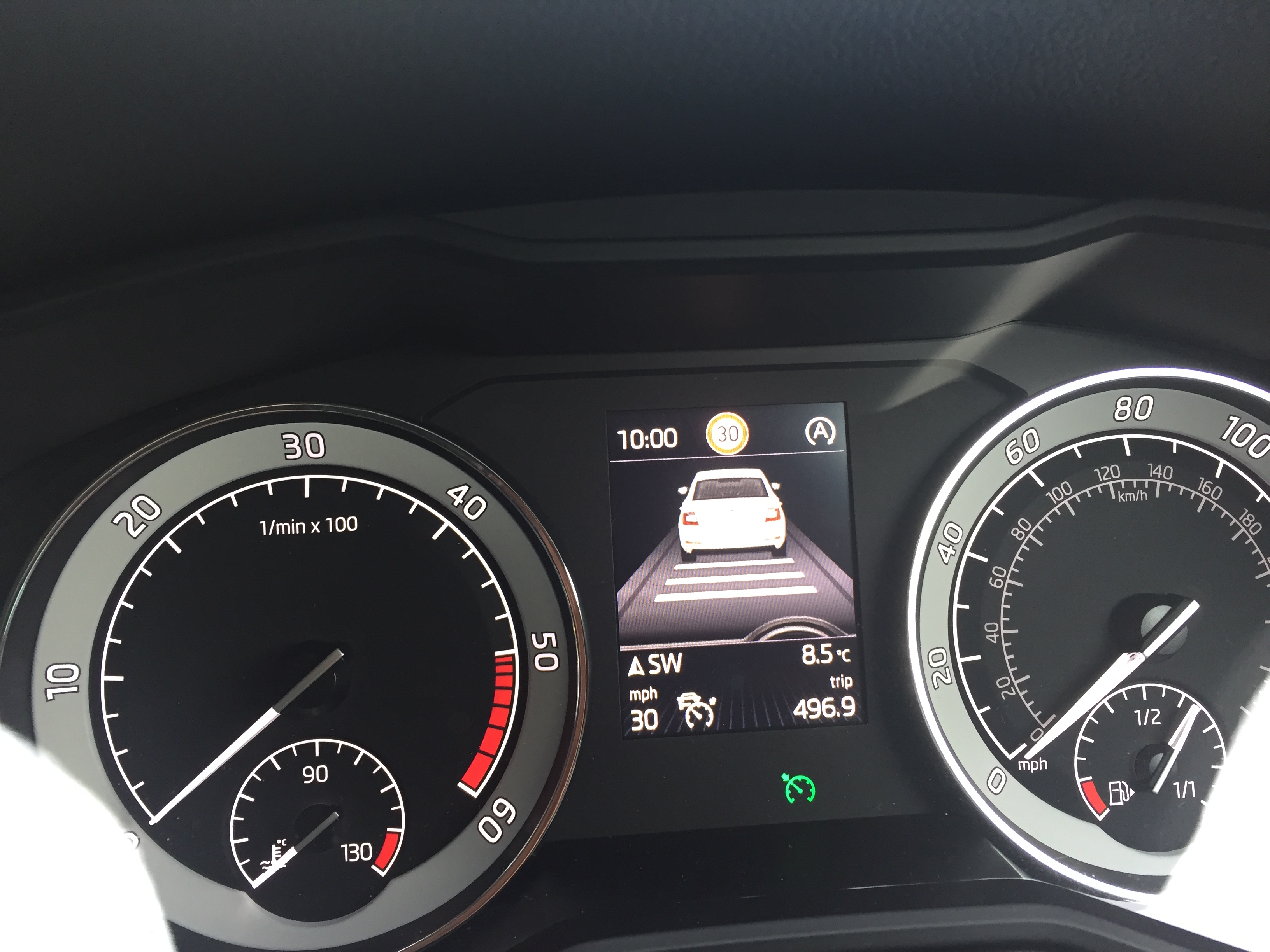

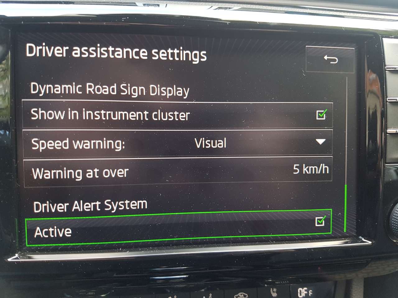

Finally got TSR working using Gizmo 68 instructions with a few changes.
Forget the coding changes on Byte 1 in A5 there is no option anyway.
The only other change is in
Controller 5F (Information Electr.)
07 - Coding
instructions state
Byte 24 Bit 6 - untick Traffic Sign Display (VZA) active
leave this TICKED
rebooted Columbus though not sure it's required and it seams to be working ok.
Went for for a quick drive around the village. Alarm comes on at pre defined setting. No pics as not safe while driving.

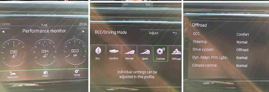

Managed to enable the following
Enabled Traffic Sign recognition.
Enabled high beam assist.Works great
Enable refuel quantity in the Maxidot.
Enabled Driving mode in Maxidot
Enable rear lights with DRL’s.
Enable DRL's in Menu.
Changed Ambient lighting from warm white to red. Looks great.
Changed throttle response to Audi. didn't notice any difference so switched back
