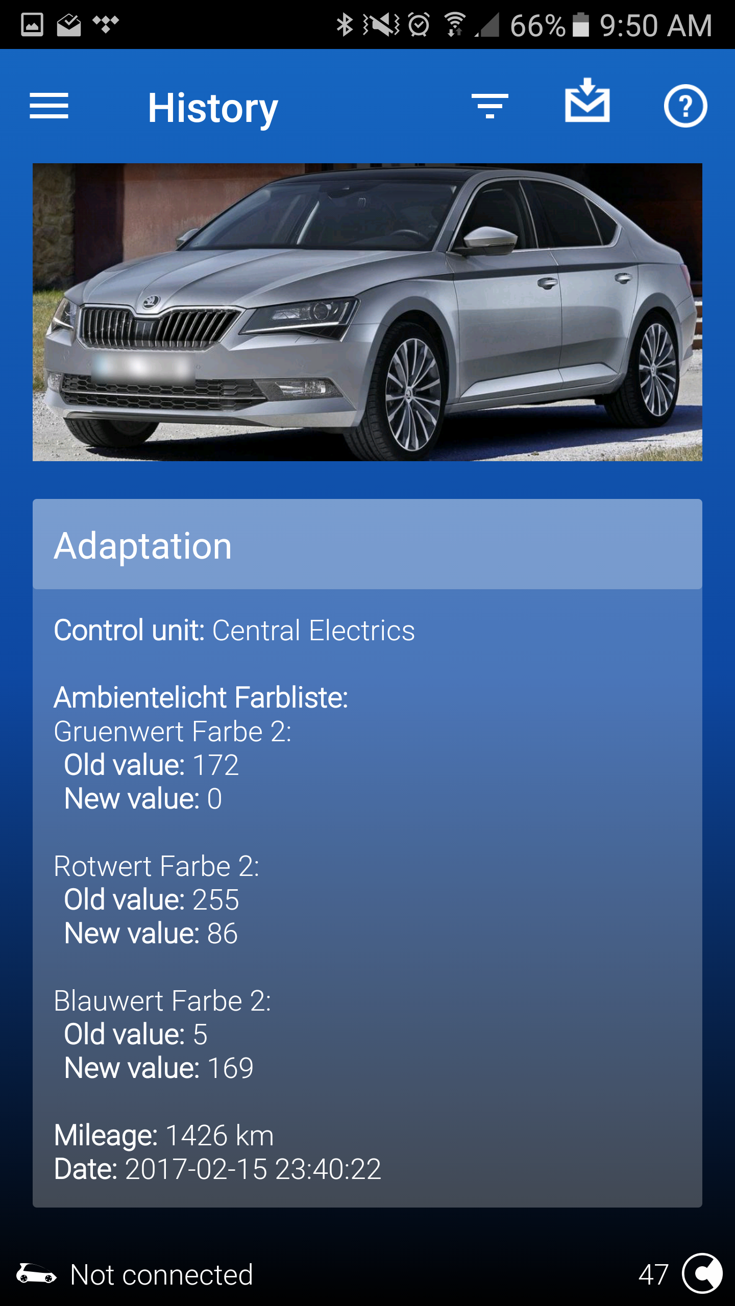

I've followed the instructions to change the internal led colours but have run into some issues! I have a MY17 S3, so have 10 colours available by default.
I changed the first colour to new RGB values, and the colour has changed in the menu selector but the led colour is not changing..
Am i missing something? I've reset the Columbus with no luck.

I'm using an obdeleven, here is a capture of the change I made.

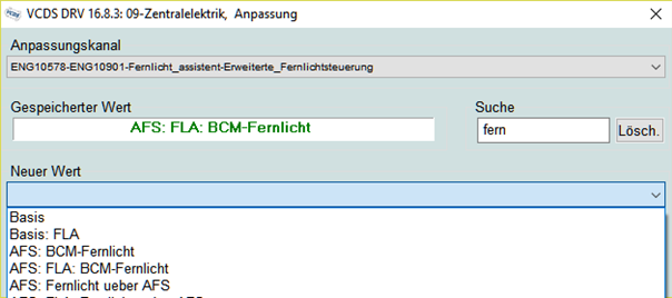

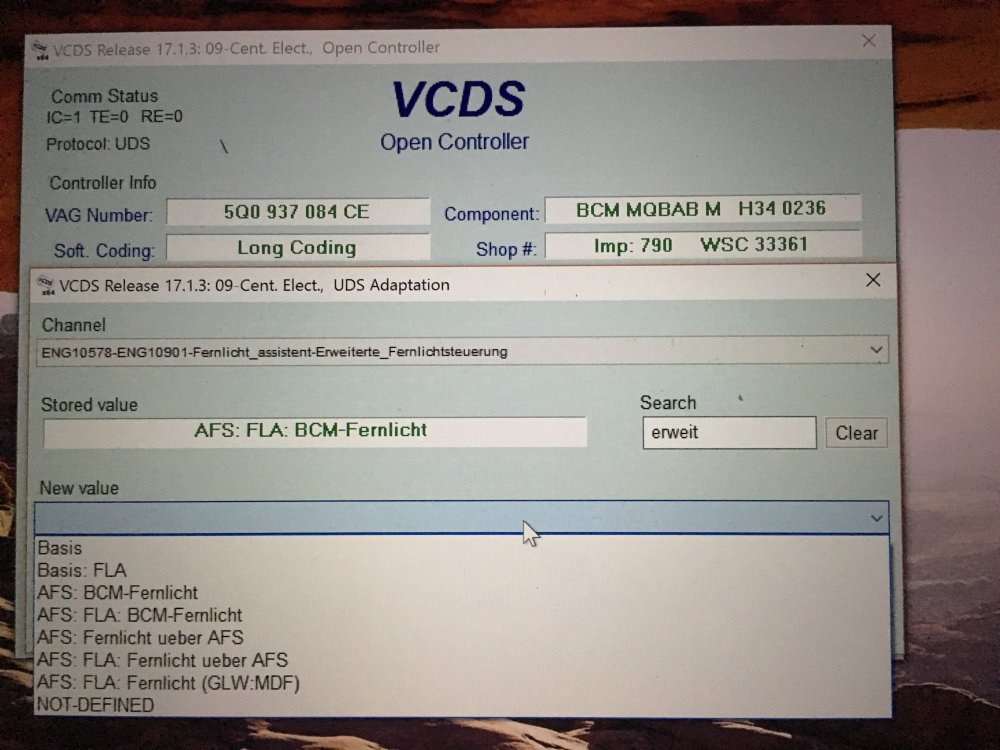

I seem to have the same issue as remix when looking at the module for coding light assist (auto high beam) - the long coding is just all zeros. (This is on a MY17 car using a Micro Can cable)
There is nothing bad. Just all MY2017 models have no codings, just adaptations.
Ah ok, thanks - that's good to know. So if I want to code high beam assist (light assist?) and lane assist on a MY17 (with halogens and sign recognition factory fitted), using a micro can cable, how would I go about doing that please? (I've some previous experience of VCDS but it was a while a go now!)

you can read there, the light assist can be enabled in MY2017 as following:
STG 09
Zugriffsberechtigung: 31347
Anpassung
Fernlicht_assistent (vorher Assistenzlichtfunktionen)
Menuesteuerung Fernlichtassistent Werkseinstellung
auf "vorhanden" setzen
Erweiterte_Fernlichtsteuerung
auf "AFS: FLA: BCM-Fernlicht" setzen
STG A5
Codierung
Byte 21 Bit 5-7
Ändern auf (20) Fernlichtassistent/High Beam Assist
Für diese Codierung muss unbedingt die "große" Kamera verbaut sein. Die große Kamera ist bei folgenden Ausstattungen verbaut: Spurhalteassistent, Verkehrszeichenerkennung (VZE), Dynamischer Lichtassistent (DLA). Beim "einfachen" Fernlichtassistenten ist nur die "kleine" Kamera verbaut, welche sich nicht für die oben angegebenen Assistenten genutzt werden kann.

Thanks - I haven't tried light assist yet but have surprised myself and managed to get lane assist working fully! Have been for a trial run and works very well.
Edit to add have also done light assist (but not yet tested). Only.bit unsure of is the following - would this be one of the other options for halogen lights, or is it the same:
Edited by Mon55
Regarding high beam assist / light assist, has anyone been able to adjust the activation / deactivation speed thresholds? I've tried looking in A5 adaptations but can't see where it is?

So I think AFS refers to adaptive lighting (or active light assist) which, as my car had halogen headlights, it does not have. So, question is do I even need to do the final adaptation in stg 09, or do I need to do it but with a different option selected. Here's a screenshot I've found on the web (not my car). (I'll check mine again later).
Edited by Mon55
This is the full list of options in module 9 under the adaptations for Erweiterte_Fernlichtsteuerung for my car. Does anyone know which of these should be selected given I have the A5 lane assist camera, and want to activate automative high beam (FLA), BUT with halogen lights (ie. my lights obviously do not swivel which is what I understand AFS is).IMG_0673.JPG
Test them all, start with Basis:FLA.
Try adaptation of Address 09: Cent. Elect.
and search for :
It looks like the 10 R, 10 B and 10 G values
