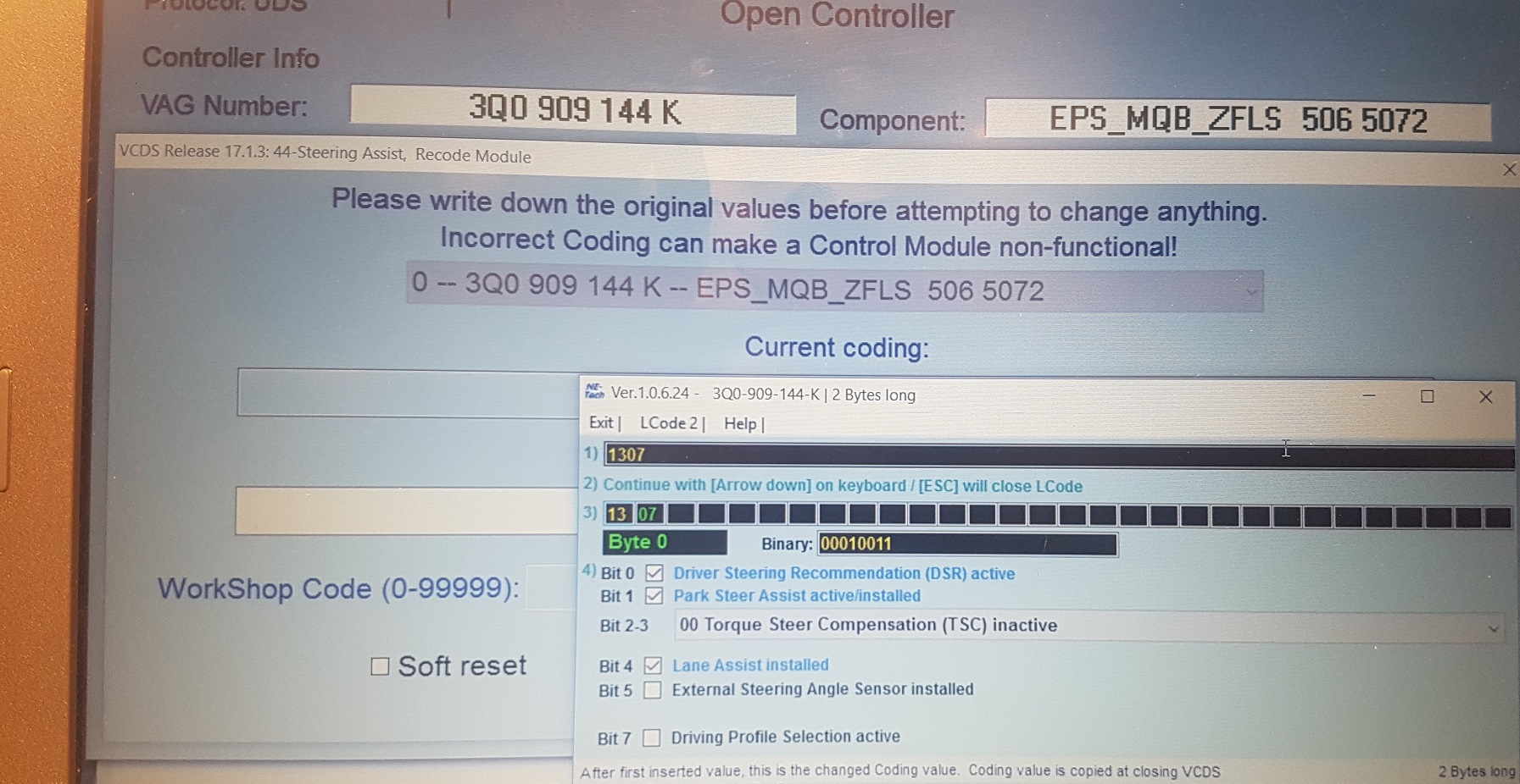

Is it possible to code a constant power feed to steering wheel while in the car? I've gotten so used to the mfst buttons and it annoys me when im sitting waiting for whoever and I go to change radio functions or volume but it wont work because ignition is off. First world problems I know....
Is there a Trailer Assist function available anywhere? If so is there any hardware that is required? Getting Factory fitted Tow Bar and Rear View Camera on a new L&K Estate.
I was last at the dealer to coding to brandnew S3 and both have the camera with TRS. I found out the A5 module is a little bit differend but stil got a option to activate LA. But after all the codings and deleting all fault codes lane assist won't work. It trows still an error in A5 communication error in both car. Because there was no S3 with lane assist availible i like to ask iff someone got a brandnew S3 with 44 module 3Q0 909 144K and still have lane assist. I like to have a full scan on the car and adaption logs from 44/17/09 and A5 to look where are the difference.
Just checked the last 3 MY17’s (1x SportLine & 2x L&K’s) I have coded and they all have this controller:
Part No SW: 5Q0 909 144 T    HW: 5Q0 909 144 R
   Component: EPS_MQB_ZFLS  128 1072
   Coding: 9307
My own MY16 L&K is:
ddress 44: Steering Assist (J500)       Labels: 5Q0-909-144.clb
   Part No SW: 5Q0 909 144 S    HW: 5Q0 909 144 R
   Component: EPS_MQB_ZFLS  125 1063
   Coding: 9303
As you can see all the UK (RHD) cars are all 5Q0
