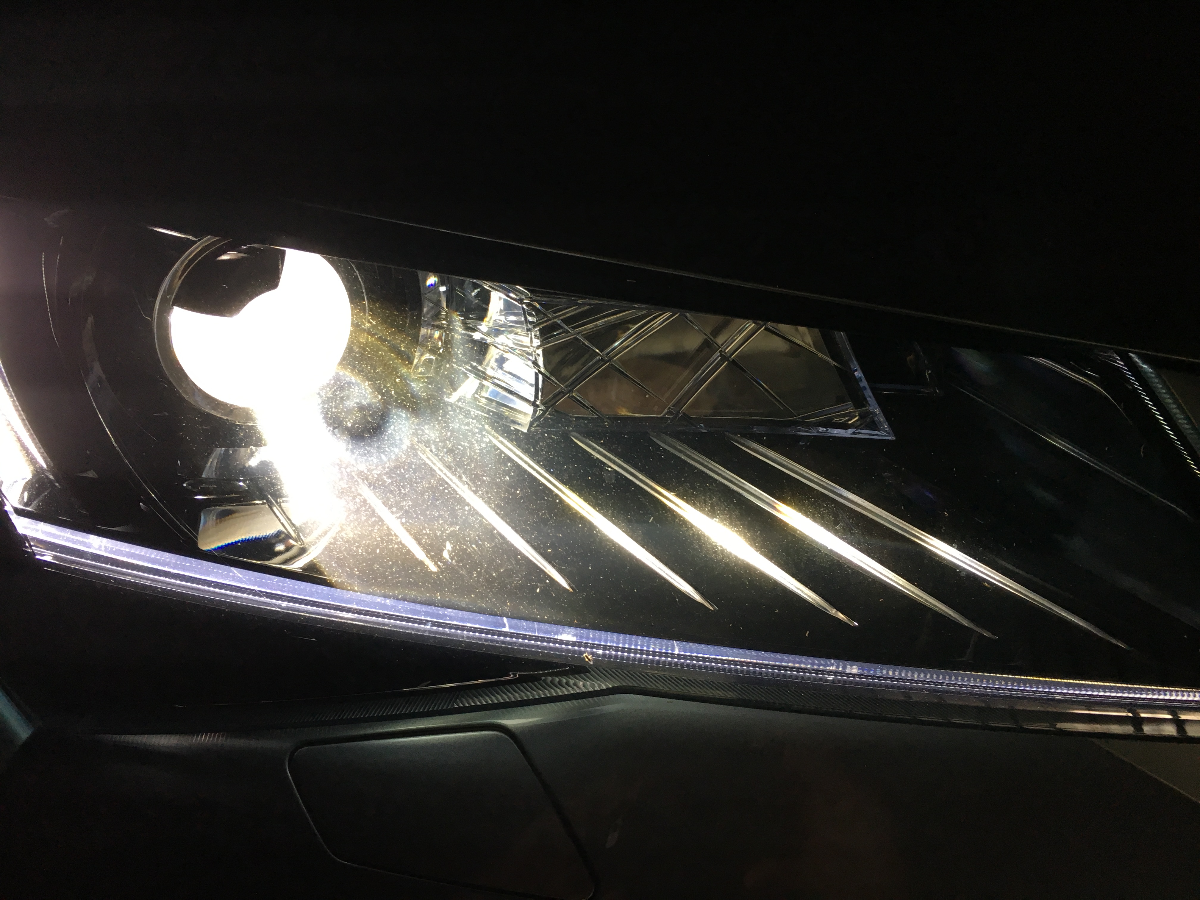

Does anyone have the coding for dynamic light assist? I think the headlights fitted to the Australian models are the ones needed for it but not sure if there is any other hardware required.
Does your car have xenon lights with lighted stripes inside?
They are listed on Skoda Australia's site as:
Bi-Xenon Lights with Adaptive Frontlight System incl. LED Daytime Running Lights
They have the lashes but they don't light up. They also do cornering and the little dance when you start up. Here's a pic of mine
Edited by IMSancho
According to my information only lights with stripes that light up are compatible with Smart Light Assist.
These headlights that your car has, cannot do Smart Light Assist only Light Assist can be coded.
Have a read thru this topic.
There are 2 different systems with different components. When I asked about retro fitting I was told possible but expensive as I would need new head units at £400 each plus other stuff.
If you dont have the additional LED strips then you have the standard AFS lighting system.
