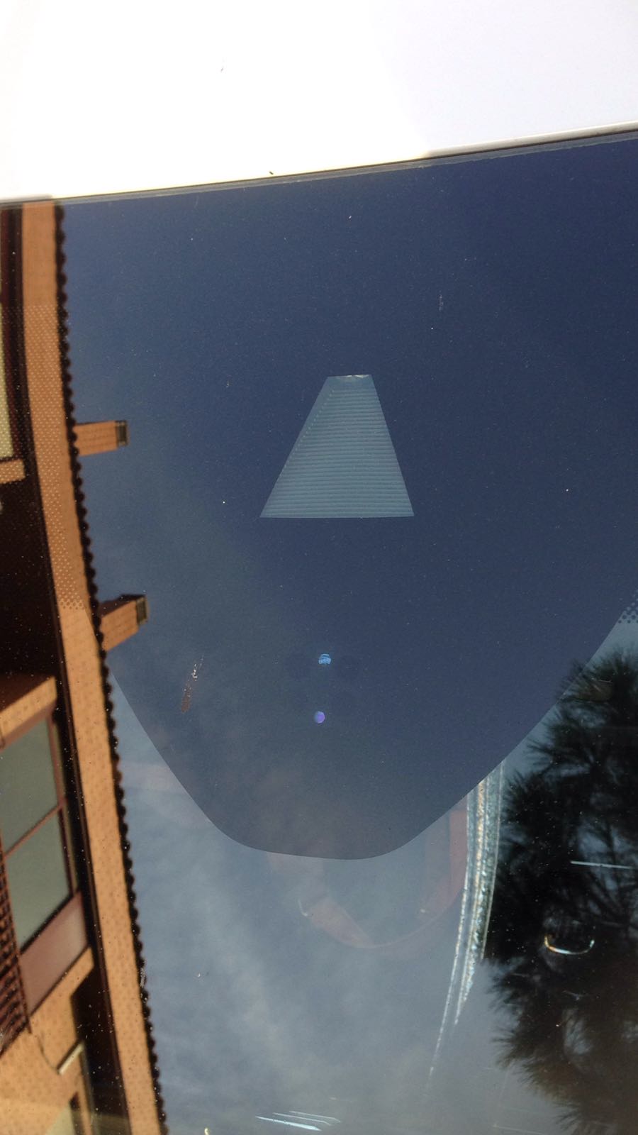

The car of series had high beam assist, how can I activate the lane assist with vcds? At the moment, I'm not interested in signal recognition
I show my windscreen with "big camera". With this if I can activate it, right?
Yes. That´s the A5 camera that gives you High Beam Assist, Lane Assist and Traffic Sign Recognition :)
