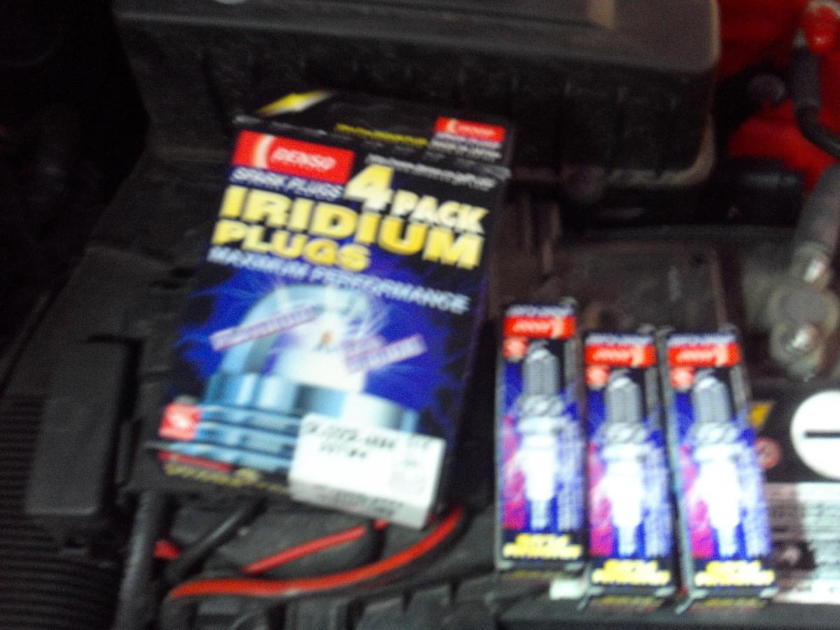

The Motor Factor had the latest DENSO Plugs in stock today but i stuck with the ones i trust & paid £60.65 for 4 just because i get everything else needed cheap from a trusted supplier.

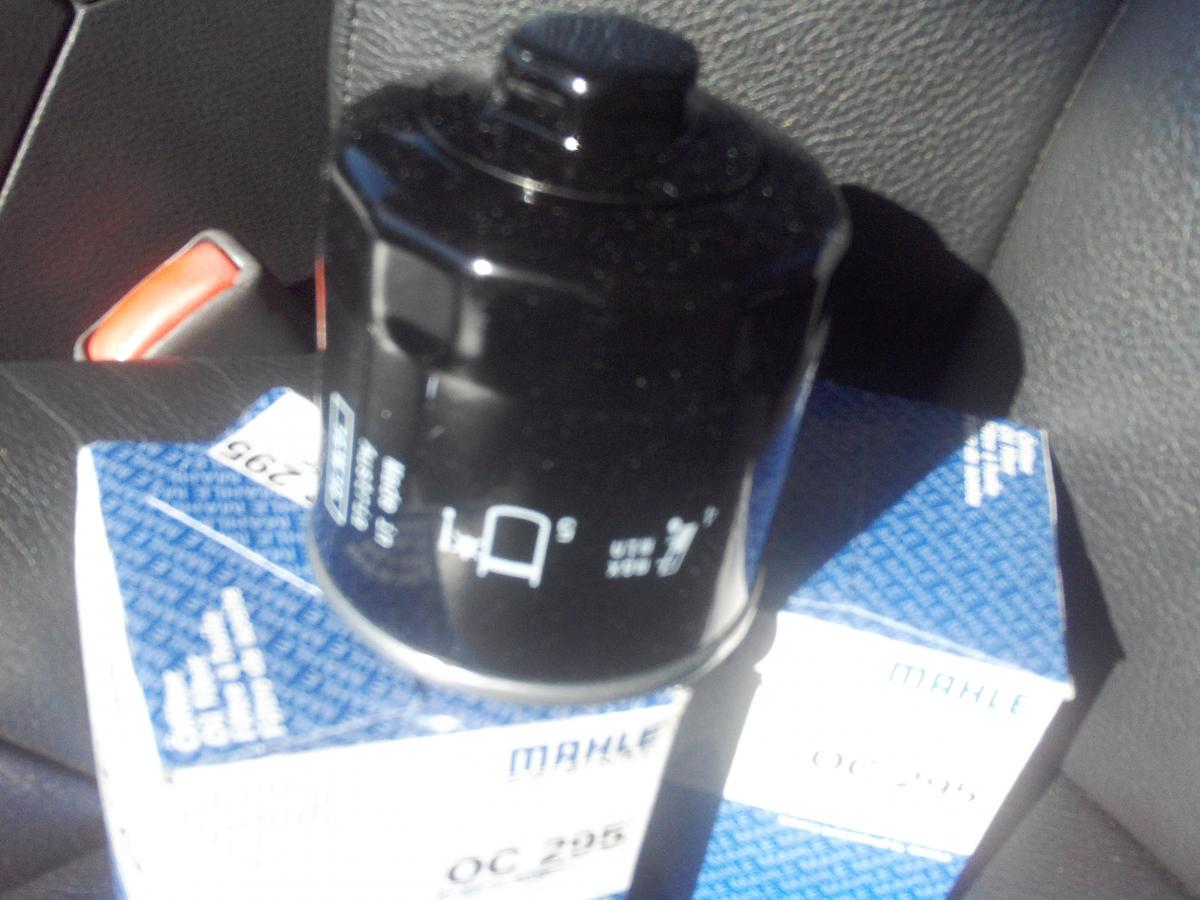

The Mahle Oil Filters are only £3.65 each and in my opinion preferable to using the VW/Audi ones.
