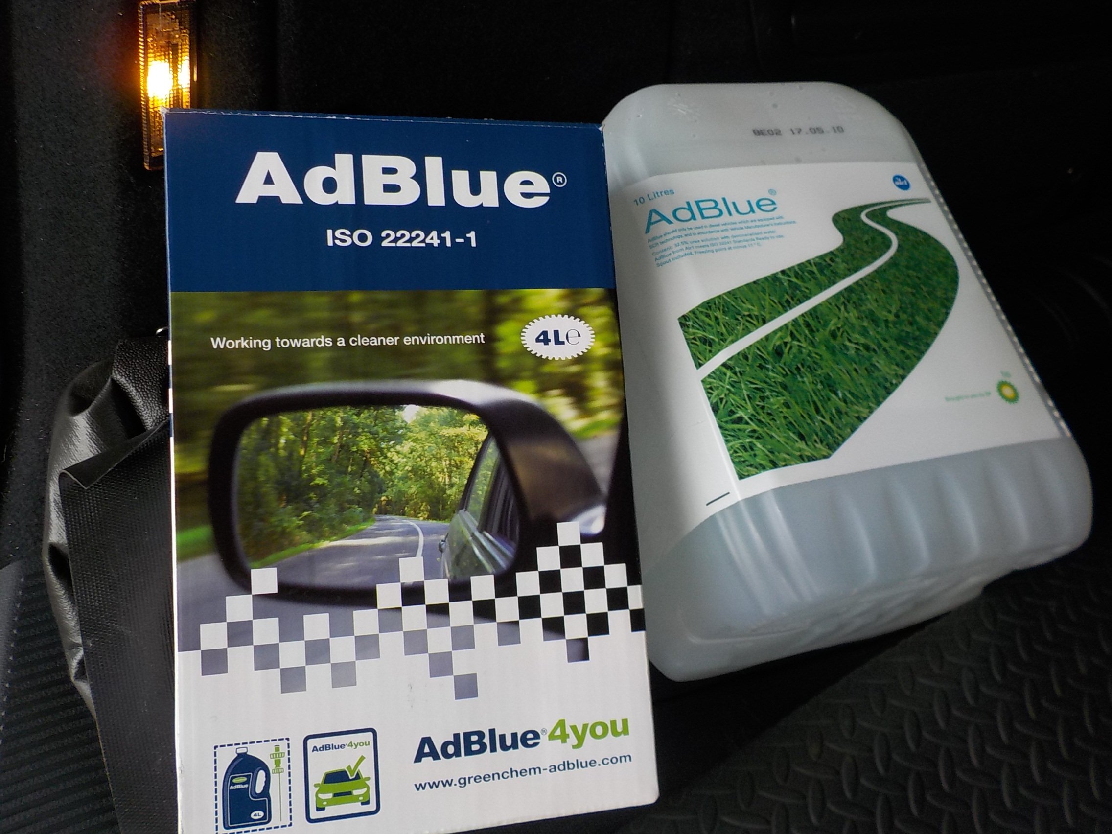

My 'new' Yeti Outdoor was bought with about 2,000 miles on the clock.  But within 500 miles the 1500 mile warning came up.  I bought a 10 litres drum as it came with a flexi spout but it still spilt some as I filled the tank.  So I have bought a small, battery-operated pump.  I've used these before to transfer diesel from a Jerry can and highly recommend them.  The pump will cut out automatically when the AdBlue tank is full.

I do quite a high mileage, so after doing some online research, instead of buying the expensive little bottles I bought the 10L drum from the local Skoda dealer when it was in for a service.  It was when I was at the service desk I asked for one, he said the parts department usually had them in stock, I then asked if they kept the filling hose to connect to it and the guy said there wasn't anything like that, you just bought a small bottle and decanted into that.  Went round to the parts dept and asked for the container and also asked for the filling hose and quoted the VAG part number (told you I'd done my research!), the parts guy said "Hmm.. we don't get much call for those, I'll have to check if we have one in.".  5 mins later I walked back into the service dept and showed the hose to the service guy.  Don't know how long he'd worked there, but he seemed genuinely surprised.
The hose is very handy, sit the adblue in the boot, attach hose to both container and filler, upend container and gravity fill until it automatically stops.  Set container down and unscrew from filler, being careful to avoid any drips whilst disconnecting by using a bit of kitchen roll, then unscrew from container and pack up until the next time.  With a bit of practice it doesn't take much longer than filling the screenwash.  I might get another vag 10L drum and then start filling them from the truck pump.

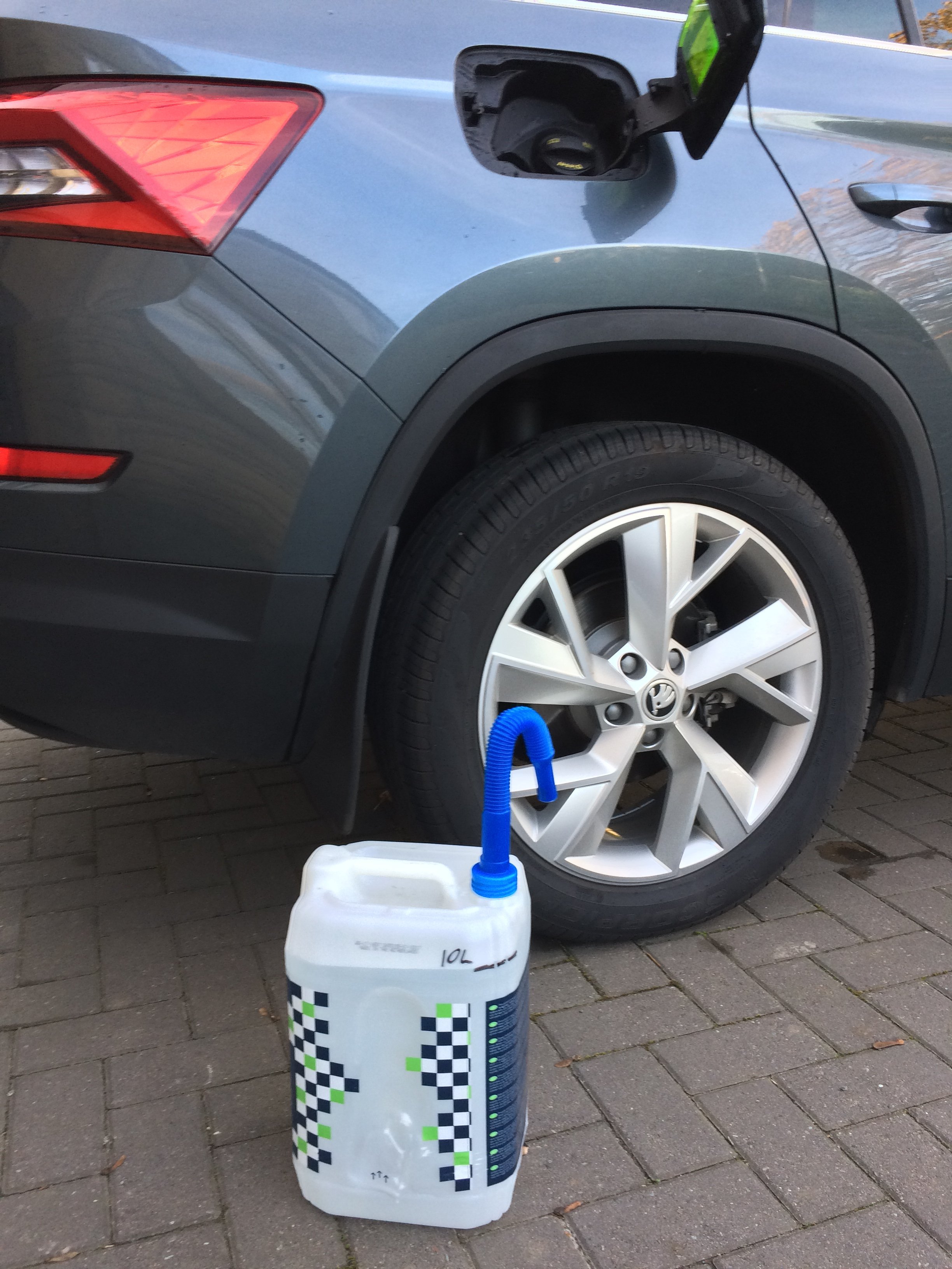

What is the part no, and the tank part no, and can you recall the costs
Thanks
Don't recall exactly, but I think about 7 quid for the hose and about 11 quid or so for the 10L drum I think.
Hose part no is 000-012-499
10L Drum is G-052-910-A4
5L container is also available, no idea of the part number though.  Since 5L wouldn't completely fill the tank even once, and would be the same effort to connect, fill, and disconnect as running to near empty and then brimming it from the 10L tank, I wasn't interested in messing about just getting 5L containers, sorry.  Depends on your mileage and the type of driving you're doing though, one 5L pack might do you a year.  The person who previously owned my Yeti only did 7k in three years!

I suppose I should clarify that I chose the VAG hose and drum because of the auto shut-off once the max fill level is reached.  The Yeti has the filler in the boot and I wanted a solution that wouldn't have the corrosive adblue spilling everywhere over the carpet etc.  If I'd had an external filler I'd probably have gone for one of the generic cheapo drums and spouts and listened for the gurgle as it got near to full.  I'd also read that if the Yeti tank is brimmed it confuses the adblue sensor in the tank and requires a trip to the dealer for draining and resetting on the computer diagnostics.  How true that is I don't know, but 7 quid for a VAG auto-stop hose is far cheaper than chancing it and ending up with an expensive trip to the skoda garage.
Regarding the question of would the VAG hose fit all drums, I couldn't say.  For the reason above above I wanted as drip free a solution as possible.  I figured the VAG drum would be the best fit with the VAG hose.  German engineering and all that.  I also didn't consider the drum I got from the parts dept to be stupidly priced, it seemed to be only a quid or so dearer than the generic stuff at the nearby Morrisons petrol station.  So I played safe and got the VAG drum.

I suppose I should clarify that I chose the VAG hose and drum because of the auto shut-off once the max fill level is reached.  The Yeti has the filler in the boot and I wanted a solution that wouldn't have the corrosive adblue (1) spilling everywhere over the carpet etc.  If I'd had an external filler I'd probably have gone for one of the generic cheapo drums and spouts and listened for the gurgle as it got near to full.  I'd also read that if the Yeti tank is brimmed it confuses the adblue sensor in the tank and requires a trip to the dealer for draining and resetting on the computer diagnostics.  (2) How true that is I don't know, but 7 quid for a VAG auto-stop hose is far cheaper than chancing it and ending up with an expensive trip to the skoda garage.
The £11 tesco adblue 10lt refill has a hose design which also stops running once the tank is full as well!
The only issue with this is that when the tipping the full container to get the hose ito the tank opening it can spill a little. Hence I intend to keep an old tank and half fill from a new one so that I can get the hose into the tank without any leakage.
